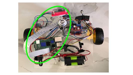

If you choose to make the robot into a mobile car:
  1. Ultrasonic Sensor
  2. Uninterrupted Power Supply(a mobile robot that is using resource-intensive CV requires more than one power source)
  3. Motor driver L298N
  4. 2 Wheel Drive Chassis(to support the car)(link)
  5. Optional: You can also design your own chassis like I did by drilling through an acrylic sheet and soldering wires but that requires more hardware skills.
  6. 9V battery pack
Optional: If you want to see whether the webcamera sensed your hand gesture while the robot is running "headless", connect a LED.

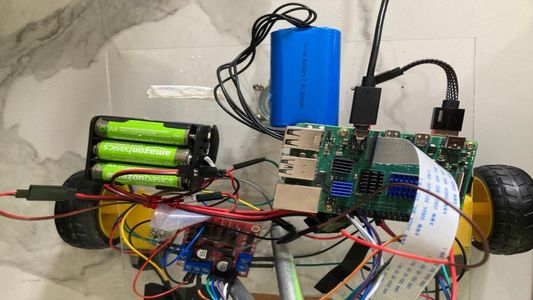

Step 1: Why We Are Using 2 Different Power Supplies
The robot uses both a Uninterrupted Power Supply and a motor driver L298N. The reason being is managing power consumption to run resource-intensive machine-learning models on RaspberryPi while keeping it mobile.
The UPS is powered by a lithium battery pack, and is a backup powerhouse for RaspberryPi.

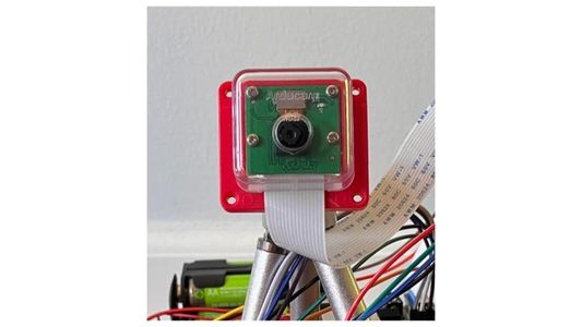

Step 3: Connect and Enable Picamera
On a RaspberryPi desktop: go to Main menu --> Preferences -> RaspberryPi Configuration -> Interfaces -> Camera -> select Enabled ->OK.
After this, reboot your Pi.
You can look for in depth instruction on how to set up PiCamera on Raspberry Pi's official instructions

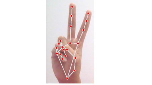

We are using the Hand_landmark model from Mediapipe which consists of 2 pre-trained modules: hand_landmark_detection model and palm detection model. What this does is it assigns coordinate points to 21 locations on our hand, respective to their location to one another.
We used these coordinate points(which are assigned as (x,y,z) points to create a Python array for the tips of the fingers. In our take of the code, we determine whether a finger is "up" or "down" based on whether the tip of the finger is "greater than" or above the other locations on the finger.
The z in the ordered pair is the landmark depth, with the origin of the depth being the wrist.

Step 6: Recognizing Hand Gestures
In order to recognize different hand gestures using computer vision, we used the values in the array above(with the tip values and mid values) to interpret the hand.
The algorithm compares the y coordinates of the these points. If the tip of the finger is higher than the lowest point, then the count for the tip is 1, else 0.
Then, in order to recognize a gesture, we created the if statements in the second image. This assigns a gesture(ie: "all up" means all fingers are raised), which we can then use to control the robotic car.

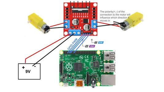

Step 10: Locomotion
In the diagram above, you can see how to connect 2 DC motors to raspberry pi, in order to make your robot mobile.
A big part of controlling the 2WD is using GPIO's Pulse with Modulation(PWM), which allows us to increase and decrease the power given to each motor without simply turning them "off" or "on".

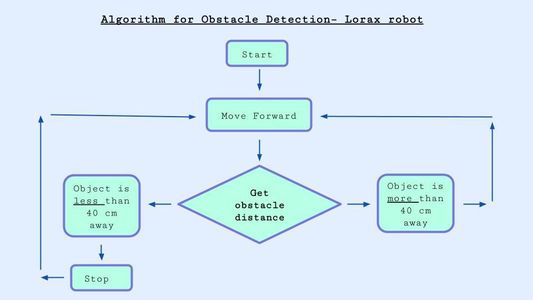

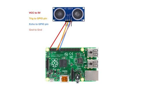

Step 11: Adding an Ultrasonic Sensor
The ultrasonic sensor is used to detect any walls or obstacles in front of it once it starts moving(to prevent any crashes).
You may change the logic of how/ what to do when an obstacle within a certain distance is sensed for your own purposes.

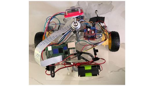

Step 12: Callibration
Now that all the components are assembled, its time to test the wheels! Test the code many times in order to optimize the hand recognition, distance from obstacles, and the direction the wheels are going in.
The wheels in particular, being that it is a DIY robot, will need to be calibrated in order to maximize how straight it can go.
