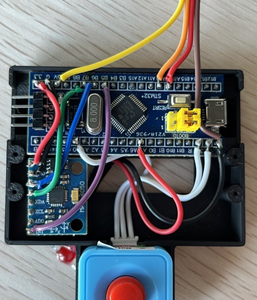

Step 4: Project Breakdown1 - Wiring
Connecting the STM32 with the MPU6050
Please strictly follow the wiring diagram below for connection.
(As shown in Figure 1 above)
You can use the 3D-printed parts I designed for fixing and soldering.
(As shown in Figure 2 above)

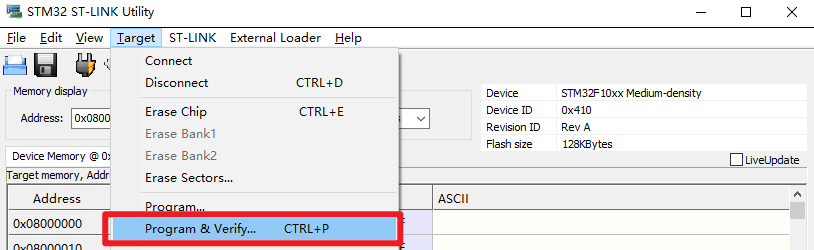

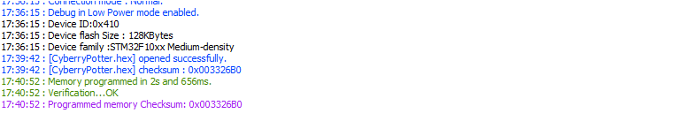

Step 5: Project Breakdown2 - Connecting the Programmer
Connect the STLink programmer and download the compiled hex file.
Wiring for the programmer:
ST-LINK Utility Software Download:
https://www.st.com.cn/zh/development-tools/stsw-link004.html#get-software

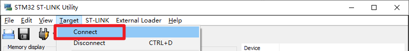

Usage:
Connect the main controller

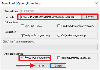

Select the programming file
(As shown in Figure 3 above)
Download the provided file "CyberryPotter.hex" and click "Start"
(As shown in Figure 4 above)
Prompt that the download is successful
(As shown in Figure 5 above)
After the download is complete, you can unplug the STLink programmer.

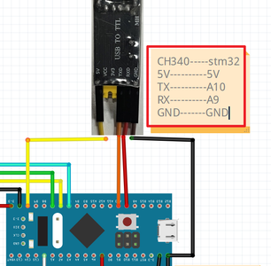

Wiring between CH340 and STM32:

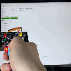

Physical Connection:

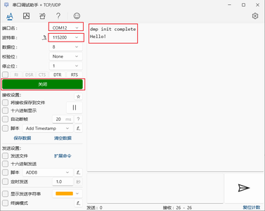

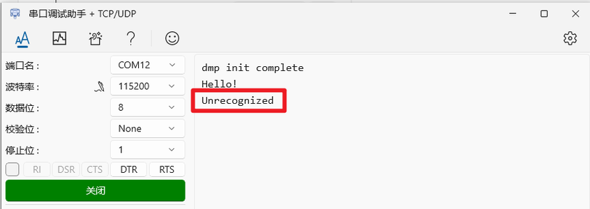

Connect using a serial tool:

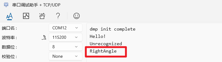

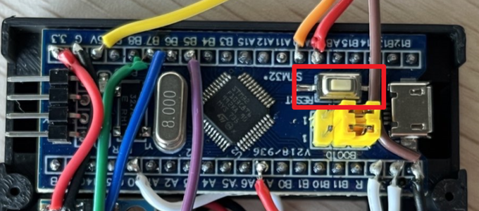

The baud rate is 115200. After opening the serial port, press the reset button on the STM32 board.
The window will receive
"dmp init complete
Hello!"
[!NOTE]
If the serial port does not receive any information, please check:
  1. Whether the program has been successfully downloaded
  2. Whether the serial wiring is correct
When you press the button without making any gestures, the window will receive "Unrecognized," which indicates that your board is working properly. At this point, when you perform the corresponding gestures, it will return the corresponding results.

For example, perform a →↓ motion. Press the button (just tap it, do not hold it down), and complete the motion within 1.5 seconds.
The serial port will return the result, which also indicates that your MPU6050 and the trained model are working properly.
(As shown in Figure 6 above)

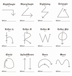

When the corresponding gesture is performed, the serial port will return the corresponding string. You can use another microcontroller to interface with the serial command, thus enabling various applications.
The gesture results are shown in the figure below:
(As shown in Figure 8 above)

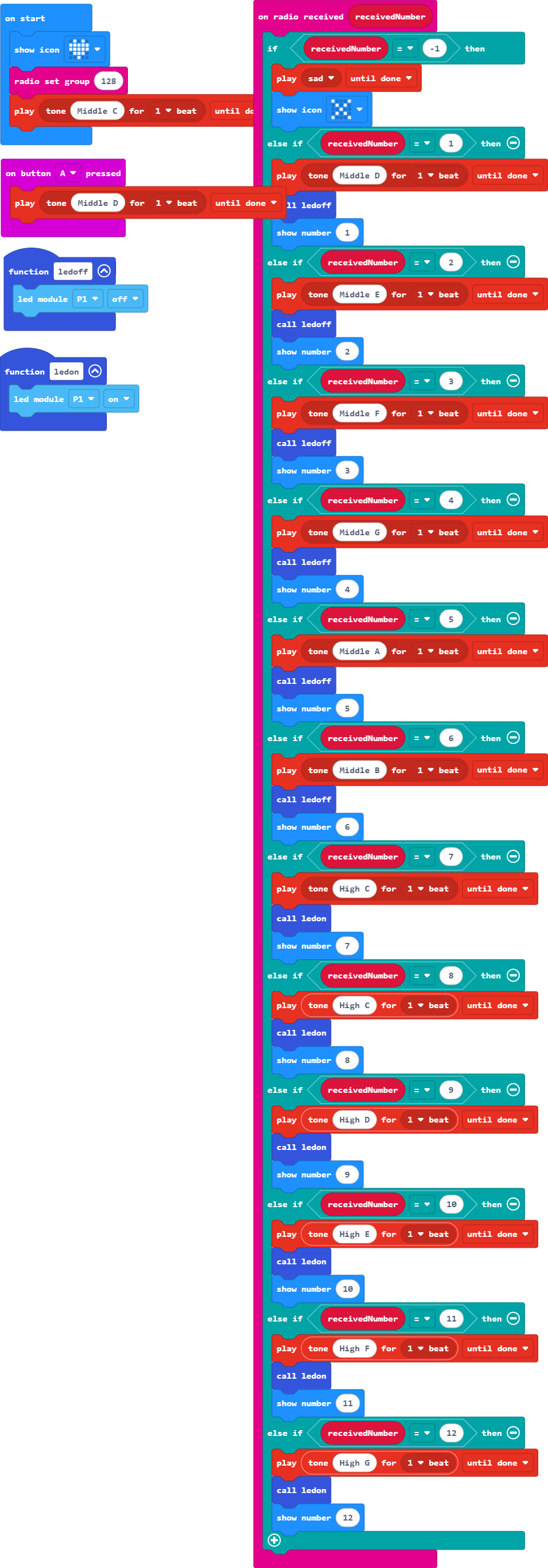

Receiver
Only one Microbit is needed, which is plugged into the Robotbit with an external cube LED strip module (P1).
Program address:
https://makecode.microbit.org/_WvyiVaMzuPze
Physical Testing
When gestures 1-6 are triggered, the LED strip turns off.
When gestures 7-12 are triggered, the LED strip lights up.

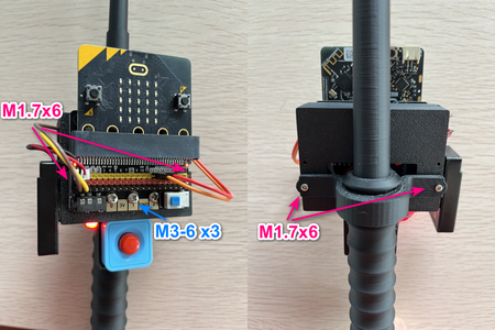

Assemble the AI Wand, paying attention to the installation positions of the screws. Use double-sided tape to attach the lithium battery pack to the side of the casing.
Assembly Complete
