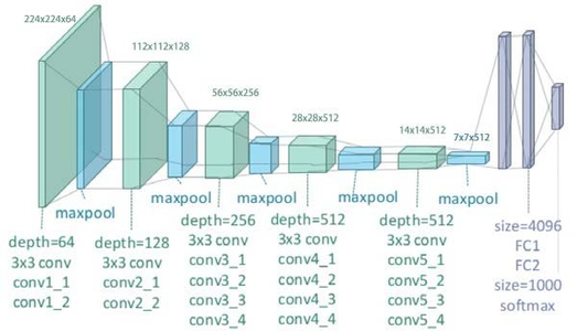

VGG19 pre-trained model is used and fed into our input tensor to the model. This will allow us to extract the feature maps (and subsequently the base and style representations) of the base, style, and generated images. In order to access the intermediate layers corresponding to our style and base feature maps, corresponding outputs by using the Keras Functional API to define our model with the desired output activations.
