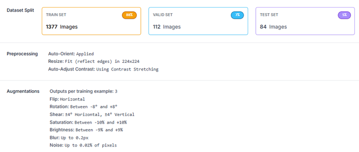

Step 4: Training the Model
Now, let’s train the brains behind the model with not one, but two powerful models! I developed a detection model using YOLOv8n, a lightweight version ideal for the Raspberry Pi’s limited resources, to improve prediction accuracy by identifying paintings first. For classification, I expanded the dataset with more webcam-captured and manually cropped images to simulate bounding box outputs. After numerous training runs, I experimented with augmentations (e.g., rotation, blur) and model versions. ResNet-34 proved too heavy for the Pi, so I switched to ResNet-18, striking the perfect balance of performance and efficiency. This dual-model setup is the heart of the project—stay tuned to see it in action!

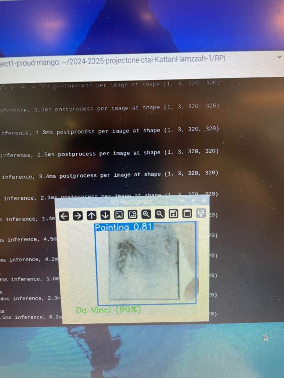

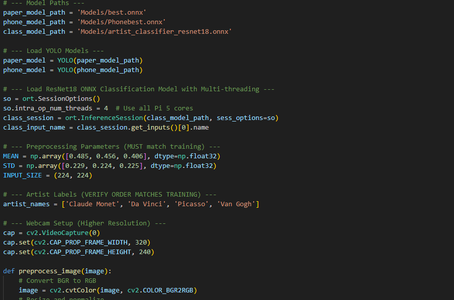

Bring your project to life with code that ties it all together! Using Python, I loaded the YOLOv8n detection model and ResNet-18 classification model in ONNX format, setting up the webcam at 320x240 or any other resolution. The system detects paintings frame by frame, then classifies them, displaying results on the LCD and video feed. There’s a small delay or lag—reasonable given the dual-model processing—but I tried skipping 2-3 frames with little difference. This step showcases the magic of real-time art recognition—let’s optimize it next!
Step 6: Visualization and Dashboard
Make your results pop with stunning visualization! OpenCV overlays bounding boxes and artist names with confidence percentages on the live video feed, creating an engaging display. I used a VNC connection to set up a basic dashboard on my laptop, letting me monitor detections remotely. This visual feedback turns the project into an interactive tool—perfect for presentations or personal use!
