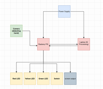

Before diving into the details of the build, let’s take a quick look at how the whole system works together. The diagram below shows the complete flow of data and hardware interactions.
Here’s a step-by-step breakdown:
  1. Camera (detecting hand)
  2. A USB webcam connected to the Raspberry Pi captures the hand in real time. The image is processed using MediaPipe, which extracts 21 keypoints representing the hand pose.
  3. Raspberry Pi 5
  4. Acts as the central hub. It:
  5. Collects the keypoints from the camera
  6. Sends them to the laptop over a socket connection
  7. Receives back the predicted ASL letter
  8. Controls the LED indicators, push button, and display output
  9. Laptop (AI Processing)
  10. The laptop runs the trained MLP classification model. It:
  11. Accepts hand keypoints from the Pi
  12. Classifies them into a corresponding ASL letter (A–Z)
  13. Sends the prediction back to the Pi
  14. RGB LEDs
  15. Red LED → idle state
  16. Yellow LED → countdown/processing
  17. Green LED → prediction confirmed
  18. Push Button (Switch)
  19. Lets the user confirm a prediction or reset the process for the next letter.
  20. Touchscreen (Screen Output)
  21. Displays the live camera feed, system feedback (e.g., “Too Close”, “Letter: A”), and the sequence of predicted letters.
  22. Power Supply
  23. Powers both the Raspberry Pi and the laptop, ensuring a stable, continuous system runtime.

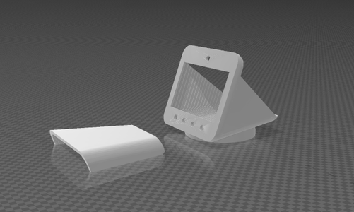

Step 7: Case
To make the project stable, compact, and visually appealing, I designed and 3D printed a custom case that holds all key components: the Raspberry Pi, 7-inch touchscreen, USB camera, RGB LEDs, and a push button.
The case was created in a 3D modeling program, with careful measurements to ensure a perfect fit. I included 12 mm holes in the front panel for mounting the LEDs, button, and webcam module, so that everything could be easily installed and accessible. The rear part of the case has space and cutouts for the Raspberry Pi, allowing full access to ports and proper cable routing.
I printed the case using a dual-color filament in a blue and pink gradient, simply because I liked the aesthetic and wanted the device to reflect my personal style. Of course, the case can be printed in any color or material to match different preferences.
The final result is a solid, ergonomic design that neatly houses all electronics in one clean and portable unit.
