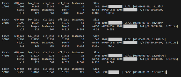

Training the YOLOv8 Model: With data in hand, I trained a YOLOv8 model on this dataset. I used the Ultralytics YOLOv8 repository – it provides a convenient way to train on custom data. I chose the YOLOv8m model variant, which is medium size and fast. Training was done on my PC with a decent GPU (training on the Pi itself would be painfully slow). It took a couple of hours of training and tweaking hyperparameters (and a few retrains when I noticed confusion between similar items). For example, at first the model confused red apples and tomatoes – to fix that, I added more images and examples of those in different contexts. Also, I noticed camera quality matters: images from a low-res webcam can be grainy, so I included some intentionally lower-quality images and used data augmentation (like blur, noise) during training. This helped the model handle different image qualities better.
In the end, I got a pretty decent ingredient detector model. It can identify things like an apple vs a tomato in an image, even if multiple items are present. If you want to train your own model, follow Ultralytics’ guide on custom training – or you can skip the hard part and use ready model weights.
Training Summary: I trained YOLOv8n for about X epochs until it reached an acceptable accuracy on my validation set. Don’t worry if you’re not an AI expert – you can use my model as-is. But it’s good to know what’s under the hood: YOLOv8 will take an image and output a list of detected ingredient names with confidence scores and bounding boxes. That’s exactly the info our recipe app needs.
Testing the Model: After training, I tested the model on some test photos (ones it hadn’t seen). I was excited to see it correctly recognized multiple ingredients! For instance, in a photo of a banana and an apple on a table, it detected both. It’s not 100% perfect (few models are), but it’s pretty reliable for our needs.
