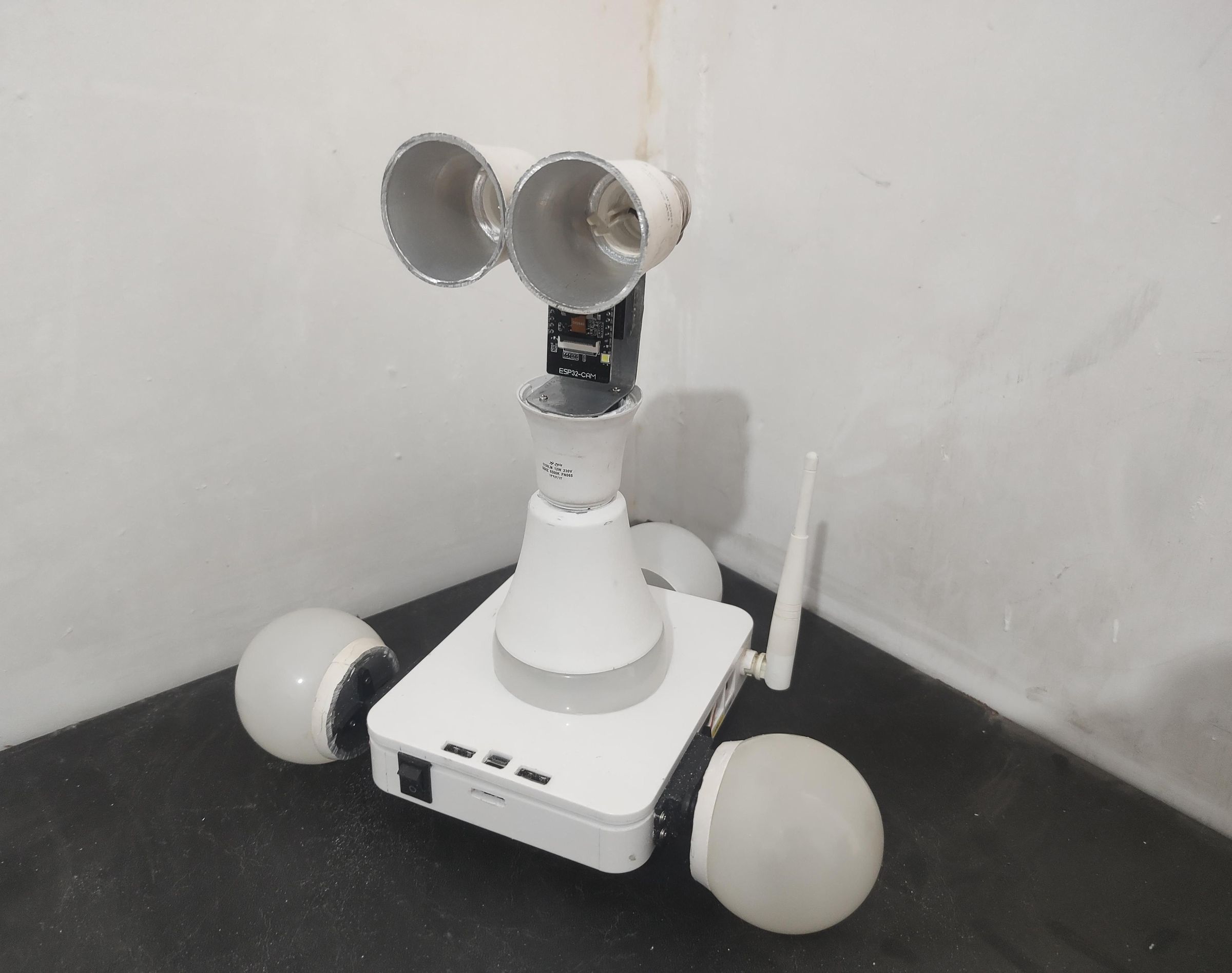

Introduction: AI Powered Robot Using ESP32 and Arduino
One day I was struggling with broken derailleur of my bicycle after an offroad crash and suddenly an idea came to my mind. The broken derailleur would make an awesome robot hand. So I gathered a bunch of broken bicycle parts and started the AIBOT project. The AIBOT uses an ESP32-CAM as its main controller and two arduino nanos for its voice and servo movements. Another ESP32 is used for AI interactions.
You can Interface with AIBOT through its application via wifi and of course it has live video streaming . The AIBOT has pre-defined scenarios and gestures like singing, dancing, introducing himself, telling jokes and some other cool stuff. it understands your pre-defined commands (if you talk Persian) and interacts with you vocally.
I made this before AI tech could see and talk (Its using Chatgpt 3.5) so the AI interactions might not be as cool as the new Versions of AI. And also Openai apis are unavailable in Iran so I couldn't work around that area very much but I tested everything and I can tell the codes and everything are working. At this stage you can only talk to AI and it cannot control the robot.
Note! If you are new to diy electronic projects you may want to start with something smaller like this one. This project contains android app development, C++ advanced coding with major complexities, super sensitive electronic parts and complex hardware design so it needs experience with tools and high level of diagnosis as it contains lots of wiring and high voltage interferences.
Tip: It's highly recommended that you read the entire article carefully before purchasing anything as it helps you purchase the parts with more awareness.
As the body parts are mainly scraps and old broken stuff you may not be able to find the exact parts but I try to list them anyway and if you couldn't find the exact parts just use your creativity.

Step 1: Chassis and Wheels
We start with servo motor holders. Grab some sheet metal and make holders for 360 degree servos as shown in the picture. As the entire body is a work of improvisation and didn't have any sketch or 3D model I don't mention all the specific measurements and also it's a very long tutorial and I assume you know your way around simple mechanics. Cut 14cm of your 85x9mm profile and install the servos on it as shown in the picture. Now drill two 4mm holes on the chassis by 10mm margin from its edge. I widened the holes so I can adjust the chain stiffness later. Now cut 17cm of the 12x10 U Profile and screw it on the chassis as shown in pics.
Front Wheels:
Front wheels are easy to install. We need two 25mm M4 screws and six M4x14mm washers. Put them together as shown. Now for the fun part cut the U profile to 5mm deep by 10mm margin from both ends and cut the nearest washer to the nut as shown. This way the washer holds the wheels firmly in position but don't tighten the screws too much as it locks the wheels.
Rear Wheels:
As the rear wheels are connected to servos we need two of servo head thingies cut down to their center and rounded reasonably good and put in the center of pulley wheels. If you do it well enough it gets pretty tight but some super glue will guarantee their bond. Once the glue is hardened they are ready to install. It's recommended that you screw the wheels to servo shaft. Servos come with their own shaft screws.
Chains:
Not much to explain here just measure the chains and put them together according to your design and dimensions. also that widened holes on chassis come in handy for adjusting chains. But don't tighten them too much as it puts pressure on servos.

Step 7: Electronics
ESP32-CAM:
As I mentioned the ESP32-CAM is a very power sensitive module and even when I tried to connect the RGB lights to it, video streaming was very awful. So we don't use any of the ESP32-CAM GPIOs, the module only passes your commands to the main arduino controller through serial communication. Connect everything as shown in the schematics.
Main Arduino:
The main arduino is responsible for processing your commands and executing them. It controls all the servos and high voltage transformer. The main arduino is also a master for the secondary arduino. You can find the connections to each component in the schematics so there's no need for further explanation.
Secondary Arduino:
The secondary arduino is responsible for RGB lights and the robot's voice. It connects to SD card reader via SPI connection.
AI ESP32 NodeMCU:
The actual AI is not reached through the ESP32 NodeMCU. The ESP32 NodeMCU connects to your phone hotspot alongside ESP32-CAM and gets the answers from AI as text, then it converts the answer to audio using text-to-speech api. AI fully understands Persian language but unfortunately I couldn't find a text-to-speech library that supports Persian so I had to set English as default. Also the only way I could connect to AI was through VPN and using a VPN will terminate all local connections and we are using a local hotspot connection to connect to the robot. I hope Openai opens up its services for Iran so I can Improve this section. This hardware is fully capable of direct control through AI.
With all that said, I managed to test the codes and it works perfectly in a non-restricted regions.
