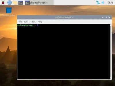

Enable Camera Support:
Once Raspberry Pi OS is running, open a terminal window and enter the following command to enable camera support:
sudo raspi-config
  1. In the configuration menu, navigate to Interface Options, then select Camera and enable it.
  2. Reboot your Raspberry Pi to apply the changes.
Test the Camera:
After rebooting, test the camera by running the following command in the terminal:
  1. This will capture a still image and save it as test.jpg in your current directory. If the camera is working, you should see the image saved.

Step 11: Executing the Surveillance System Code
In this step, we will deploy and run the AI-powered surveillance system software on our Raspberry Pi with the camera module. The program is designed to detect objects, track movement, and analyze video feeds for security purposes. Once the setup is complete, your system will begin monitoring the environment autonomously, processing video in real-time and storing results in a database.
Commands to clone code from github :
cd ~
mkdir SmartSurveillanceSystem
cd SmartSurveillanceSystem
git clone https://github.com/marwanazd/SmartSurveillanceSystem.git .
ls
Commands to run the script :
conda activate env
(env) cd SmartSurveillanceSystem
(env) python app.py
