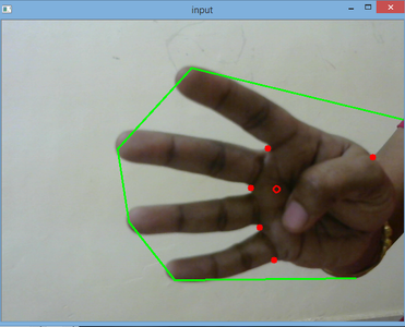

The HD camera recieves the input and a simple algorithm is used to find the number of fingers shown.The input frame is in RGB format which is Red,Green,Blue.It basically converts the input RGB video frame into YCrCbformat.Y is the luma and Cb and Cr are the blue,red chroma difference components.Each individual frame is processed and decoded.This process is repeated for the other successive frames. It is a way of encoding RGB information. The frame is now blurred by a Gaussian function.Next we find region with skin tone in YCrCb image. The method includes separating image data for each frame in the video signal into sets of data, averaging the image data in each data set to generate mean values for each color component in the data set, comparing the mean values to a stored color profile correlating to human skin tone, and identifying data sets falling within the stored color profile.

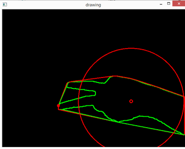

Finding the area by Contour tracing:
The contour is found after extracting the skin tone region. The boundary points of the contour is stored in the array. The contours is mostly used for object recognition. Contour tracing is one of many pre-processing techniques performed on digital images in order to extract the border of a particular image. Therefore, correct extraction of the contour will produce more accurate features which will increase the chances of correctly classifying a given object.All the contours present in the frame are stored from which the contour of the hand is extracted based on the area.The convex hull is drawn using the inbuilt function cv2. convexHull() function checks a curve for convexity defects and corrects it. Convex curves are the curves which are always bulged out, or at-least flat. And if it is bulged inside, it is called convexity defects. First we start from the leftmost point (or point with minimum x coordinate value) and we keep wrapping points in counter clockwise direction. The convex hull of the set is the smallest convex polygon that contains all the points of it.
Convexity Defects:
The red line(as in figure 3) bounding the hand is convex hull .Basically it’s a convex set.If we take any two points inside the red region and join them to form a line then the line entirely lies inside the set.ConvexityDefects is a feature that find the defects between a convex hull and a contour,those defects are useful to find features in a hand such as the number of fingers.The depth points are the space between the fingers.The defects() function returns the co-ordinates of the convex points and we draw lines joining these convex points. Two lines are drawn from the two convex points of the extreme fingers to outside of the image and there are n-1 lines joining n fingers. Hence the number of fingers shown is detected.
To differentiate showing the thumb which also indicates two convex points and indicates two, a circle is drawn with a radius in such a way that one convex point lies within the circle. Whereas, for the number two, both the convex points lie outside the circle. Hence, two is differentiated from the number six.The number shown is sent to another algorithm designed to play hand cricket.To avoid any discrepancies, the number is detected in 50 consecutive frames and the mode of these values is passed as the number to algorithm.
