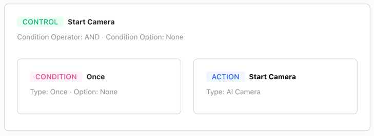

Step 4: Logic - Smart Security Camera
Control 1: Start Camera with AI Person Detection
Create a logic and add a control that starts camera and continuously monitors for people
  1. Condition (Once): Runs only once when project starts
  2. Action (AI Camera): Start camera with AI person detection- AI Analysis 1 (Object Detection): Detect if person exists

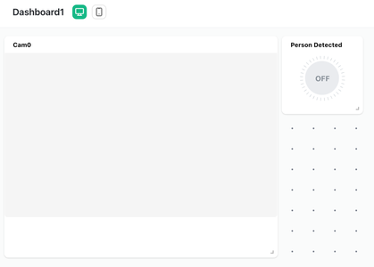

Step 7: Create Dashboard
Add widgets:
  1. Camera Widget: Live feed with AI detection overlay
  2. LED Widget: Person_Detected status
