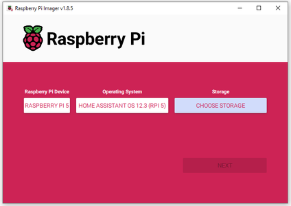

Step 1: Installing Home Assistant OS
Install the Raspberry Pi Imager (which can be found here)
Plug your SD card into your SD card reader
Open the Raspberry Pi Imager
Select the Raspberry Pi 5
Go to Specific-purpose OS > Home assistants and home automation > Homeassistant
Select your SD card
Burn the Home Assistant Operating System (HA OS) on your microSD card. (Note this might take some time.)

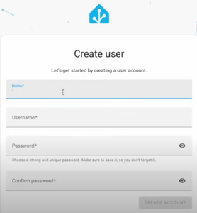

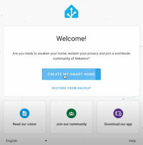

Step 3: Configuring Home Assistant and Creating a Home Assistant Account
After the waiting is done you'll be able to create a homeassistant account (requiring a username and password) to be able to log into your home assistant server in the future.
It's also recommended to configure your location and as well as the other things for a better experience.

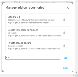

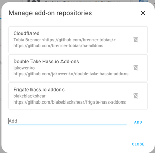

Step 5: Installing the Frigate Add-on
Go to settings > add-ons > add-on store > select the top left icon > Repositories
And add the URL of the following repository in it to access frigate: https://github.com/blakeblackshear/frigate-hass-addons
Then refresh the add-on store page, and you will see several Frigate versions you can install. Make sure to install the "Frigate (Full Access)", which is an NVR with real-time local object detection for IP cameras, designed for Home Assistant.

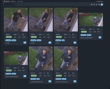

Step 9: Installing DeepStack and DoubleTake
If you wish to do face recognition as well, add the following GitHub repository in your add-ons: https://github.com/jakowenko/double-take-hassio-addons
Now install both Deepstack (the AI engine) and DoubleTake (the UI to train our face recognition model.)
Step 10: Configuring DoubleTake
Add the following to config file of double take:
mqtt:
 host: a0d7b954-emqx
 user: doubletake
 password: xxxxxx
frigate:
 url: http://192.168.xx.xx:8123/ccab4aaf_frigate-fa/ingress
detectors:
 deepstack:
  url: http://192.168.xx.xx:5001
  key:
Also don't forget to create a new user in EMQX called 'doubletake'. Note that you might need to try some different url's, IP addresses and ports, as these can be different, and might require some troubleshooting.
Step 11: Train the Model to Recognize Faces
If everything is set up correctly, when a person stands in front of the camera and Deepstack is able to detect there is a face, it will show up in the DoubleTake UI as unknown.
Now create a new class, for example naming it the person you would like to detect.
You can upload personal images of the individuals you would like to detect, but note that often your model won't be able to detect the faces of the person accurately, especially if the size of the face in the image is too small, or the images the model trained on are too different from the ones from the camera.
Luckily we can also train the model almost in real time on the footage from the camera itself. We do this by selecting the image, selecting which person it is, and then hitting train. And when that is done you can press the retry button at the bottom of the card and you can check if it is now able to detect that person.
If you which to have a robust model it's highly recommended to leave your camera on for at least a couple days and train it on as many different facial expressions as possible, under varying lighting conditions.
For example with your eyes open or closed, leaning forward or backwards, or with attributes like sunglasses.
It's recommended to train your model each day at the end of the day on the detections it got wrong. If you repeat this process for many days you should be left with a relatively strong and robust model.
This video does an excellent job of explaining how it works.

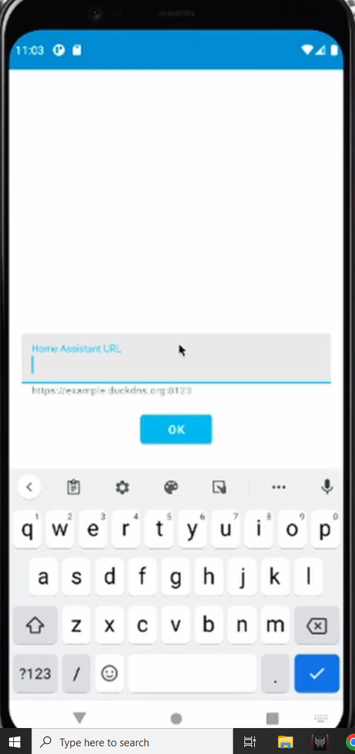

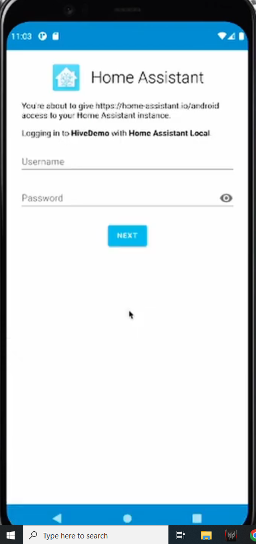

Step 12: Installing the Home Assistant App
If you wish to receive notifications on your smartphone you can download the Home Assistant app from the Google Play store.
Add the IP address of your Home Assistant server, or add your personal domain name if you have one. (Note we'll be discussing that last option in step 14.)

Install the Cloudflared add-on via this repository: https://github.com/brenner-tobias/ha-addons

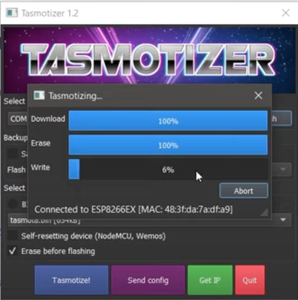

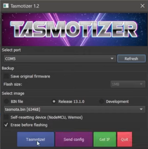

Install Tasmotizer on your computer. (GitHub link: https://github.com/tasmota/tasmotizer)
Install the required drivers (CH340 or equivalent). A tutorial can be found there: https://learn.sparkfun.com/tutorials/how-to-install-ch340-drivers/all)
Connect the NodeMCU v3 to your computer using a microUSB cable. (Note you will need one which also can send data back and forth, the ones that only can deliver power won't work.)

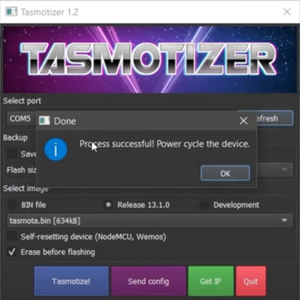

Flash the Tasmota firmware on the NodeMCU. Note that it could be that you will have to press the reset (RST) button followed by the FLASH button on the NodeMCU.
Step 17: Configuring the Tasmota Device

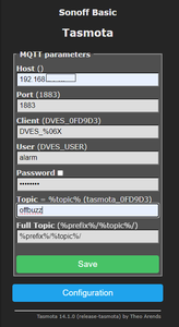

In order for us to trigger the alarm, we also need to configure MQTT on the device.
Fill in the IP of the Home Assistant server, and leave the default port unchanged.
As the user fill in "alarm". (Note you will also need to create a new user named "alarm" in EMQX as well.)
And as the topic fill in "offbuzz".
And fill in the password.
And hit save.
