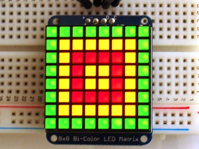

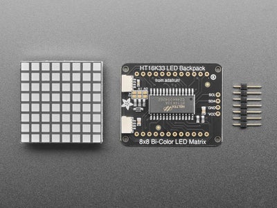

I'll assume you have an 8x8 LED matrix driven by an HT16K33A. Note Adafruit's BiColor LED Matrix has everything setup. You need four buttons pulled high. Meaning one side of each button is connected to ground, and the other side is connected to a GPIO pin and pulled up to Vin thru a 10k resistor.
Connections are simple. If you're using the business card version, just leave the expose the male pins for programming. If you have separate parts, the LED matrix's SDA and SCL pins connect to the ATtiny 1616 SDA SCL pins. The buttons connect to pins 0 through 3.
Simple diagram is in the pictures (note: it shows only one button and the HT16K33A driver should already be connected to the LEDs, leaving just the Vin, GND, SDA, and SCL pins to wire)
