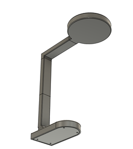

I designed the model in Fusion 360 and after some iterations, the model was perfect.
To begin, start by downloading the zip file attached. Then use a slicer such as Cura to print each model once.
I printed most of the parts with 10% infill and at a 0.28mm layer height in order to speed things up.
However, I would recommend printing the Arm.3mf model with around 40-50%+ infil and/or with 2+ walls in order to make sure it doesn't break under the weight of the LED housing!
Unfortunately, most of the parts will need supports, but I found that they were easy to remove and took less than 5 minutes to do so.

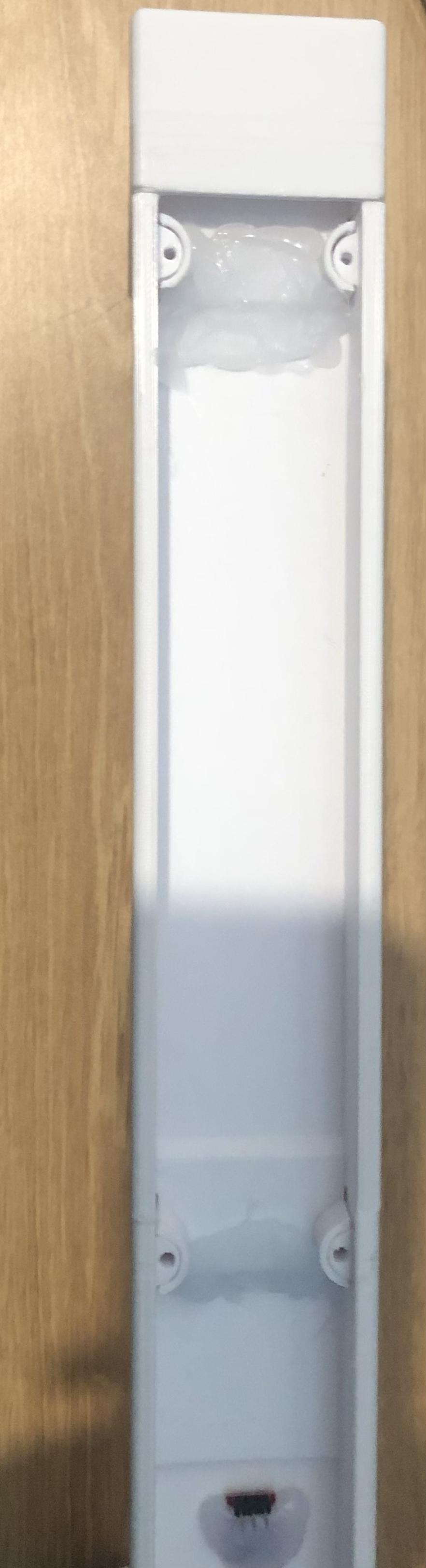

LED Strip - Using the provided M3 tape on the LED strip, glue it inside the LED housing.

Afterwards, attach the Arm to the Arm Extender and use LOTS of glue to secure and strengthen it in place.
Finally, attach the LED Housing and the Arm together, using glue to secure them in place.
