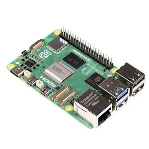

  1. Raspberry Pi 5

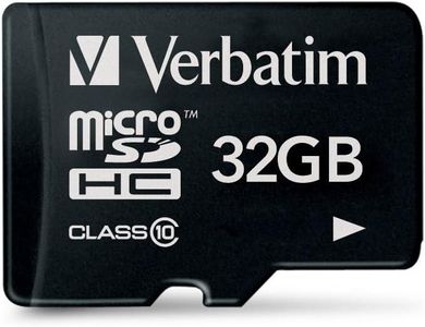

  2. MicroSD card (32 GB)

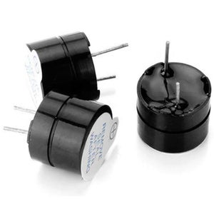

  6. OcioDual 3 x Buzzer 5V Active Buzzer

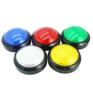

  7. 2x arcade buttons
