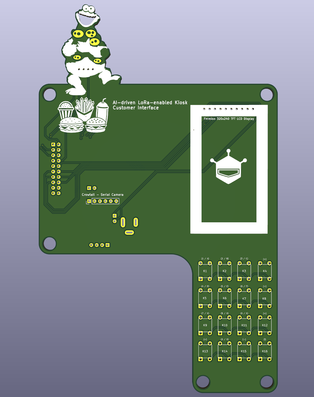

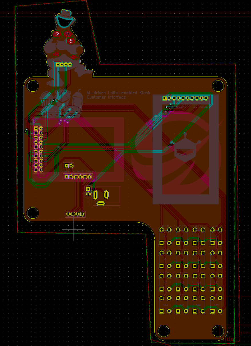

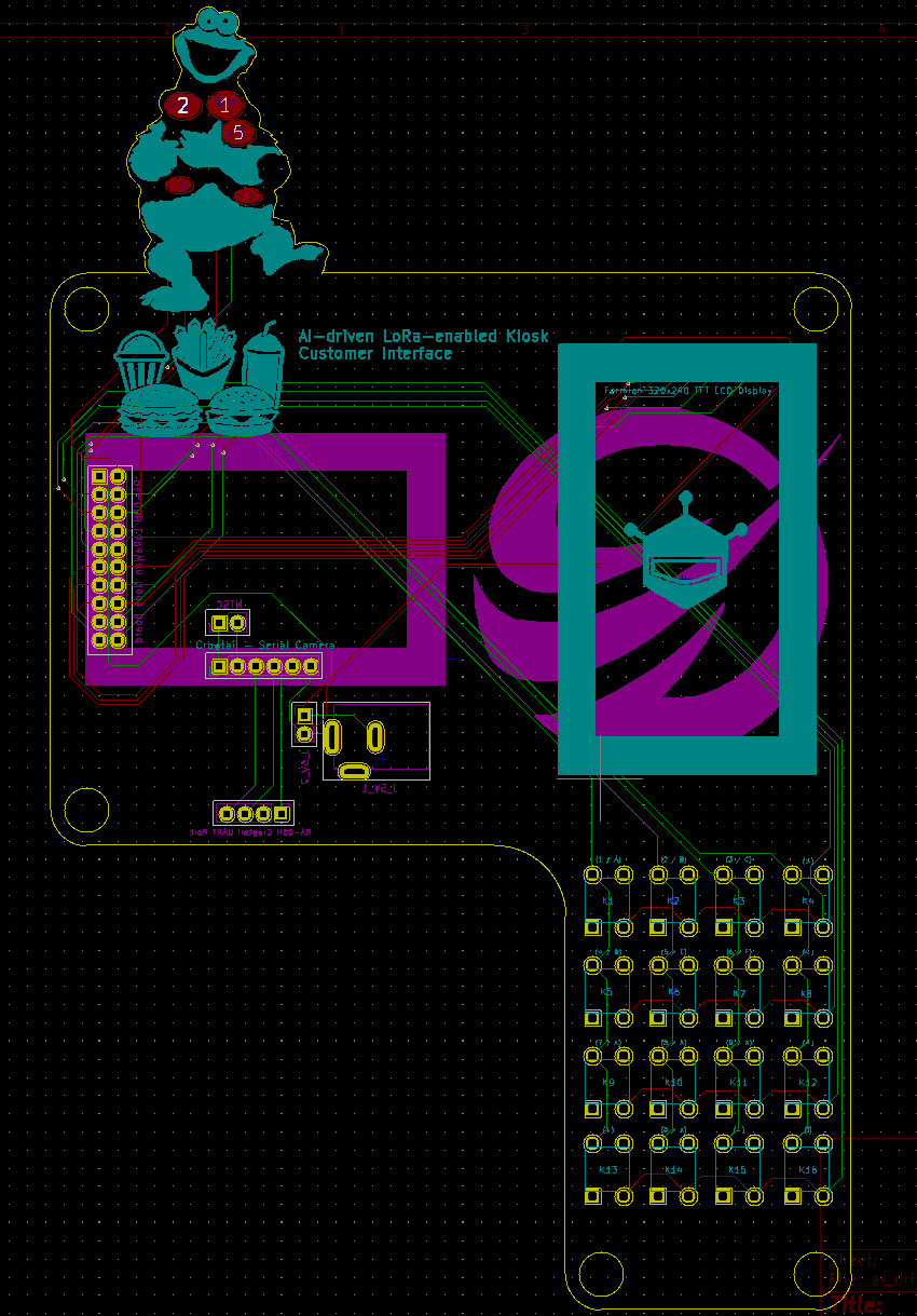

Step 26: Designing the Kiosk Customer Endpoint PCB Outline, Protective Case, and Layout
After ensuring the electrical components of the kiosk customer endpoint perform as expected, I started to work on the kiosk endpoint PCB layout. After developing a lot of PCBs for my proof-of-concept projects, I came to the conclusion that designing PCB outlines and structures (silkscreen, copper layers, etc.) directly on Autodesk Fusion 360 works best for my development process. Creating PCB digital twins allows me to simulate complex 3D mechanical systems compatible with the PCB part placement and outline before sending my PCB designs for manufacturing.
As I was designing this PCB, I wanted to add Cookie Monster as a part of the PCB outline since who could be more welcoming to a drive-through restaurant than this renowned Muppet :)
While designing the snug-fit PCB case, I noticed that the PCB size would be too large since I wanted to protrude the custom 4x4 keypad section. Thus, I decided to place some components on the back of the PCB, letting me design a compact and robust kiosk customer endpoint.
In this regard, I needed to leave some areas on the back of the PCB case open to place the associated electrical components. Thus, I decided to design special threaded bolts and nuts (3D-printable) to securely attach the kiosk customer endpoint PCB to its protective case.
After designing the PCB outline and structure, I imported my outline graphic to Kicad 8.0 in the DXF format and created the necessary circuit connections to complete the kiosk customer endpoint PCB layout.
Step 27: Soldering and Assembling the Kiosk Customer Endpoint PCB
After completing the kiosk customer endpoint PCB layout, I utilized ELECROW's high-quality regular PCB (Rigid) manufacturing service. For further inspection, I provided the fabrication files of this PCB on the project GitHub page. To replicate this device, you can order this PCB directly from my ELECROW community page.
#️⃣ After receiving my PCBs, I soldered electronic components and pin headers via my TS100 soldering iron to place all parts according to my PCB layout.
📌 Component assignments on the kiosk customer endpoint PCB:
RA_08H_Board_1 (Headers for RA-08H LoRaWan Node Board)
RA_08H_Port_1 (Headers for RA-08H Crowtail UART Port)
Crowtail_Cam_1 (Headers for Crowtail Serial Camera)
NTSC_1 (Headers for Crowtail - Serial Camera NTSC Pins)
Fermion_TFT_Display_1 (Headers for Fermion: 2.0" TFT LCD Display)
K1, K2, K3, K4, K5, K6, K7, K8, K9, K10, K11, K12, K13, K14, K15, K16 (6x6 Pushbutton)
D1 (5 mm Common Anode RGB LED)
J_5V_1 (DC Barrel Female Power Jack)
J_5V_2 (Headers for Power Supply)
Step 28: Prototyping the Food Delivery System Flex PCB and Testing Its Electronic Components
