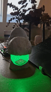

I designed an AI-powered educational toy that makes learning colors and shapes fun, screen-free, and truly interactive - and while it’s made for young children, adults can’t resist playing too! 🦖✨
The friendly dinosaur talks to the child, prompting them to find specific shapes or colors. When a piece is placed in its mouth, a built-in camera and AI model recognize it instantly, give real-time voice feedback, and light up an RGB LED. Correct pieces are “swallowed”, while incorrect ones are gently rejected. 🎤💡

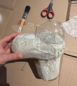

Step 2: Build the Head of the Toy Dinosaur
Now it’s time to build the head of the toy dinosaur. Doing this at an early stage is important because it allows you to collect training data in a controlled environment. By capturing images inside the toy’s mouth - with an LED installed - you ensure consistent lighting and background. This helps your AI model learn more accurately, and reduces the need for a large dataset or extensive image augmentation.
🛠️ Assembly Instructions:
- Carve a plastic bottle lengthwise to form the two parts of the mouth: the bottom and top jaws.
- Attach a plastic cup to the bottle to serve as the neck (see the photo). This will later connect the head to the body.
- Use additional bottle parts to shape the top and back of the head, giving it structure and volume.
- Use tape to hold the parts temporarily in place and test the alignment.
- Once you're satisfied with the shape, secure all parts with a hot glue gun.

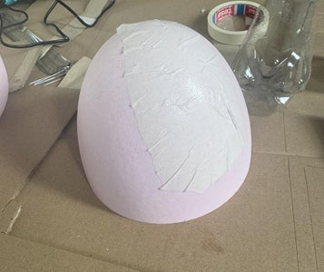

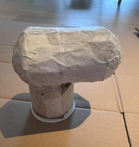

🎨 Papier-Mâché Covering:
- Start covering the plastic frame with papier-mâché using medium-sized strips of packaging paper.
- Mix 50% PVA glue and 50% water, and apply it to both sides of each strip using a brush.
- Apply the strips over the plastic and smooth them. You'll need about 5 layers if you want to remove the plastic base later.
- Let it dry completely.
👉Tip: Keep the plastic base for the bottom jaw - it’s smoother than paper and makes it easier for pieces to slide into the toy’s body.

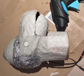

⚙️ Add the Mouth Mechanism:
- Position the bottom jaw inside the upper jaw and temporarily secure it with paper tape.
- Use your camera to test the view:
- Place a colorful playing piece inside the mouth.
- The camera should clearly see theentire surface of the bottom jaw. You can adjust the position of both the camera and the jaw to achieve the perfect view.
- Avoid angles where the camera sees past the jaw or inside the toy’s body.
- Once the view is correct, mark the hinge point positions on both sides.
- Remove the bottom jaw and:
- Create anopening in the plastic to insert the servo motor (I used a heated metal skewer to melt a hole).
- Glue the servo securely into this opening.
- Attach the servo arm, then:
- Reinsert the bottom jaw.
- Mark where the servo arm will meet the inner wall of the upper jaw.
- Remove the arm again and glue it to the marked position inside the upper jaw. When the glue is dry, reattach the bottom jaw.
- On the opposite side, drill a hole through both jaws to act as a hinge.
- Insert a bolt to create a pivot point, allowing the bottom jaw to move freely.
- For now, keep the bottom jaw removable to access internal components - you can secure it more permanently later, though it’s not essential.

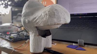

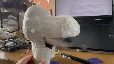

Step 3: Test the Jaw Mechanism
Once everything is assembled, it’s time to test the servo motor and make sure the mouth moves as intended.
- Power up the servo and observe its range of motion.
- Ensure the mouth opens wide enough for a child to easily insert pieces.
- When the servo closes the mouth, it should do so at an angle that gently pushes the piece downward, allowing it to slide into the toy’s belly.
- If needed, adjust the servo arm position or hinge alignment to improve the motion.

Step 10: Build and Finish the Dinosaur’s Body
Now that the head is working and the electronics are tested, it's time to create the body of the dinosaur!
🛠️ Forming the Body Shape
- I used a gift package shaped like an Easter egg, but you can also use a balloon as a mold.
- Cover it with about 5 layers of papier-mâché. Let each layer dry before adding the next.
- Once fully dry, cut two circular openings:
- One at the top to attach the head
- One at the bottom to retrieve the inserted pieces
- Cut a small half-circle at the bottom to route cables safely into the body.

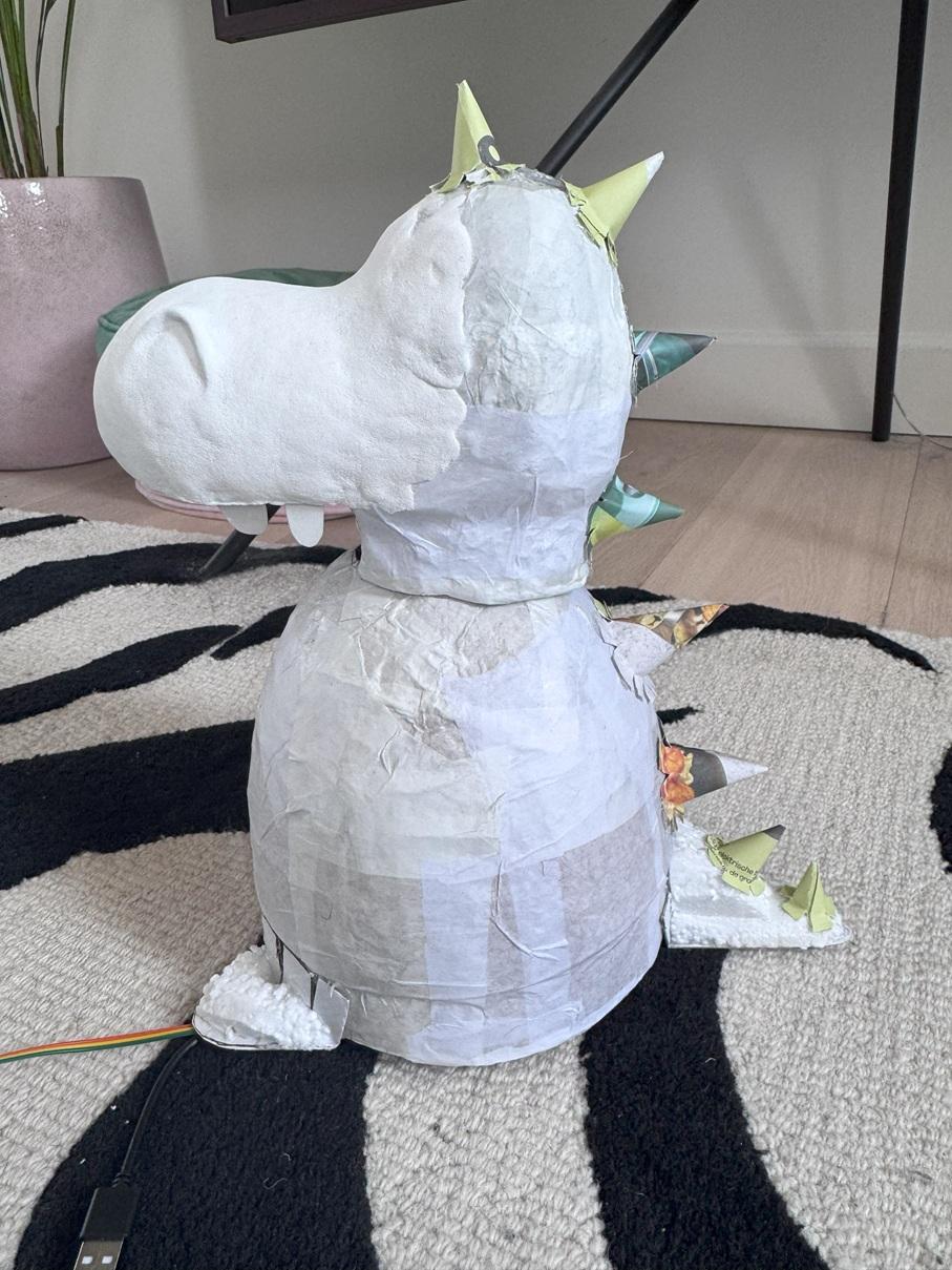

🦖 Adding Details
- Spikes: Cut strips from thick paper, roll them up into cones and glue them to the top of the head and along the back.
- Make teeth from the same paper and glue them to the upper jaw.
- Legs & Tail Base: Cut rough shapes for legs and a tail base out of thick cardboard, then glue them to the bottom of the body.
- You can use foil or polystyrene to add volume where needed (e.g., for shaping the head, legs, or tail).
- Secure the material with hot glue, then cover with paper strips.
✨ Smoothing and Finishing
- Apply a layer of super-fine papier-mâché to smooth the surface once the base structure is dry and firm.
- Use this layer to shape small details like nostrils, toes, and arms.
- Attach googly eyes and sculpt eyelids around them with the same fine material.

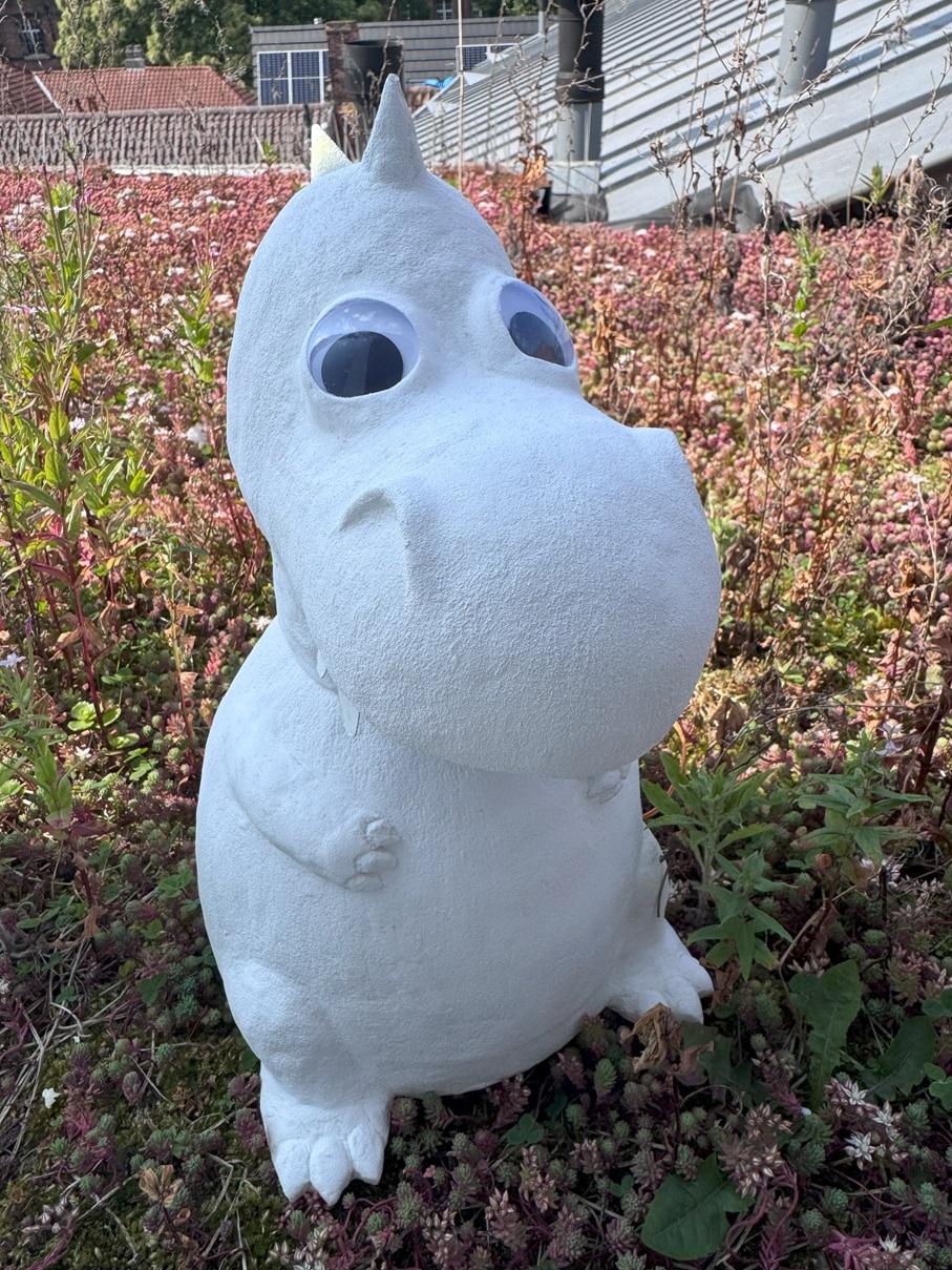

Step 11: Painting and Sealing
- Once everything is fully dry, apply a base coat or primer for acrylic paint. This helps prevent the paint from soaking in unevenly.
- After the base coat dries, you can use 220-grit sandpaper to smooth out any bumps.
- Paint your dinosaur with your chosen acrylic colors. Let the first layer dry, then apply a second coat (I applied 3 layers).
- Once the paint is completely dry and you've achieved the desired coverage, you can apply a varnish to protect the surface and give your toy a polished finish. This is optional.
