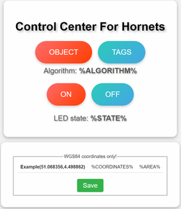

- esp32 web server.
- MySQL database.
- PHP for accessing the data from the database.

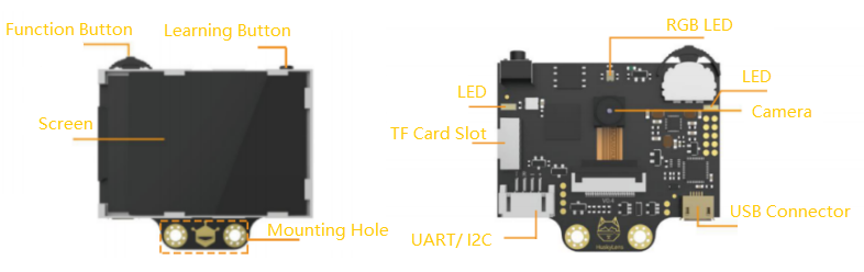

- Ai Camera/sensor: Huskylens
- Camera: 2MP OV2640 (Because the camera of the HuskyLens needs to be positioned at an angle and the focus needs to be adjusted, we attach a separate camera to the HuskyLens. Make sure that the camera type is with a threaded barrel lens.)

Learn April Tags
These are the AprilTags that you need to teach the HuskyLens. Make them small enough to fit on the back of the hornet. Connect the red wire from the HuskyLens to the VIN pin on the ESP32 and the black wire to the GND pin to power the HuskyLens. Now, we can learn the AprilTags to the HuskyLens. Short press the "Learning" button to learn the specified tag. The tags can be glued to the hornet's back with a drop of wood glue between the wings as shown. Don't cut too close to the tag, ensure there is still a small white border around the outside of the AprilTag.
Learn insects (Posibility)
Long press the "Learning button" to continuously learn the specified insect from different angles and distances. This function is heavily reliant on the dataset it was trained on, which means there's a possibility it may not perform optimally.

Step 1: For installing a WAMP (Windows, Apache, MySQL, and PHP) server to run the database I followed the video above.
Step 2 Accessing MyPhpAdmin: After completing the instructions for installing the WAMP server, you should be able to navigate to the server via the Google address bar by searching "localhost" You should see a page similar to the one above. Go to "Your Aliases" and click on PhpMyAdmin to add the database. The username is "root" with an empty password.
Step 3 Make the database: Make sure that the structure from the database is the same as shown in the picture.
Step 4 Add user and password: Go to "User Accounts," then "Add User Account." Choose a username and password (write them down). Scroll down to "Global Privileges" and check all. Once everything is done, press "Go."
Step 5: Go to the "www" directory on your PC from the WAMP server and create a new file as shown in the video. Copy and paste the code below into this new PHP file. Change the user, password, and database name at line 41 with the ones you created in step 4.This is the code for the map that shows the different circles for each hornet.
Step 6: We initialize the map and set its view to the chosen geographic coordinates. To do this, we need to set the coordinates where the map will be centered. Change the 'SetViewCoordinates' to the coordinates of the area near where the traps are located (line 114 in the code, put it between the [ ] like this: [51.068356, 4.498862]). Ensure that these coordinates are not the same as where the trap(s) are placed.

First code: index2.html
<!DOCTYPE html>
<html>
<head>
<title>ESP32 Web Server For Hornets</title>
<meta name="viewport" content="width=device-width, initial-scale=1">
<link rel="icon" href="data:,">
<style>
body {
font-family: 'Arial', sans-serif;
background-color: #f2f2f2;
color: #333;
text-align: center;
margin: 0;
padding: 0;
display: flex;
flex-direction: column;
align-items: center;
justify-content: center;
min-height: 100vh;
h1 {
color: #000;
font-size: 2.5rem;
text-shadow: 4px 4px 8px rgba(0, 0, 0, 0.3);
margin-top: 20px 0;
p {
font-size: 1.6rem;
color: #555;
text-shadow: 2px 2px 4px rgba(0, 0, 0, 0.3);
margin: 10px 0;
.button-container {
display: flex;
gap: 20px;
.button {
background: linear-gradient(135deg, #ff6b6b, #ff3d00);
border: none;
border-radius: 50px;
color: #fff;
padding: 24px 48px;
text-decoration: none;
font-size: 1.6rem;
cursor: pointer;
box-shadow: 0 4px 8px rgba(0, 0, 0, 0.2);
transition: background 0.3s ease, transform 0.2s ease;
.button:hover {
background: linear-gradient(135deg, #ff3d00, #ff6b6b);
transform: scale(1.1);
.button2 {
background: linear-gradient(135deg, #2bcbba, #45a6e5);
.container {
background-color: rgba(255, 255, 255, 0.9);
padding: 40px;
border-radius: 16px;
box-shadow: 0 4px 12px rgba(0, 0, 0, 0.3);
text-align: center;
.icon {
font-size: 3rem;
/* Opmaak voor coördinaten */
th, td {
padding: 10px;
border-bottom: 1px solid #ccc;
text-align: center;
button#submit {
margin-top: 20px;
background-color: #34B249;
color: #fff;
border: none;
border-radius: 5px;
padding: 10px 20px;
font-size: 1.4rem;
cursor: pointer;
transition: background-color 0.3s ease;
button#submit:hover {
background-color: #32CD32;
</style>
</head>
<body>
<div class="container">
<h1>Control Center For Hornets</h1>
<div class="button-container">
<a href="/object"><button class="button">OBJECT</button></a>
<a href="/tags"><button class="button button2">TAGS</button></a>
</div>
<br>
<p>Algorithm: <strong>%ALGORITHM%</strong></p>
</div>
<br>
<fieldset>
<legend>WGS84 coordinates only!</legend>
<div id="spacer_20"></div>
<form method="GET" action="/save">
<table>
<tr>
<th>Example(51.068356,4.498862)</th>
<td>%COORDINATES%</td>
<td>%AREA%</td>
</tr>
</table>
<button id="submit" type="submit" value="save" onclick="return validateForm()">Save</button>
</form>
</fieldset>
</div>
</body>
</html>
If you want to use an LED, use this index instead:
<!DOCTYPE html>
<html>
<head>
<link rel="stylesheet" type="text/css" href="style.css">
<style>
body {
color: #333;
text-align: center;
margin: 0;
padding: 0;
display: flex;
min-height: 100vh;
h1 {
color: #000;
font-size: 2.5rem;
margin-top: 20px 0;
p {
font-size: 1.6rem;
color: #555;
margin: 10px 0;
.button-container {
display: flex;
gap: 20px;
.button {
border: none;
color: #fff;
padding: 24px 48px;
font-size: 1.6rem;
cursor: pointer;
.button:hover {
.button2 {
.container {
padding: 40px;
text-align: center;
.icon {
font-size: 3rem;
th, td {
padding: 10px;
text-align: center;
button#submit {
margin-top: 20px;
color: #fff;
border: none;
border-radius: 5px;
padding: 10px 20px;
font-size: 1.4rem;
cursor: pointer;
</style>
</head>
<body>
</div>
<br>
<a href="/on"><button class="button">ON</button></a>
<a href="/off"><button class="button button2">OFF</button></a>
</div>
<br>
<p>LED state: <strong> %STATE%</strong></p>
</div>
<br>
<fieldset>
<table>
<tr>
<td>%AREA%</td>
</tr>
</table>
</form>
</fieldset>
</div>
</body>
</html>

Step 5: Assembling the Base
Step 1 (Yellow arrows): Slide the HuskyLens into the HuskyLens unit part. Make sure that the flat cable from the newly added camera slides between the 3D-printed parts (purple circle). The flat cable from the HuskyLens camera itself can be fitted into the space in front of the camera (orange circle). To ensure the camera stays in position, it's recommended to put some double-sided tape on the back of the camera and stick it to the 3D-printed part.
Step 2: We need to adjust the focus on the camera. Place the unit loosely on the base, connect the red wire from the HuskyLens to the VIN pin on the ESP32 and the black wire to a GND pin like before. Now, adjust the focus so the HuskyLens can recognize an AprilTag close enough to the camera. (Make sure the HuskyLens is set to tag recognition.)
Step 3: Before securing the HuskyLens unit in place, we need to thread a piece of fabric through the hole in the center of the base. This fabric will absorb the bait and attract the hornets to it.
step 4 (Black and green arrow(s)): Place the entire HuskyLens unit onto the base part and secure it with screws from underneath. Slide the cover part onto the base part to enclose the open side of the HuskyLens. You can secure the cover part with a rubber band if it's to loose.
Step 5 (Blue arrow): slide the plexiglass (acrylic) in place.
step 6 and 7 (Red and purple arrow(s)): There is an option to place an LED into the detection part to provide additional light if there isn’t enough for the camera to detect the AprilTags or insects. Simply slide the detection part onto the base as shown.
Step 8 (Orange arrows): Secure the thread part with the thread to the base using 4 screws/bolts.

Step 8: Getting Started: Accessing the Webserver
Accessing the webserver
After the assembly is completed and the code and SPIFFS are installed on the ESP32, we can access the web server by connecting to the access point created by the ESP32 once it is powered on. Go to the settings on your device and search for the WiFi network named "hornets." Connect to this WiFi network (no password needed) and open a browser. Enter the default IP address of the ESP32, "192.168.4.1"
You should see a WiFi manager page where you can enter your SSID and password for your home network. After submitting, the ESP32 will reboot and attempt to connect to the provided network. If it successfully connects, a new IP address should be visible on the HuskyLens screen. Reconnect your device to your own WiFi network and enter the new IP address in your browser. You should now see the web server.
Changing the algorithm
It's possible to change the algorithm of the HuskyLens from the web server by pressing the "Object" or "Tags" buttons. By default, it is set to "Tags." When you press one of the buttons, the active algorithm will be displayed underneath the buttons. The "Object" algorithm is used to detect insects, while the "Tags" algorithm is used to detect AprilTags.
controlling the LED
The LED can be controlled with the two buttons, "ON" and "OFF." The state of the LED, whether it's on or off, will be displayed.
Adding the coordinates and area
Enter the coordinates where the trap will be placed and select the area you are in. You can easily find the coordinates using Google Maps and copy-paste them. After entering the coordinates and selecting the area, click on "Save" to save the information. Make sure that when entering the coordinates, there isn't any space between the comma and the next number:
GOOD: 51.068356,4.498862
BAD: 51.068356, 4.498862
