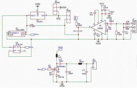

Step 1: The Circuit and Variations.
A better, more readable, version of the above circuit can be found on the github site mentioned in the supplies section above.
NOTES:
Several components are optional or can be substituted. For example:
Q1 Suggested as a 2n7000, but many will work as a substitute. For example ZVN2110A. Try to avoid ant misfit that has a high input capacitance (Eg. IRF510 etc) these will load the oscillator module and will probably not work very well. You should select one that has at least 50-60v Vds.
C9 Optional, under most circumstances not required, it’s to help stop high voltage conditions that may occur with different aerial conditions. With the suggested 1m of wire it’s not needed. You may well have to try various values if you connect a longer wire.
L2 Again a nominal value of 330uh, For longer aerial wire a smaller value may be used (150uh for example).
C11 Nominal 100pf, this is used to loosely match the aerial to the output, a better solution would be a trimmer cap or and old variable capacitor from a vintage chassis. You should use a higher voltage component 100v+
R6/R7 and R5 form a low impedance input network suitable for most players (mp3, CD players etc) that use 50-150ohm headphones. You can increase R5 to 240r if you can’t get enough volume to modulate the signal.
The circuit shows two power connectors, this is to allow for different PCB layout - you only need one or the other.
