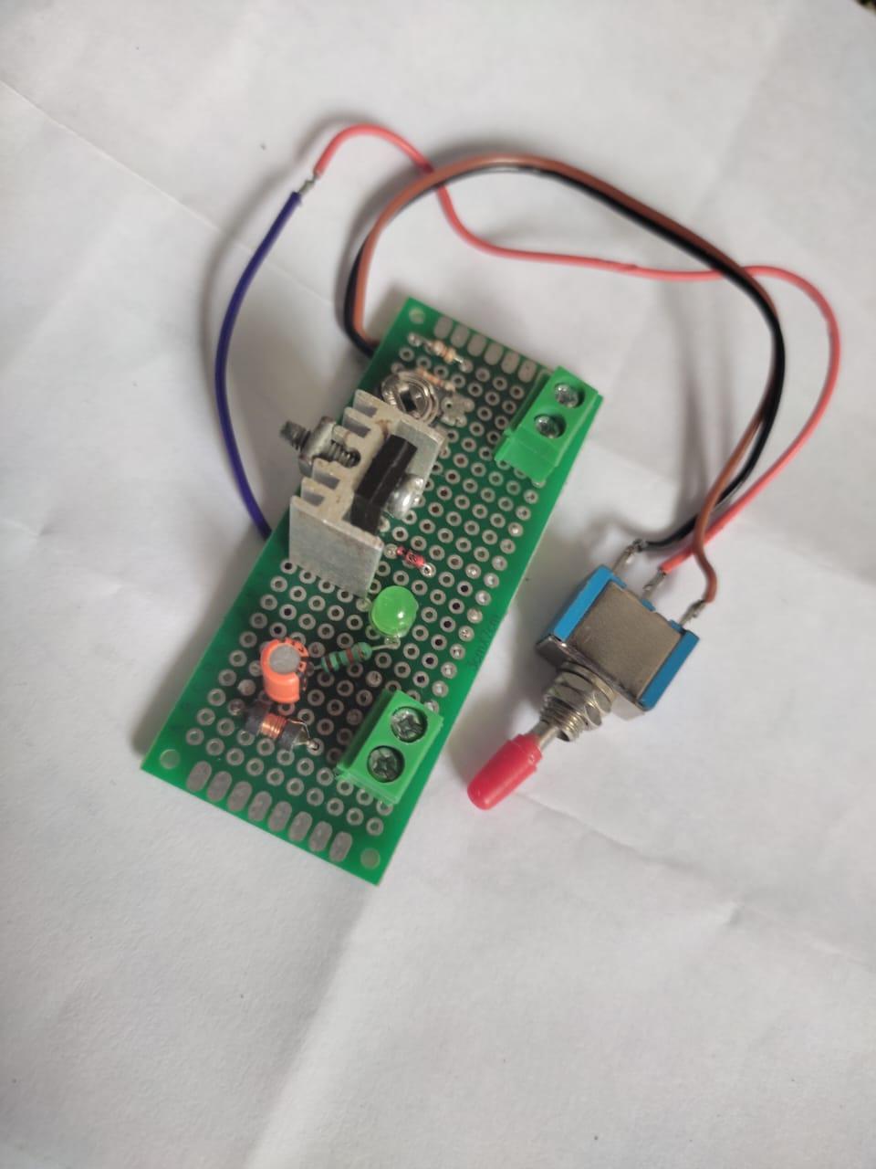

Step 1: Circuit Diagram
This is the application circuit diagram of AN6651. A toggle switch is used in the circuit to switch between Low(Normal speed of tape) and High Speed.
Step 2: Project Images
Step 3: Testing Video
