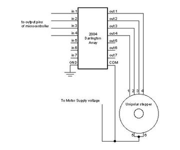

Step 3: Prototype of Launcher Gear Driving by 2003 With UNO

Step 5: Connecting Sensors
the platform read POS_v (+5 == LDR == 10K == GND ) from 10K OHM
and read POS_h (+5 == LDR == 10K == GND ) from 10K OHM
so that 10K connecting to UNO PIN A2,A3

Step 8: Coding
the most complex part it's here !
there are three state(s) and 2 speed(s) :
1)Target is right side upon luncher ==> do the turnning forward with slow.
1')Target is right side upon and near luncher ==> do the turnning forward with fast.then delay 20ms.
2)Target is left side upon luncher ==> do the turnning reverse with slow.
2')Target is left side upon and near luncher ==> do the turnning reverse with fast. then delay 20ms.
3)Target is just right upon luncher ==> do the turnning nothing with delay 0.5 secound.
if there is reading POS_v and POS_h different then do the turning routine else delay 50ms.
4) POS_v > POS_h +3 do the forward routine.
5) POS_h > POS_v +3 do the reverse routine.
else STOP.: shut the stepper motor down and then delay 0.5second.
