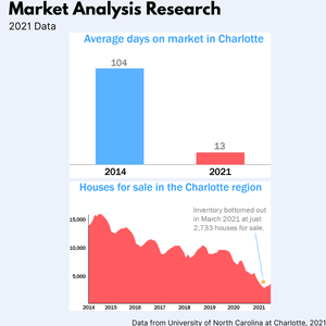

Charlotte is experiencing an increasing affordable housing crisis year over year. This is fueled by high population growth, constrained availability of housing, increasing real estate costs, and growing investor interest in buying and holding properties. Since the turn of the 21st century, Charlotte has emerged as one of the fastest growing cities in the United States (3rd), with the metro area receiving an additional 49,000 new residents between 2022 and 2023 alone. As indicated in a 2024 report by the Charlotte Planning Department, the city has a deficit (lack of) housing stock by a minimum of 11,500 units since 2012 and must now add more than 10,600 units per year to keep up with demand. The shortfall has created fierce competition for housing within the city, which has led to an accelerating of prices and making homeownership and even rental housing out of reach for many residents.
This can be seen with the price of housing in Charlotte increasing faster than the nation overall. The value of homes in Charlotte has grown about 72% from 2017 to 2024, and the United States increased by 41%. The median price of a home in Charlotte was $429,945 as of September 2024, as reported by Charlotte-Mecklenburg Housing Strategy. At these rates, a family would need to earn more than $51,116 annually in order to be able to afford the median priced home on a standard 30 year 7% loan designating 30% of their income towards the house which is what Charlottes government designates as affordable housing (30% or less of income spent on housing). This is a significant margin more than the 2020 median family income of a $48,670 based on U.S. Census data. Home renters have comparable issues. Renting median apartments in Charlotte is also $1,416 per month. Calculating this over each month would mean a cost of $16,992 which at a 30% expenditure using the government definition of low-cost housing, it would require $56,640.
Affordable homes for sale are also disappearing rapidly in Charlotte. Over 33% of homes that were sold in Charlotte metro for under $150,000 in 2014, but dropped to just 2% in 2024. As low as 19% of homes selling for under $300,000, according to the Charlotte-Mecklenburg Housing Trust Fund report. Naturally occurring affordable housing, or NOAH, has similarly become in short supply at just 8% to 15% of the available rentals that are affordable to those families who make less than 50% of the Area Median Income. This category of loss of affordability has served to increase displacement, especially in long-time Black and working-class communities. An increase in investor and corporate ownership has also distorted Charlotte's real estate market and reduced the amount of affordable housing.

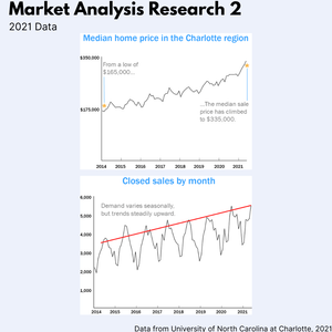

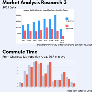

Housing Construction Trends and Permits
Charlotte issued an average of 9,000 residential building permits between 2018 and 2023, but only 12% were for multifamily units, which tend to be cheaper than single-family homes. Multifamily unit permits alone declined 8% last year from 2022 levels, which shows a slowing on the pipeline of affordable rentals. Construction of single-family housing added to the production of about 85% of new housing units, reflecting market preference and zoning allowing for lower-density development, according to the Charlotte Building and Planning Department, 2024.

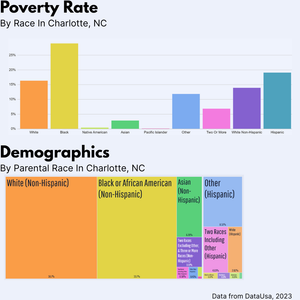

Income Inequality and Housing Affordability
The Gini coefficient of Mecklenburg County, measuring income inequality, increased from 0.46 in 2015 to 0.52 in 2023, which indicates growing disparity. This rise tracks the rise in housing cost, which is an indicator that economic growth is being disproportionately shared with higher-income groups. The Mecklenburg Economic Development Report median income has lagged behind that of housing costs: median family income increased roughly 15% from 2015 through 2023, while median home values increased by nearly 60% in the same span.
Charlotte's affordability crisis for housing disproportionately impacts minority communities, such as Black and Hispanic residents. Black households in Mecklenburg County are nearly twice as likely as white households to be cost burdened, with over 55% of Black renters spending more than 30% of their income on housing. This is then compounded by racial income disparities—Black households' median income is around $43,000 compared to over $80,000 for whites—making homeownership and stable housing significantly less within reach. Furthermore, eviction records show that while Black residents make up around 33% of Charlotte's population, they are responsible for over 60% of eviction filings, showing the difference economically. This is even more stark in Charlotte, where black residents make up over 30% of the population, and Charlotte also has a 17% Latino population.

Commuting Patterns and Housing Location
The average one-way commute time for Charlotte residents increased from 26 minutes in 2015 to 31 minutes in 2024, which shows urban spread and housing cost burdens pushing people further away from work. People who live more than 20 miles out from the city center spend an average of $8,400 annually on transportation costs alone, when combined with housing costs, exceeds 45% of many moderate and low-income families household incomes.

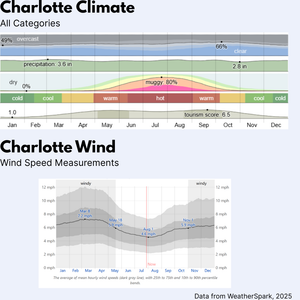

Step 4: Environement
Charlotte, has a humid subtropical climate with hot and humid summers and mild winters with occasional snowfall. The region receives enough precipitation throughout the year that supports dense vegetation and a long growing season. Located in a deciduous forest biome that is composed of broad-leaved trees like oaks, maples, and hickories that shed their leaves in fall. This biome supports a varied array of animal and plant species, and the seasonal cycle creates definite repetitive ecological patters.
This means that it allows for a variety of houses and environments with no specific structural major limitations.

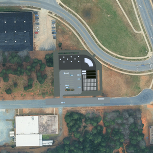

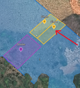

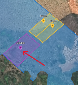

Step 7: Finalizing a Building Location
The building location I chose next to sugar maple station allowed for easy transport from many services. The above images display a one and a half mile radius, (2.41 km). This would generally be considered walking distance. In addition, the second image displays the rail stops of the blue line in red. These also further allow for ease of access, in addition to the area being well-connected with sidewalks for walking. The icons of each element are described below:
+ - Religious symbols for places of worship. There are many nearby the build location and of different sizes and sects.
Child icon - Schools, colleges, trade programs, and libraries. There are many schools nearby and often those of similar age groups are located together, like daycares and preschools, allowing for less transport for parents of similar aged children.
Heart icon - Gyms, places of wellness and recreational activities. There are many nearby with a variety of activies like golf, tennis, and arcades.
Tree - Parks, there are several nearby.
Spout - Gas stations, there are many near the build location and are essential in an affordable housing setup to save time and money driving to one.
Building - Restaurants and malls. Important for getting goods, several are nearby.

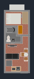

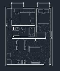

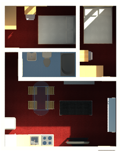

Step 9: Creating a Layout (Single)

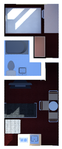

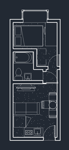

Then I addressed a smaller one: the 1-bedroom, 1-bath apartment for one or two adults. Much of this design was re-engineering the double to fit into an even smaller space. This space was going to have to fit into just 10' x 25', a total of 250 square feet, half of the double. From the beginning, I knew I'd have to go vertical with my space planning. This slender, elongated form lends itself to a linear flow, so I started at the forward end with an open kitchen and living area, giving it 10' x 12' of floor space combined. That left sufficient room for a minor seating area, table, and a kitchenette, all encompassed within one shared room—much like the double, the open plan was more flexible and allowed for more seemingly more space.
Then came the bathroom, centered in the unit. It's 7' x 7'—tiny, considering it is only 41sqft, but big enough for a standing shower, toilet, and sink. Plumbing stayed along the same wall as the kitchen to again be cost-effective. The bedroom is in the back, and I allotted it a 10' x 10' space, which was 80 sq ft. I put in a full sized bed (4' x 6.25'), space for a desk, so it could double as a study, and a 2' x 4' sliding closet. I included a 6-foot window to make it let in light. The unit is sleek in design, but it still offers privacy, real sleeping space, and working living space.

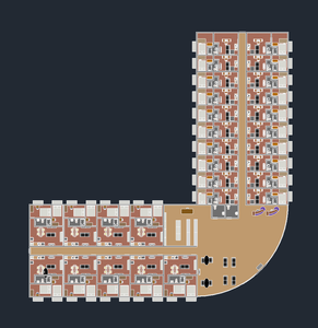

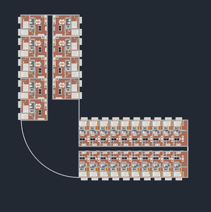

For my final layout, I would have 10 double units on each floor, each wing would extend 100 feet out, with 5 on each side. This would allow for 20–40 residents in double units. I would also have 20 single units of 1–2 people each, 10 on each row. Doing 40+20x2=80, which means my building would have a maximum capacity of 80 people on each floor, with three floors that would measure 240 people, with the exception of 4 less on the first floor so a maximum capiacity of 236, a significant amount considering it would take 66 times less space than the surrounding population area of more than a million square feet.
I also chose to include bike stands and a parking lot for easy access. It would be easy to reach other places nearby since there were many amenities in a walkable distance. A fundamental part I wanted to avoid was an underground parking lot, since it would cost significantly more especially for this relatively modest sized apartment.

I created a final sketch of what the body should look like. Each wing was 100x55 and the center was 55x55.

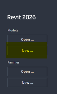

Step 13: Making a Project
Now that the design is done, you can create a file to actually begin flooring out your model. I chose to use Revit from Autodesk, since it will allow me to create accurate architectural models of the building and realistically render and display them. If you are unfamiliar with these types of programs and just starting out programs, you can use Tinkercad, also by Autodesk, I used to help learn the fundamentals in school. Students can get one year free if you send proof of your enrollment.
Once you have downloaded Revit, you can choose a new model, and then load a default template. I chose to start with the smallest room, the single unit. Go to the architecture tab and insert a walled exterior to our dimensions, you can press shift for straight lines.

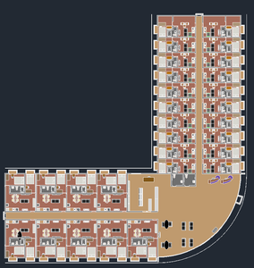

I started by then filling in the main building with 20 small rooms, 10 on each row, and 9 total double rooms. I then added panes of glass and a front door while adding a back exit. The one less double room allowed for a store, this is where the extra supplies would be kept that were essential to residents. I also added a elevator to each side, this would be the main way to change floors. The left elevator goes from floors 1-3 and the right goes from 1-4 (in this image).
Step 17: Designing the First Floor

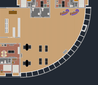

I created the main lobby with reception a waiting area with couches and seating. I also kept two unisex bathrooms for use of guests. I also filled in the store with different spacing for varying items and groceries.
I then used a section selector to make each part more visible by using a section box and highlighting downward allowing better sight inside the rooms with high walls.

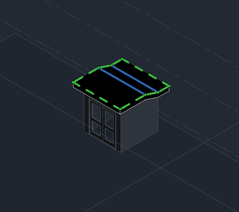

Step 21: Creating the Level 4 Access
I started work on this by making four walls and connecting it to the right elevator system from before. I also changed the roof using focus lines and put a double door for access. I then used the railing (handrail) around the right side, this would be the terrace for residents.

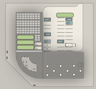

Step 22: The Rear
I started work on this section by making solar panels out of sets of six and grouping them, allowing for ease of access for maintance. I also provided the two AC units, that would be indiviusally working. One would funnel regular air conditioning to the PTAC units in the double rooms. Where the other was for use for the greenhouse ventilation from the tree spaces on top.
I then worked on the parking lot adding in some trees, parking spots (including handicaps close to the entrance), and vechiles. I also added bike racks since there is good sidewalk and accomidations for biking and walking in the area. There are also many workplaces in the area so residents can commute with only bikes as well.

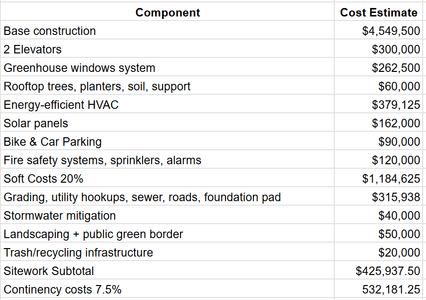

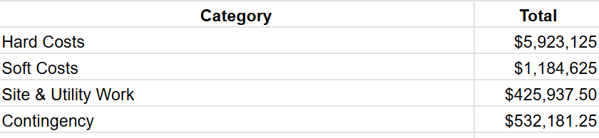

Step 29: Calculating the Costs
The project's cost estimate, a low-income sustainable apartment building in Charlotte, NC, has 89 apartment units—29 larger 500 sq ft apartments with 4 occupants and 60 smaller 250 sq ft apartments with 2 occupants—spread across three stories with a total floor area of 25,275 sq ft. With energy efficiency and affordability being primary considerations in the design, the building has two elevators, a greenhouse facade, rooftop trees, and a 60x60 ft solar array. These features significantly influenced both the long-term operating and construction costs.
Hard construction costs accounted for the biggest share of the budget, with approximately $5.92 million. This sum includes the foundation building structure, HVAC systems designed for passive cooling, greenhouse window incorporation, rooftop tree structure, fire safety equipment, and parking facilities for bicycles and automobiles. Solar panels added expense but were counterbalanced by never again paying for electricity. Soft costs—architecture, engineering, legal fees, and permits—added another $1.18 million. Site work such as utility connections, grading, landscaping, and trash infrastructure had been pegged at around $426,000. It included a 7.5% contingency fund for unforeseen expenses.
Adding all these categories, the gross development cost amounted to around $8.07 million. However, due to the solar installation that generates an estimated 87,000 kWh of electricity annually, the project would achieve over $450,000 in power savings over 30 years. When this energy offset is included, the net-effective cost of the building drops to around $7.62 million. This works out to a cost of around $136,000 per unit, or $44,800 per resident, far below the average cost range of low-income housing developments in Charlotte that incorporate sustainable technologies.

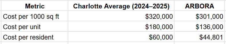

Step 30: How Does It Stack Up?
In all categories Arbora is significantly cheaper than recent developments of low cost housing in Charlotte, NC. This was impressive considering it also offers less costs in the future due to its energy saving capabilities. One factor leading to its lower costs is the cheaper cost of land in the build location.
The estimates are based off of mecklenburghousingdata.com

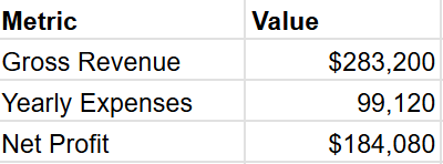

Step 31: Is It Profitable?
With a total layout of 29 double apartments (500 square feet each) and 60 single apartments (250 square feet each), the ARBORA project maintains its total square feet of 25,275 while optimizing for maximum occupancy and affordability. With a rent of $400/month for double apartments and $200/month for single apartments, the building earns a total of $23,600 per month, or $283,200 annually. As the construction relies solely on sunlight and does not have in-unit independent appliances like washers and dryers, the operating cost is kept minimal. Assuming that a typical 35% of annual revenue goes into maintenance, insurance, water, waste, workers, and reserves, the operating expenses are approximately $99,120 annually, leaving a net annual profit of $184,080.
The net overall profit over a 30-year timeframe would be $5.52 million. The cost per resident remains extremely low at $44,800, taking into account the energy self-sufficiency gained by virtue of the 60×60-foot solar panel array and passive greenhouse design. The financial structure of the project not only sustains itself in the long term, but also in the short term robust, and resilient to vacancy or subsidy fluctuations without relying on high rents. This makes ARBORA not only profitable, but also stable, sustainable, and replicable in other areas of Charlotte or other urban settings.
