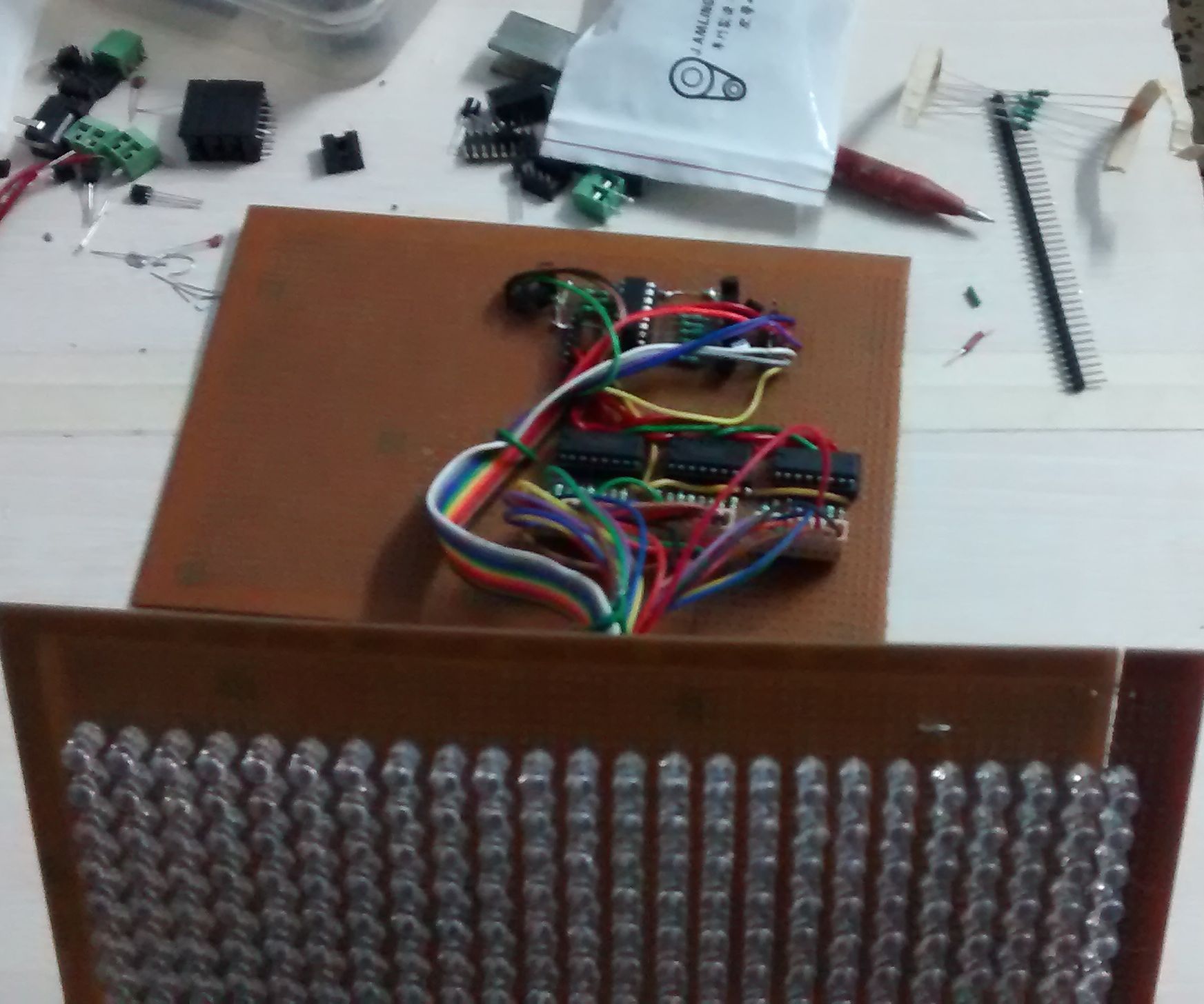

Introduction: ARDUINO AS a 8051 PROGRAMMER - CHEAPEST PROGRAMMER IN THE WORLD
ITS TO HARD TO FIND 8051 PROGRAMMER WITH USB CONNECTIVITY.
YOU WILL FIND SO MANY CIRCUITS FOR 8051 PROGRAMMING BY MAX232 BUT IT WILL NOT WORK IF ITS NOT ICSP OR THE BOOTLOADER IS NOT INSTALLED ON CHIP.
BUT IF YOU HAVE ARDUINO YOU CAN USE IT AS PROGRAMMER FOR 89S52(ATMEGA89S52).
I HAVE CREATED ARDUINO SHIELD.
THIS IS THE CHEAPEST PROGRAMMER IN THE WORLD
COST WILL BE VERY LOW IF YOU HAVE ARDUINIO ALREADY.
Step 1: WHAT YOU NEED?
ARDUINO UNO (ANY ARDUINO)
AT89S52
IC STAND
PCB
22PF CAPACITOR 2 NO.
CRYSTAL 12Mhz(8Mhz to 16Mhz can work)
MALE PIN HEADER
USB CABLE
10K OHM RESISTOR
10uF capacitor
Step 2: TOTAL PRICE
CURRENCY IN INDIAN Rs.
IC STAND:- 5Rs
CRYSTAL:- 10Rs
CAPACITOR:- 3Rs
PCB:- 10Rs
MALE PIN
HEADER:- 5Rs
AT89S52 40Rs
TOTAL ONLY:-70Rs.
Step 3: Circuit Diagram and Software
upload at89s52program skatch to arduino
connect the circuit as per diagram
open 89s52programmer.exe
select com port of your arduino
click open hex file, and browse it ..
then click on identify chip you will see the message at bottom of the window (chip detected)
then click on upload hex
wait for a moment and message to diplay(finished writting).
now enjoy....
