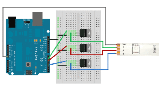

MOSFETs you need one for each color, and they need be rated to handle the max current you may use. About 330 mA per meter for each channel, 1.66 A per channel for a 5 meter strip. The MOSFETs in the link above are rated for 49 A. Three of those could handle a 150 meters of LEDs. Not that I need it, but for $10 I figured better to be able to cover every inch of my house with LEDs and not need to, than need to and not be able to. FYI: 150 meters would need a 742 A power supply.

Step 1: Connect Your MOSFETs to Your Arduino
A week or two later after the MOSFETs arrived, and I had some time to get started, I went back to the bookmarked page, only to have Google tell me it no longer existed. I panicked for a minute at the thought of working from memory and then a little more at the thought of screwing up and frying my Arduino...again. My panic was short lived when a quick web search for MOSFET Arduino RGB LED controller brought me to this page. I always forget to check Adafruit, or even the Arduino page.
Adafuit does such a great job explaining it, and the pictures do even better. I think the only thing I can say that you can't get from the pictures is I didn't notice any real difference with or without the resistors. I would imagine the longer the strip you have the more necessary they might be. Other than that Adafruit says something weird about connecting power and ground if you power the LEDs directly, but you only need to connect the grounds. Be very care where you connect 12v on the Arduino. Actually connecting 12v anywhere but the DC power socket will pretty much fry it instantly. vin should be ok to, but why connect power a mm away from an almost identical pin that would basically be the self destruct button if you connected to it. That's like playing that stabby knife finger torture game. You're scaring the hell out of your fingers for no reason, and there's a very real possibility you're gonna loose one of them eventually.
