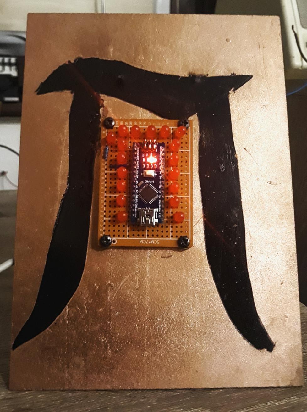

Step 1: Arduino LED BLINKING PI
Before soldering this circuit it would be better to test it on a breadboard.
This is the main part of the build (and also coolest, it could be a project on its own). Start by placing Arduino Nano somewhere in the middle of the board, and then arrange LED-s around it to form a Pi but make sure that you place them in the same order (anodes (+) on one side, cathodes (-) on the other side). Then bend the leads and connect all LED cathodes (-) and anodes (+) are going to Arduino pins according to the schematic. And then add a resistor between the LED-s cathode (-) side and Arduino GND.

Step 5: Putting It All Together.
Before assembling it all together drill a hole. This hole is for the power supply (not needed if Arduino board is powered via USB port).
Solder power supply cable to Arduino Nano board one wire goes to GND pin, and other wire goes to 5v pin.
Attach Popsicle sticks and hinge Pi to the backside of the MDF board
Step 6: Final Step
Attach Arduino Nano Pi Board to the MDF board using screws with spacers.
