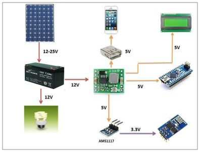

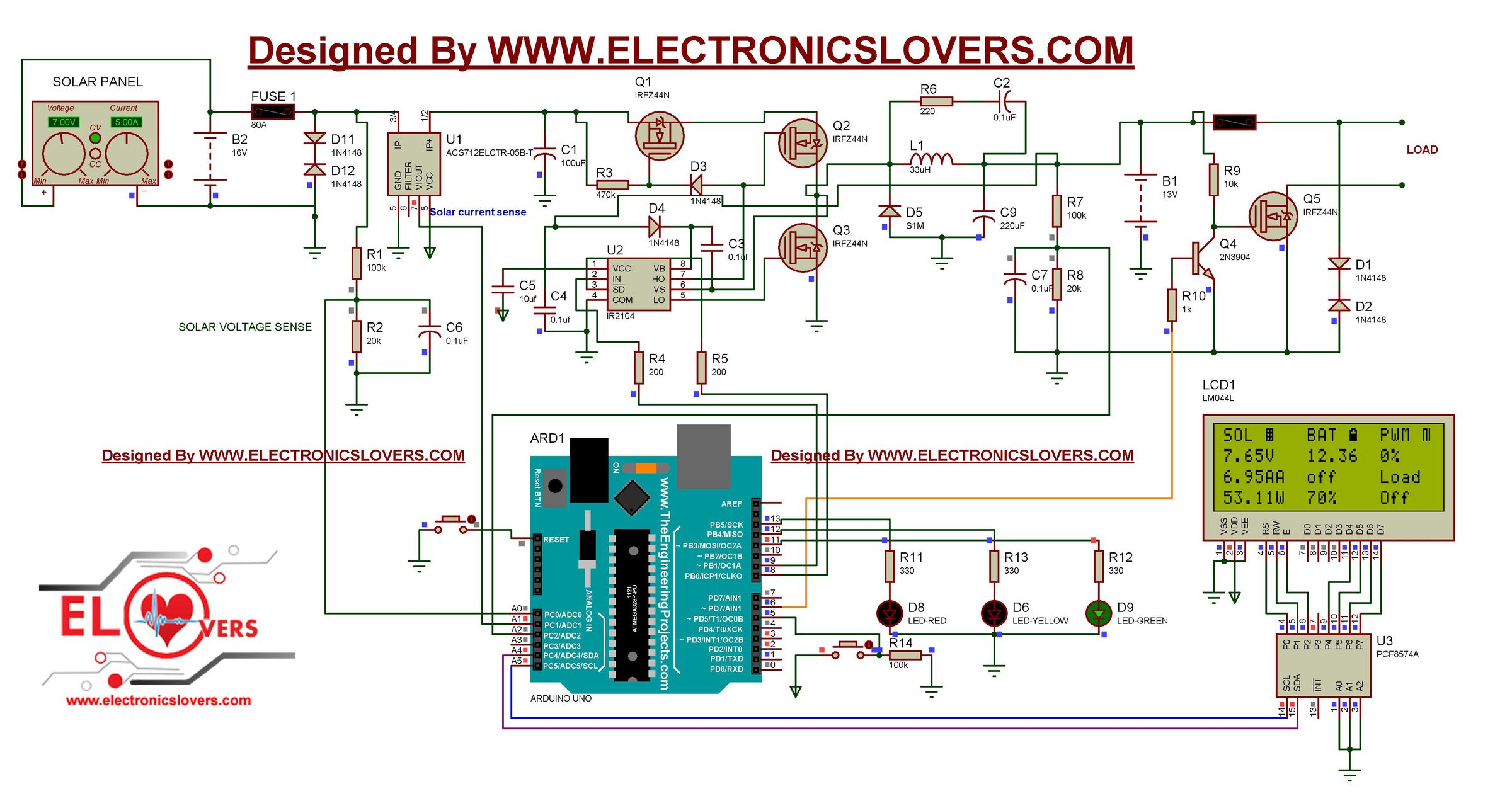

This instructable will cover a project build for an Arduino based Solar MPPT charge controller. It has features like LCD display, Led Indication, Wi-Fi data logging and provision for charging different USB devices. It is equipped with various protections to protect the circuitry from abnormal conditions.
The microcontroller used is in this controller is Arduino Nano. This design is suitable for a 50W solar panel to charge a commonly used 12V lead-acid battery. You can also use other Arduino board like Pro Mini,Micro and UNO.
Nowadays the most advance solar charge controller available in the market is Maximum Power Point Tracking (MPPT). The MPPT controller is more sophisticated and more expensive. It has several advantages over the earlier charge controller. It is 30 to 40 % more efficient at low temperatures.But making an MPPT charge controller is little bit complex in comparison to the PWM charge controller. It requires some basic knowledge of power electronics.
I put a lot of effort to make it simple, so that anyone can understand it easily. If you are aware about the basics of MPPT charge controller then skip the first few steps.
The Maximum Power Point Tracker (MPPT) circuit is based around a synchronous buck converter circuit..It steps the higher solar panel voltage down to the charging voltage of the battery. The Arduino tries to maximize the watts input from the solar panel by controlling the duty cycle to keep the solar panel operating at its Maximum Power Point.
Specification of version-3 charge controller :

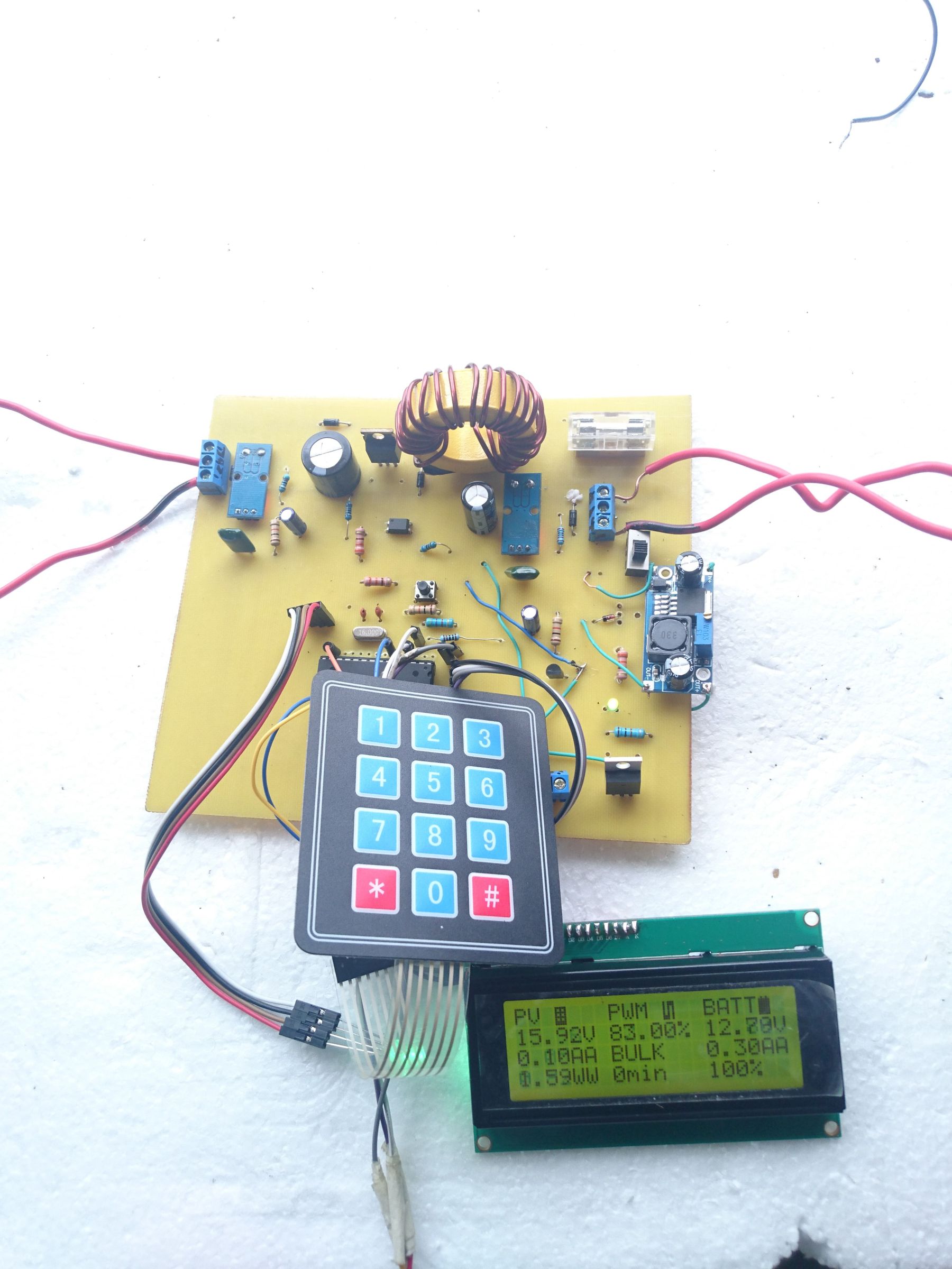

1.Based on MPPT algorithm
2. LED indication for the state of charge
3. 20x4 character LCD display for displaying voltages,current,power etc

Electrical specifications :
1.Rated Voltage= 12V
2.Maximum current = 5A
3.Maximum load current =10A
4. Input Voltage = Solar panel with Open circuit voltage from 12 to 25V
5.Solar panel power = 50W

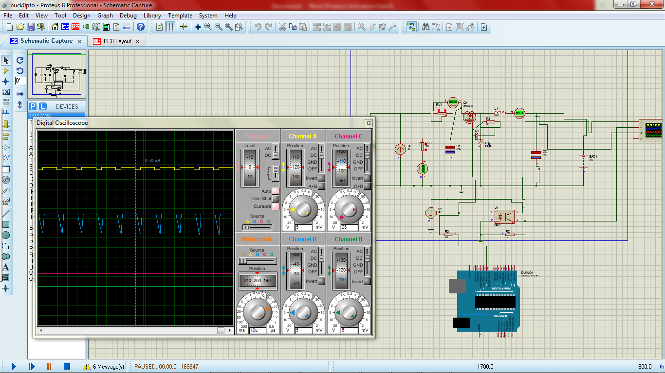

3. Testing the Buck Circuit

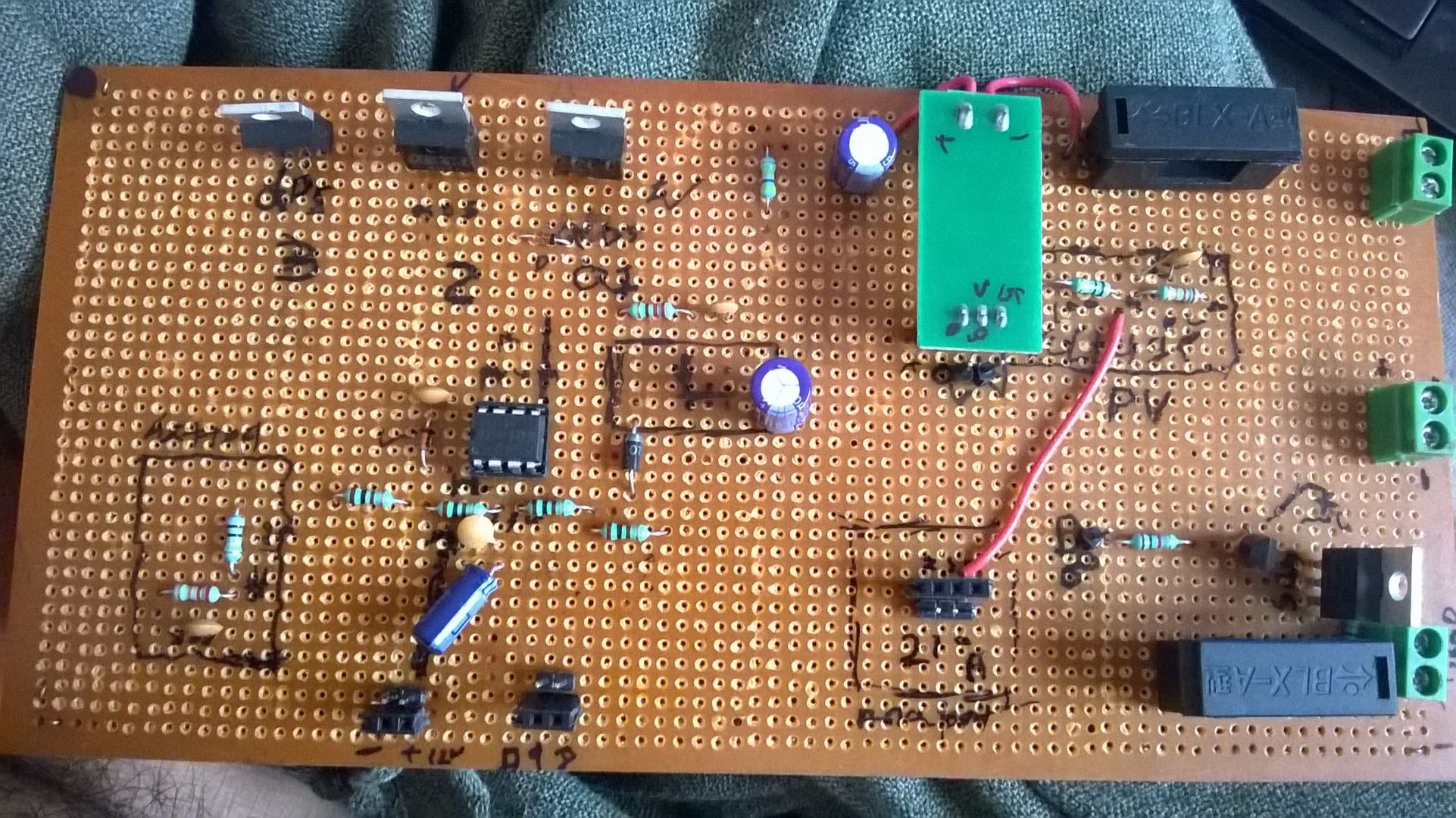

16.Prototype Board ( Amazon )

Step 10: SCHEMATIC AND WORKING
The input power connector to the solar panels is the screw terminal JP1 and JP2 is the output screw terminal connector to the battery. The third connector JP3 is the connection for the load.
F1 and F2 are the 5A safety fuses.
The buck converter is made up of the synchronous MOSFET switches Q2 and Q3 and the energy storage devices inductor L1 and capacitors C1 and C2 The inductor smooths the switching current and along with C2 it smooths the output voltage. Capacitor C8 and R6 are a snubber network, used to cut down on the ringing of the inductor voltage generated by the switching current in the inductor.
The third MOSFET Q1 is added to allow the system to block the battery power from flowing back into the solar panels at night. In my earlier charge controller, this is done by a diode in the power path. As all diodes have a voltage drop a MOSFET is much more efficient.Q1 turns on when Q2 is on from voltage through D1. R1 drains the voltage of the gate of Q1 so it turns off when Q2 turns off.
The diode D3 (UF4007) is an ultra-fast diode that will start conducting current before Q3 turns on. It is supposed to make the converter more efficient.
The IC IR2104 is a half-bridge MOSFET gate driver. It drives the high and low side MOSFETs using the PWM signal from the Arduino (Pin -D9). The IR2104 can also be shut down with the control signal (low on the pin -D8) from the Arduino on pin 3. D2 and C7 are part of the bootstrap circuit that generates the high side gate drive voltage for Q1 and Q2. The software keeps track of the PWM duty cycle and never allows 100% or always on. It caps the PWM duty cycle at 99.9% to keep the charge pump working.
There are two voltage divider circuits( R1, R2, and R3, R4) to measure the solar panel and battery voltages. The output from the dividers is feeding the voltage signal to Analog pin-0 and Analog pin-2. The ceramic capacitors C3 and C4 are used to remove high-frequency spikes.
The MOSFET Q4 is used to control the load. The driver for this MOSFET is consists of a transistor and resistors R9, R10.
The diode D4 and D5 are TVS diodes used for overvoltage protection from the solar panel and load side.
The current sensor ACS712 senses the current from the solar panel and feeds to the Arduino analog pin-1.
The 3 LEDs are connected to the digital pins of the microcontroller and serve as an output interface to display the charging state.
The reset switch is helpful if the code gets stuck.
The backlight switch is to control the backlight of the LCD display.
Step 11: Test the Gate Driver and MOSFETs Switching
Hey, I think I have talked a lot about the theory. So let's do some practical.
As I have told earlier the heart of the MPPT charge controller is Buck Converter. As per me if your buck converter circuit works perfectly. You can do the rest thing easily. So first let's test the Mosfets switching and the driver.
Before soldering, I request to do it on a breadboard. I have blown a lot of MOSFETs during my testing. So be careful during the connection.
Connect everything as per the schematic given above. Now you can omit the TVS diode, current sensor, and voltage divider.
After connecting everything tests the resistance between the input rail. It should be several KOhm. If you get resistance bellow 1K then recheck the circuit connection.

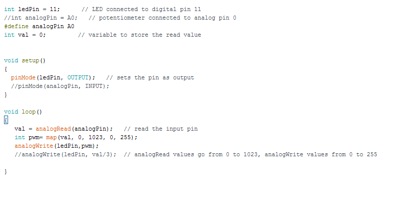

Upload the test sketch to the Arduino. The code in the form of the text file is attached below.

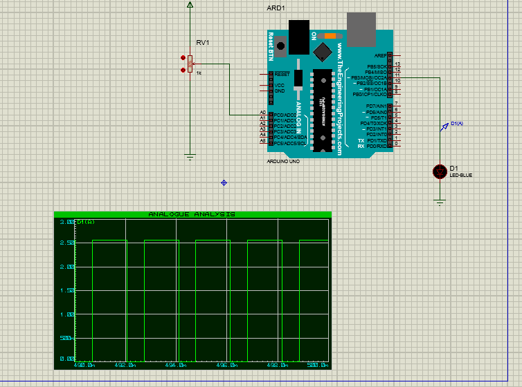

Then connect the scope in between the source of Q1 and GND.
The result should be a PWM with frequency 50KHz.
The waveform obtained during my testing is shown above.
If everything goes right then proceed to complete the bulk converter circuit. ( i.e adding inductor and capacitor)

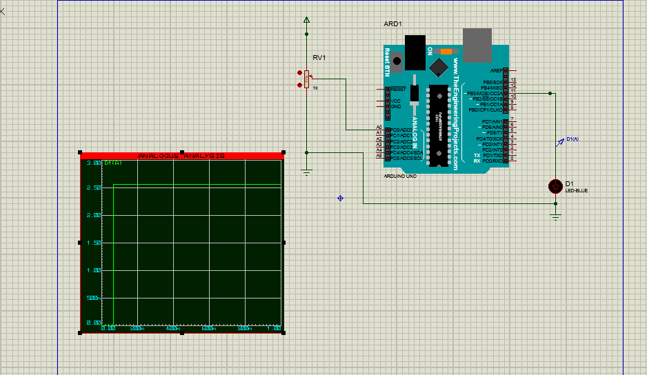

Now give power to the input rail and Arduino.
Connect the probe of your scope in between the output capacitor.
The result is shown above. The output should be a steady DC.

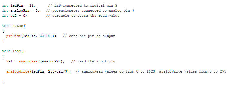

Example code :
// read the input on analog pin 0 ( You can use any pin from A0 to A5)
int Value = analogRead(A0);
Serial.println(value);
The above code gives an ADC value in between 0 to 1023

Step 15: LCD Display and LED Indication
LCD display :
A 20X4 char LCD is used for monitoring solar panel, battery and load parameters. For simplicity, an I2C LCD display is chosen. It needs only 4 wires to interface with the Arduino.In my earlier design the LCD was consuming a lot of power. The main cause was LCD backlight. So I add a push switch to control the backlight. By default the backlight will be in off condition. If the user presses the switch then it will on for 15 secs and again goes off.
Vcc--> 5V , GND-->GND, SDA-->A4 and SCL-->A5
Column-1: Solar panel voltage, Current and Power
Column-2: Battery Voltage, Charger state, and SOC
column-3: PWM duty cycle and load status
For testing the LCD download the test code attached bellow.

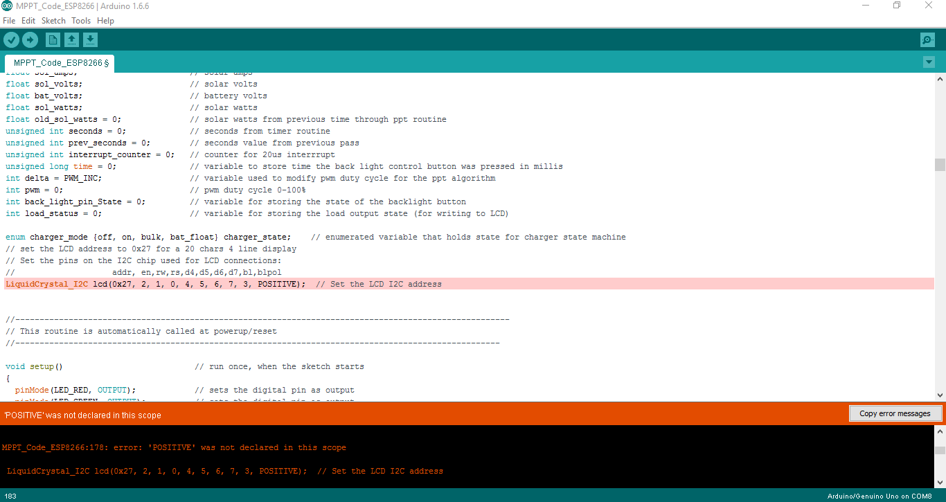

You download the library from LiquidCrystal_I2C .

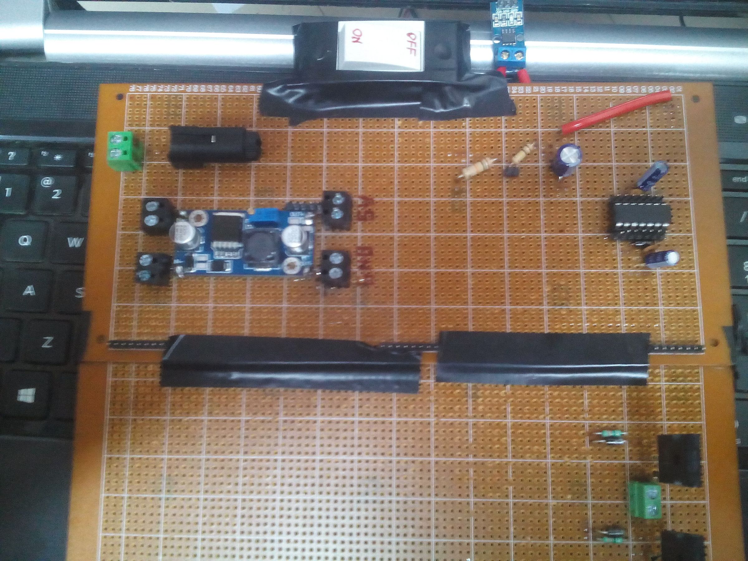

Step 22: Make the Power Supply
To run the Arduino ,different sensors,LED,LCD and the wifi module( ESP8266 ) we need power.
Except ESP8266 module all the others can be run by 5V power supply.The ES8266 module need power not more than 3.7V. It is recommended to run it on 3.3V. Though Arduino Nano have 3.3V pin but it can not provide sufficient power ( around 200mA to 300mA) to run the ESP8266 module.So we need a separate 3.3V power supply which can provide at least 300mA current.
5V Power Supply :
In my previous version I used a LM7805 linear voltage regulator to step down the battery voltage to 5V for the power supply.But it produces a lot of heat during its working.So I used a high efficient buck converter in this design.
Adjust the output voltage of buck converter :
First connect the battery on the input terminal of the buck converter and adjust the potentiometer to get 5V out put.
See the above picture.
Cut 4 pcs of male header with 2pins in each.Solder the headers as per the holes given in the converter.
Place the converter on the above 4 header pin and solder on the top.Be sure the input side is toward the battery screw terminal.
Add the output capacitor(C2) near to the battery screw terminal.The positive terminal of the capacitor should be on the left.
Then connect the input of the buck converter to the battery screw terminal and output to the 5V and GND pin of the Arduino Nano.At this stage you can check it.Place the Arduino nano on the header pin and connect the 12V battery to the screw terminal.If everything is correct then Arduino power led should glow.
Finally add two rows of male header pins to the side of Arduino 5V and GND pin for external connection.
3.3V Power Supply :
I am planning to use a voltage regulator AMS1117 to step down from 5V to 3.3V.
Solder the voltage regulator first, then add two 10uF capacitors. One on the input and other on the output side.
See the above schematic.
Step 23: Solder the Mosfet Driver Circuit
First solder the 8 pins DIP socket just above the arduino header pins.
Add 10uF capacitor and and a 0.1uF capacitor in between the pin-1 and pin-4.
Solder the diode (D2) in between pin -1 and 8.The diode cathode should be connect to the pin-8.
Solder the capacitor (C7) in between pin-8 and pin-6.
Solder two 200ohm resistors ( R7 and R8) just side to the pin-2 and pin-3.
Solder one 470K resistor (R1) near to the mosfet Q1 and a diode (D1) in between gates of mosfets Q1 and Q2.The diode cathode connects to the gate of Q1.
After this complete the circuit by soldering wires as per the schematics.

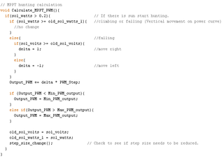

Step 39: Software and Algorithm
The Maximum Power Tracker uses an iterative approach to finding this constantly changing MPP. This iterative method is called Perterb and Observe or hill climbing algorithm.To achieve MPPT, the controller adjusts the voltage by a small amount from the solar panel and measures power, if the power increases, further adjustments in the direction are tried until power no longer increases.
The voltage to the solar panel is increased initially, if the output power increase, the voltage is continually increased until the output power starts decreasing. Once the output power starts decreasing, the voltage to the solar panel decreased until maximum power is reached. This process is continued until the MPPT is attained. This result is an oscillation of the output power around the MPP.
Dowload all the softwares from my GitHub page
https://github.com/deba168/MPPT_Master

Step 41: Overview of Version-3.1
After lot testing we observed that MOSFET ( Q3 ) in ver-3.0 design is burning repeatedly.We tried to modify the existing software but not find any satisfactory result.
The other problem was that MOSFET Q1 ( in V-3.0) conduct even when there is no solar input. To solve the above problems and enhance the power handling capability we are modifying both the hardware and software.This is named as Version-3.1 Charge Controller.
This version is not completed yet.So wait until it is complete.
Don't worry we are making a solution for those who have made the V-3.0 prototype.After little modification we will able to use the new software.
You can see the updates on Hackaday.com
This version have 3 options.
1. 5 Amp version :
T94-26 toroid, 48 turns of AWG20 wire to give 135 uH (it takes almost 1.5m of wire)
Q1, Q2 and Q3 all pairs of IRFZ44N MOSFETs (6 in all).
C1 will be 3 * 220 uF low ESR capacitors in parallel, C2 will be a single 220 uF low ESR capacitor
Single ACS712 on the panel side as per version 3.0
2. 8 Amp version :
T106-26 toroid wound with 23 turns of a compound wire made from 3 strands of AWG20 wire twisted together to give 47 uH (this takes about 3.1 m of wire).
Q2 will be a pair of FDP150N10A MOSFETs in parallel.
C1 will be 5 * 220 uF low ESR capacitors in parallel,C2 will be a single 220 uF low ESR capacitor
Two ACS712, one on the panel side as per version 3.0 and one in series with the battery.
3 10 Amp version :
T130-26 toroid wound with 23 turns of a compound wire made from 4 strands of AWG18 wire twisted together to give 41 uH (this takes about 4.5 m of wire).
C1 will be 6 * 220 uF low ESR capacitors in parallel,C2 will be 2 * 220 uF low ESR capacitors in parallel.
Three ACS712, one on the panel side as per version 3.0, one in series with the battery and one in series with the load.
The drive circuitry (common to all 3 versions) will use 3 separate IR2104 driver chips, one for each of Q1, Q2 and Q3. We drive the Q1 and Q2 drivers from pin D9 and HO1 and HO2, and drive Q3 from pin D10 and LO3.
In driver chips 1 and 2, pins IN and SD are driven in parallel by Arduino output pin D9. In the case of driver 1 (for Q1) there is a low pass RC filter in series, with a time constant of about 1 ms. Driver 2 is driven directly (as in the current circuit, but probably with a slightly higher series resistor to allow more current for the Q1 driver and its RC filter).
In driver chip 3, IN is driven by D9 and SD is driven by D10.
The purpose of using separate drivers for Q2 and Q3 is to enable us to switch Q3 OFF to operate in Asynchronous mode at low current levels when the controller will be in DCM (Discontinuous Current Mode). There may be a better way to do this but in the short time we have available this is a simple option and easy and reliable to implement.
All 3 versions should have LCD displays, WiFi, LED indicators (maybe with a more fancy coding scheme to separately indicate DCM and CCM).
All 3 versions should be able to cope with either 18 V or 30 V panels, and use algorithms that stop them burning out if the panel can produce more current than the rating allows. This can all be done auto-detect.
All the components exposed to panel voltage need to be rated for at least 40 V (in particular C1 and our buck converter to generate 12V for the drivers and to power the control electronics.

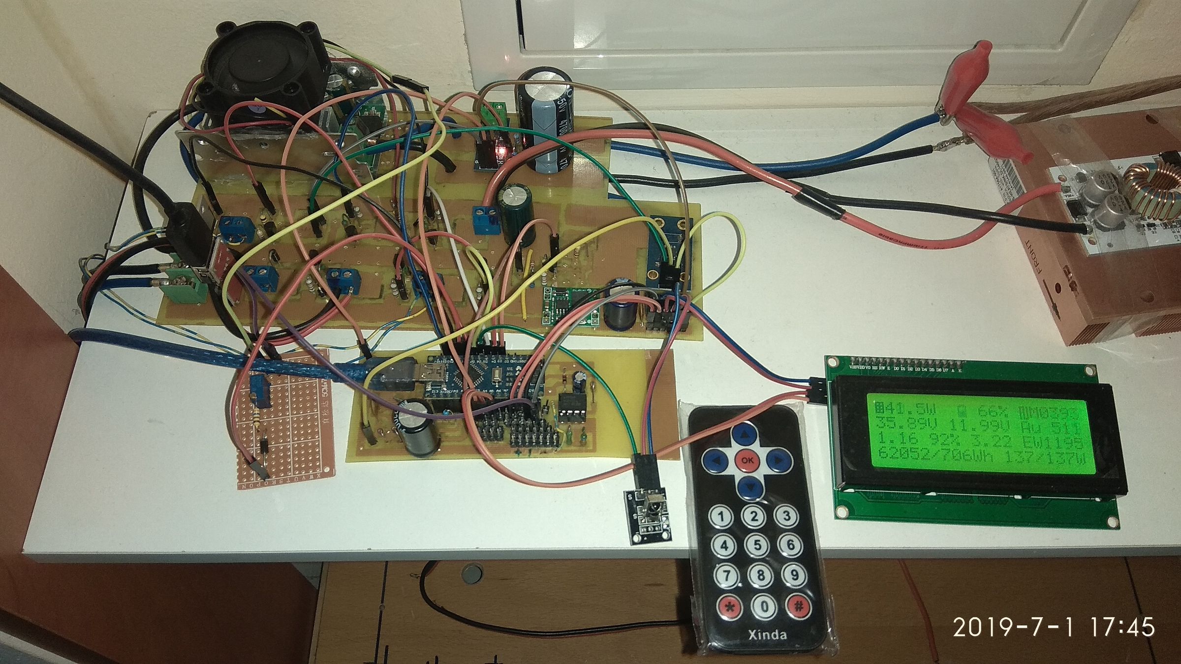

Hello All,
I have two things to share:

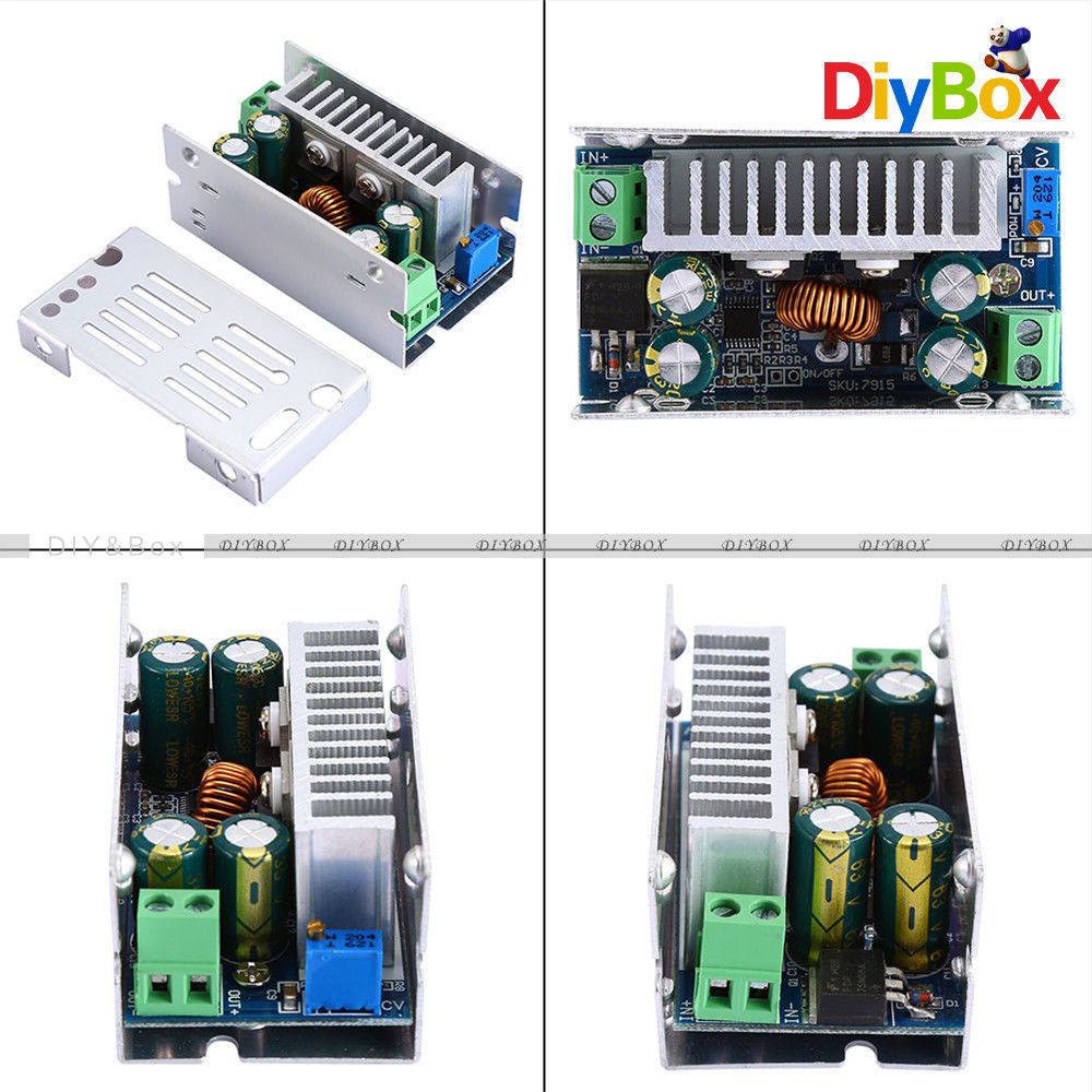

I. Maybe worth to check and try this to prevent burning MOSFET: http://tahmidmc.blogspot.nl/2012/10/magic-of-knowl...

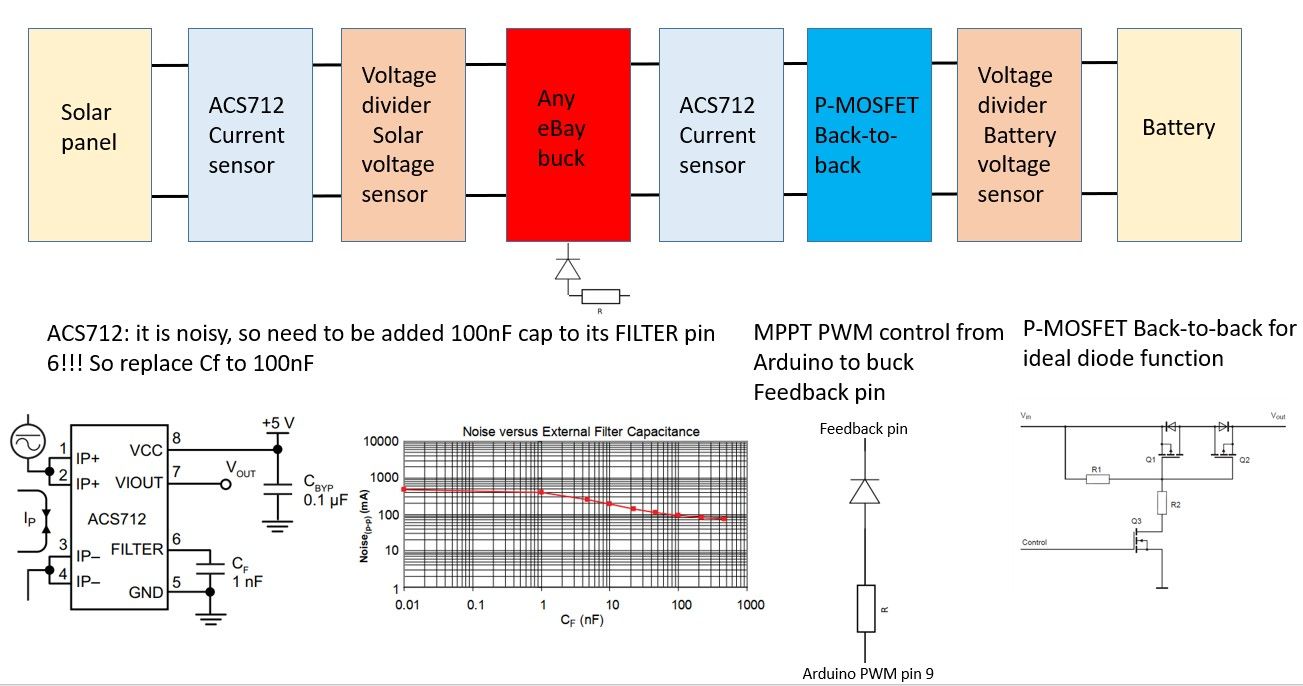

II. I originally build the circuit discussed by deba168, but I as well had issues (did not try yet the modification from upper link). So finally I modified LOT of things and now it works great, and it is simple (and is non-syncronous...). Modifications:
1. I bought from eBay this nonsyncronous Buck converter and asked than for refund, as there are usually based on XL4016 IC, which is not 12A, but 8A...;) Still, up to around 9-10A you can use it and it costed 0 USD :)
http://www.ebay.com/itm/DC-DC-CC-CV-Buck-Converter...
I am charging Li-ion battery pack (10x7.2Ah).
2. I am manipulating via simple analogWrite command on default 490Hz (pin D11) the FB pin of XL4016 of Buck through a diode and 150 ohm resistor. Buck has a cooling fan what above 4A turns on.
3. As I want to get the most power NOT from just the Solar panel, BUT from the entire system (solar+buck), I am tracking "mppt_track = buck_amps * sol_volts" (I have ACS712 on output of the buck as well). So with this, system track the MPP of the solar+buck as well.
MPPT algorithm and Mode selection is very simple.
4. I built an Ideal diode based on LTC4412 (ordered as sample), see the solution in this pdf: http://www.linear.com/solutions/1464
5. Energy meter, with long term and daily Wh feature is in as well, measures daily and long term peak W, peak buck amp, etc. See LCD on attached pictures.
I have added an "MPPT test" void as well, which stops all, and runs an MPPT test to find on-demand again the MPP point - if for any rason you want to check it.
6. To mine solution I have added some home automation as well: controls night light, air cleaning fan speed (On, Silent, Manual, AutoSpeed, Off), will soon add temp and humidity sensor as well and RTC module to turn on-off at pre-defined time the Wifi router, etc.
7. ACS712 current sensors eBay modules are pretty noisy as they come, so you should replace on its board one capacitor to get more stable value out of it. Check this video for details: https://www.youtube.com/watch?v=etsIFUUhO6I&t=300s

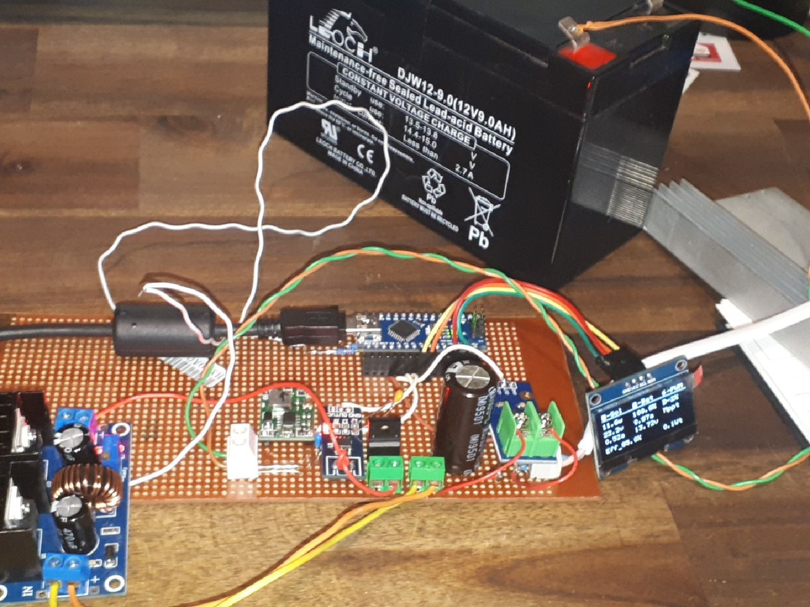

My below pictures shows a mess, but it will be like this for a while due to continous running improvements. Complete Sketch attached (comments in it are not always updated at the moment).
Just wanted to share with you mine ideas and my progress status, so we can keep running this project. :)
UPDATE: latest sketch and topology and pictures are downloadable from here: https://drive.google.com/drive/folders/1rfiY4_HDN573c92Fg2QqoRR5bDoQgCeF?usp=sharing

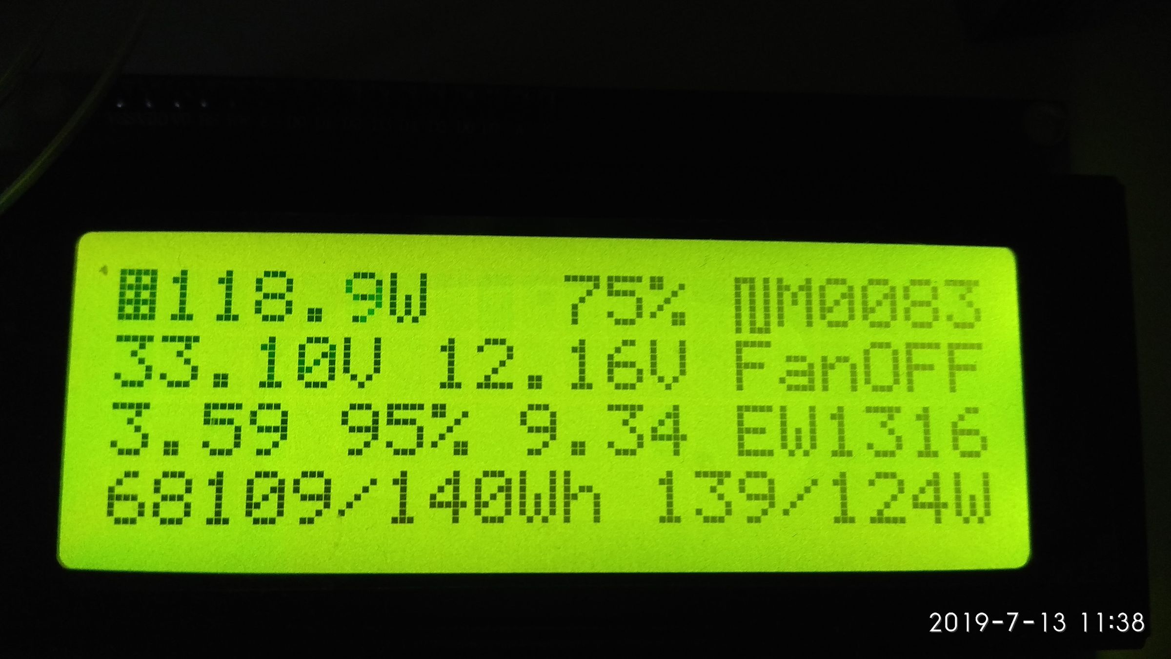

I am using now this "200W 15A DC-DC 8-60V TO 1-36V Synchronous Buck Converter" Module: https://www.ebay.com/itm/200W-15A-DC-DC-8-60V-TO-1-36V-Synchronous-Buck-Converter-Step-down-Module/112985055478?hash=item1a4e6f20f6:g:XCsAAOSwCx5bpfkX
On one of the picture you can see, that system worked with aprox 95% efficiency at the moment when photo was taken: converted Solar panels 33.10V and 3.59A to 12.16V and 9.34A to charge the battery.

Reply 2 years ago
thank you for your reply it's very helpful.
i have a question please, I want just to simulate a duty cycle under isis proteus using a potentiometer.
that is my schema and Arduino code.
the simulation of a duty cycle doesn't correct as you can see in the picture for d=50%
ton> toff
0
zopinter
zopinter
Reply 2 years ago
Its a simple math: potentiometer at its half state will provide val = 512 and than you make (255-val/3) which is around 85, so it is definately not 50%, not 127...
use this better in the loop:
val = analogRead(analogPin);
int pwm = map(val, 0, 1023, 0, 255);
analogWrite (ledPin, pwm);
0
hicham01
hicham01
Reply 2 years ago
thank you for your reply, Actually, I tried also with this code but i don't get a good duty cycle.
i don't know why
