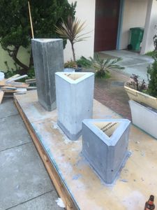

Pedestals:
  • Pedestals forms were fabricated based on a simple triangular module set at three different heights. Molds were made from 2x4 lumber and particle board. We kept the core hollow by placing a sono tube in the center. Total cure time was approximately 1 week.
  • After curing we cnc routed seat tops out of plywood and adhered it to the concrete with construction adhesive. We cut additional top material out of cork and recycled rubber to provide a variety of textures and colors, and attached those to the seat tops with adhesive as well.

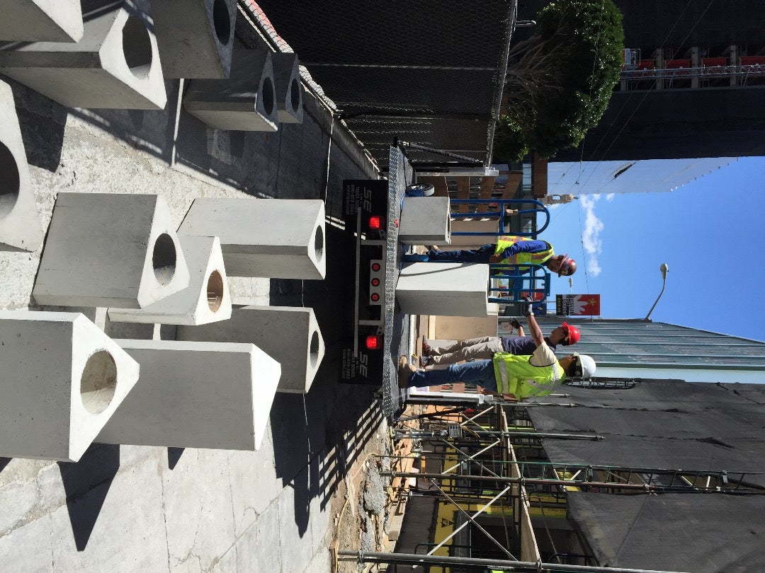

Step 4: Installation
Since the majority of the elements were fabricated into separate parts, installation was fairly easy on the day of the festival. The table, composed of (2) table top halves and then an isolated base, were transported to the site via a rental truck and was assembled fairly quickly once unloaded. Our partner GC took care of the delivery of the concrete pedestals. To aid in installation, we created a key plan of the site with the table and all the pedestal modules identified and then taped up the site with these locations prior to delivery. With the help of 15 volunteers and the promise of free pizza, everything quickly went into position without much hassle.
