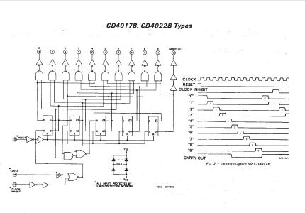

The idea is to use the Schmitt CLOCK input as the Battery level sense and code the sequencer output to give an 8 bit ASCII code.
Looking at the 4017 block diagram shows that the CLOCK INHIBIT can be used as a CLOCK input. The outputs will need to be combined with isolating diodes.
Step 2: Explanation
The 4017 has 10 outputs meaning that a START bit, 1 parity, 7 character bits and a STOP bit can be sent and the 555 timer would be set to give the Bit Rate desired.
Any ASCII character can be set by placing a diode in each position when a SPACE (low) is wanted: I thought the "BELL" character was the obvious character to send but bear in mind that it will continue being sent until the battery is fully exhausted or removed!
The ASCII bell character's value is 7 ( 0000111) and is named "BELL" or "BEL".
