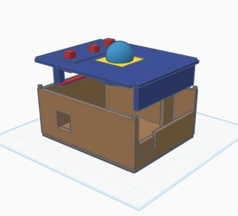

Step 3: Soldering the Prototyping Board
The soldering can be done as shown.
Step 4: Assembly
Given the soldered final board, plug the Raspberry Pie into the headers.
