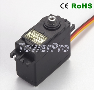

  2. 4x MG995
  3. High Torque Continous Rotation Servo
  4. I would instead get another MG995 if I were to make this again. I didn't have on on hand unfortunately. (Will require you to edit hand file)
