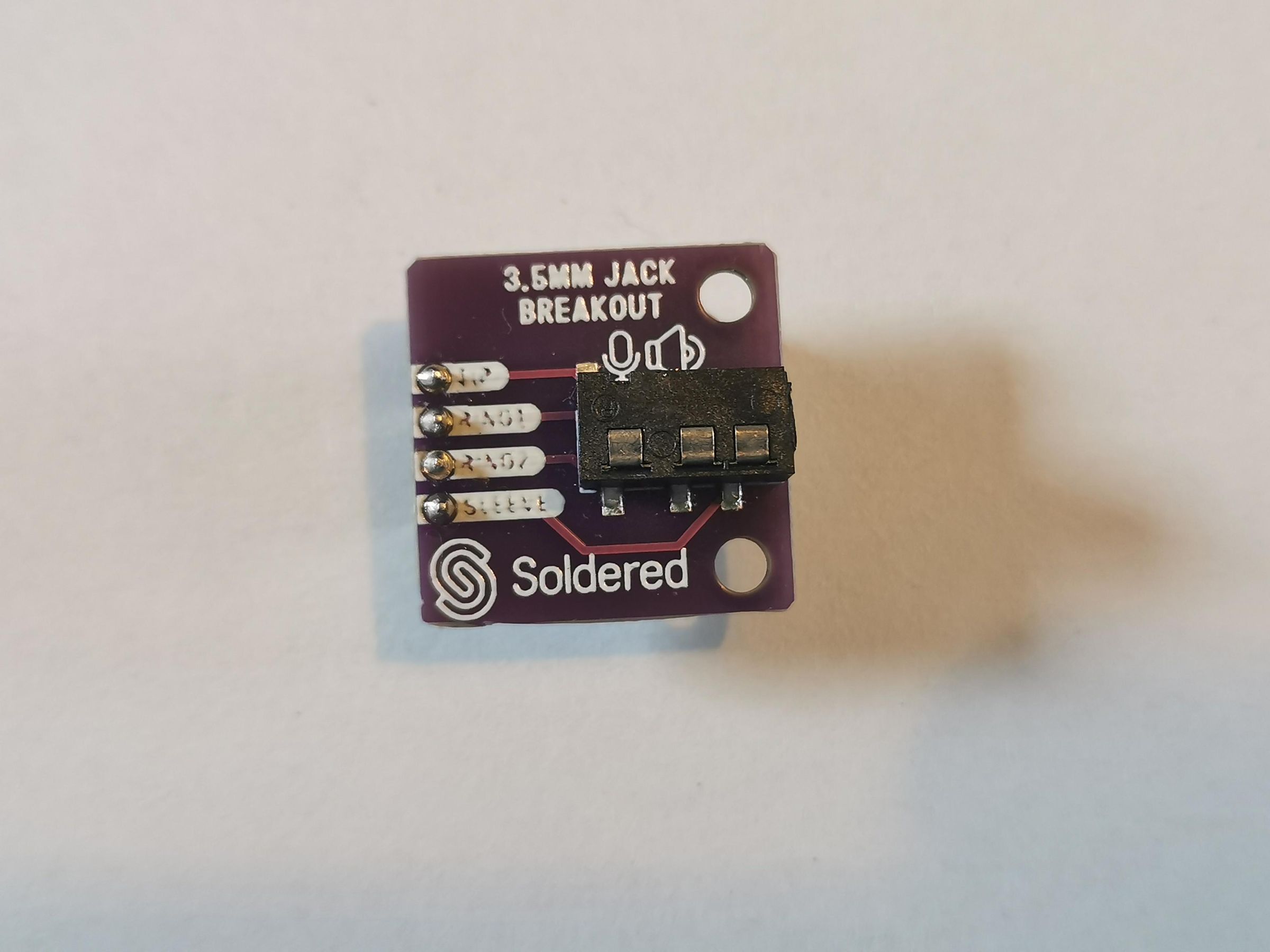

  • 1 × 3.5mm jack breakout

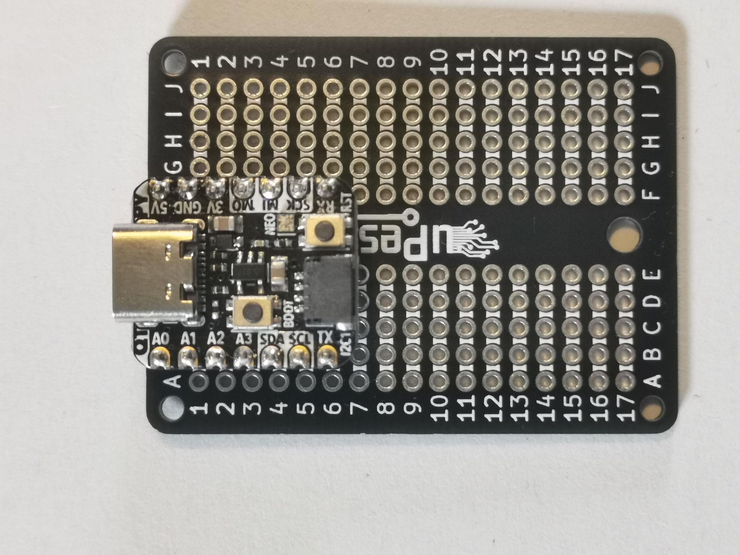

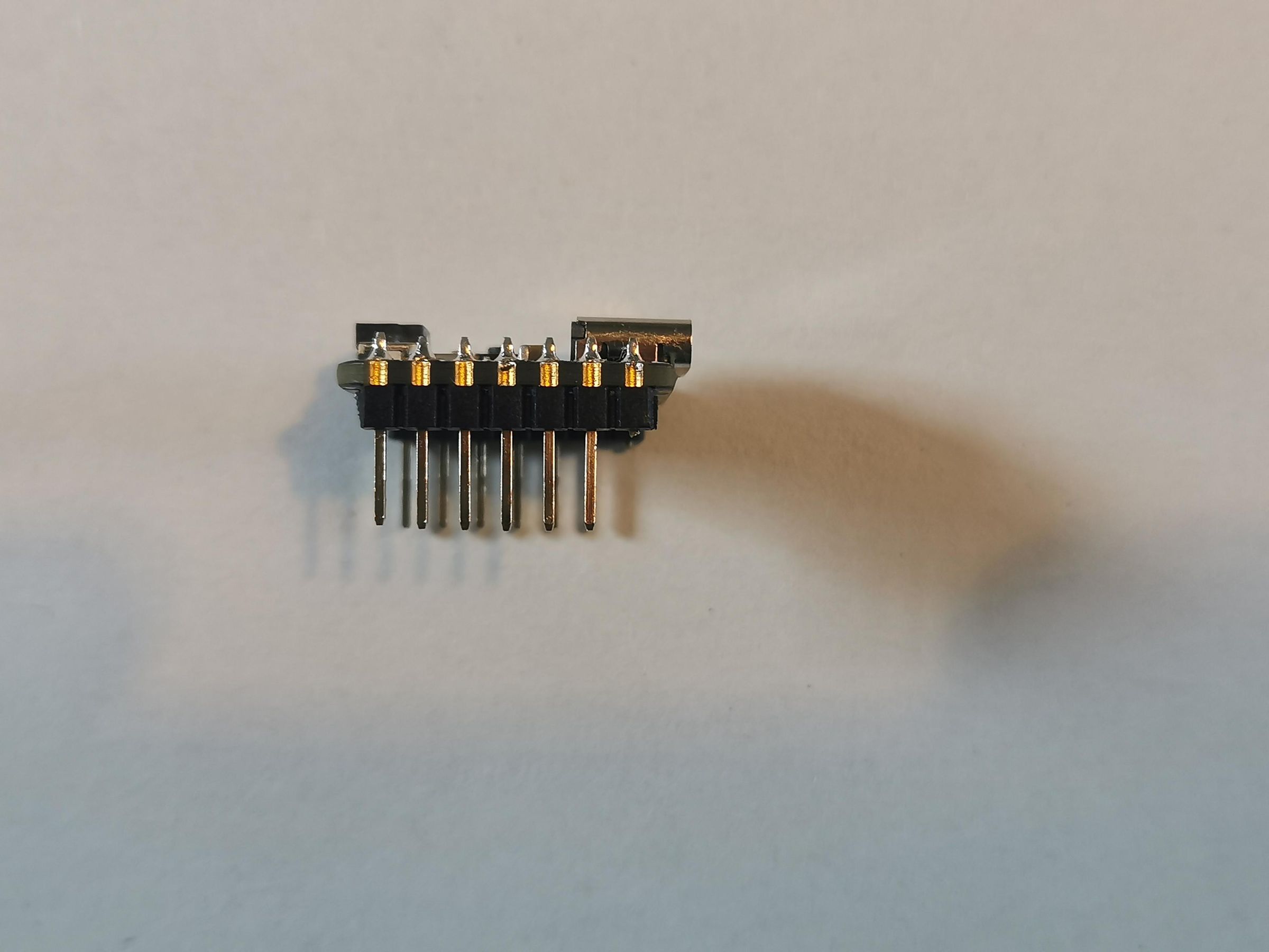

  • Solder 2*6 headers on the ADAFRUIT QTPY RP2040 (pins A1--TX and RX--GND)
  • Solder 2 headers on the 3.5mm jack breakout (pin TIP ans SLEEVE)

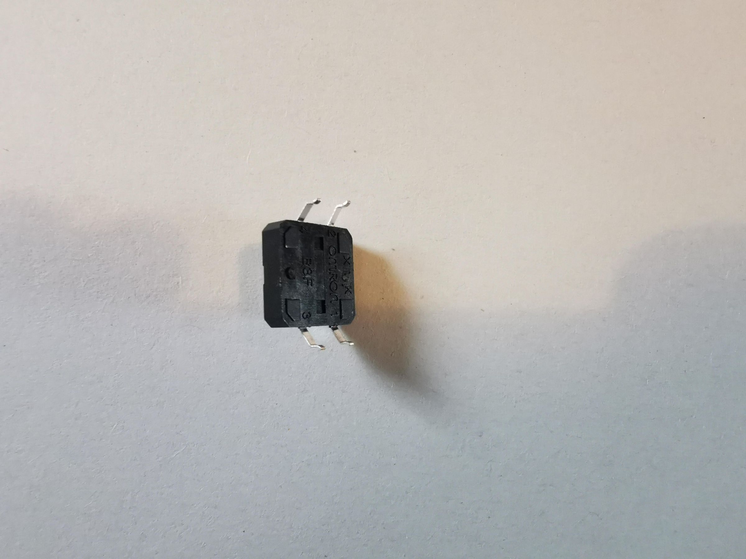

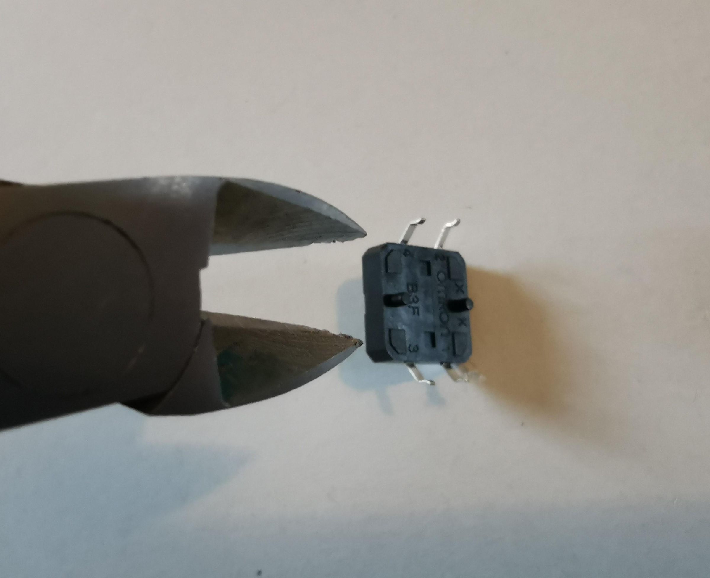

  • Cut two platsic pins under the tactile switch, cut two pins on the switch

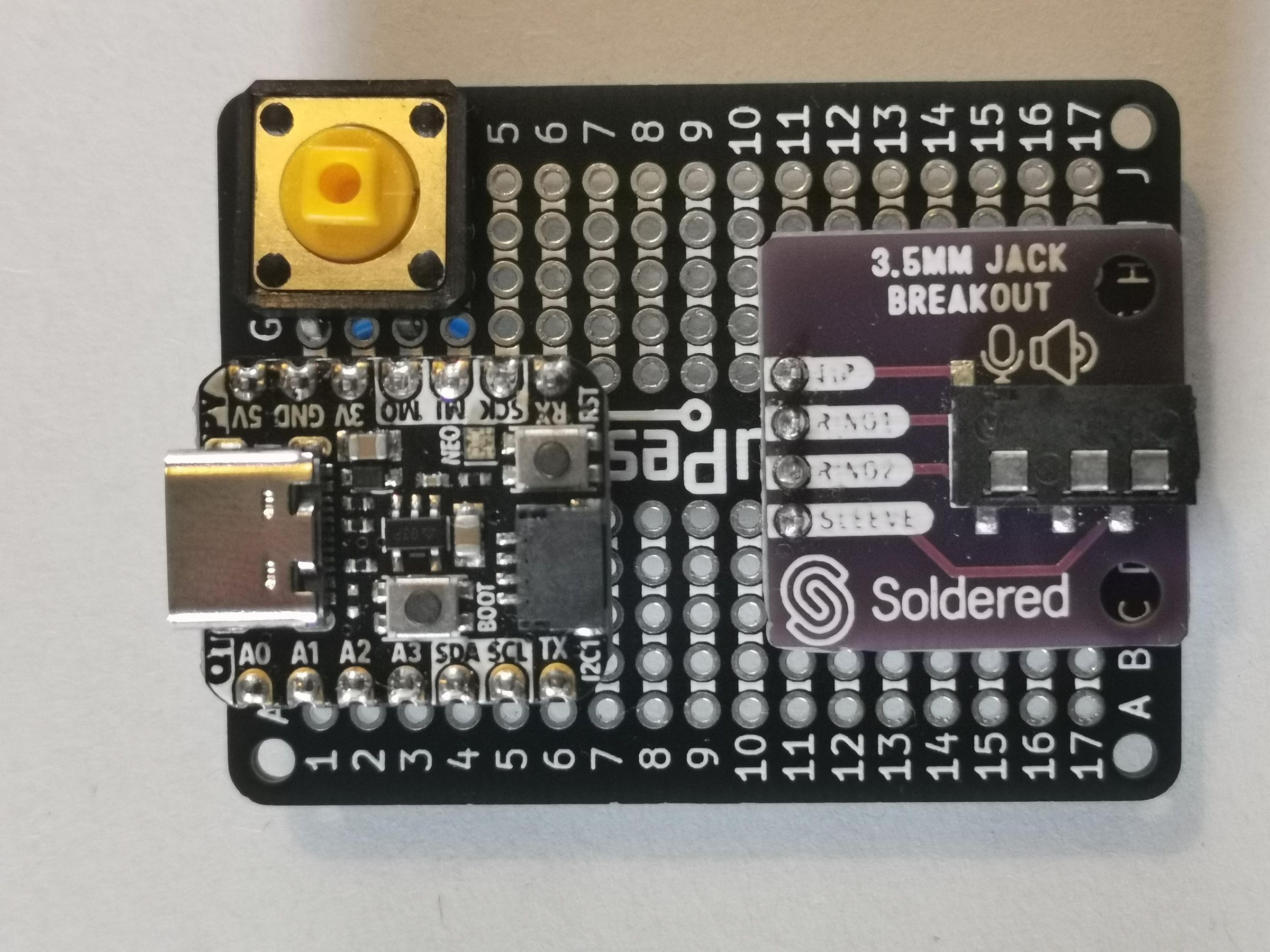

Solder the components :

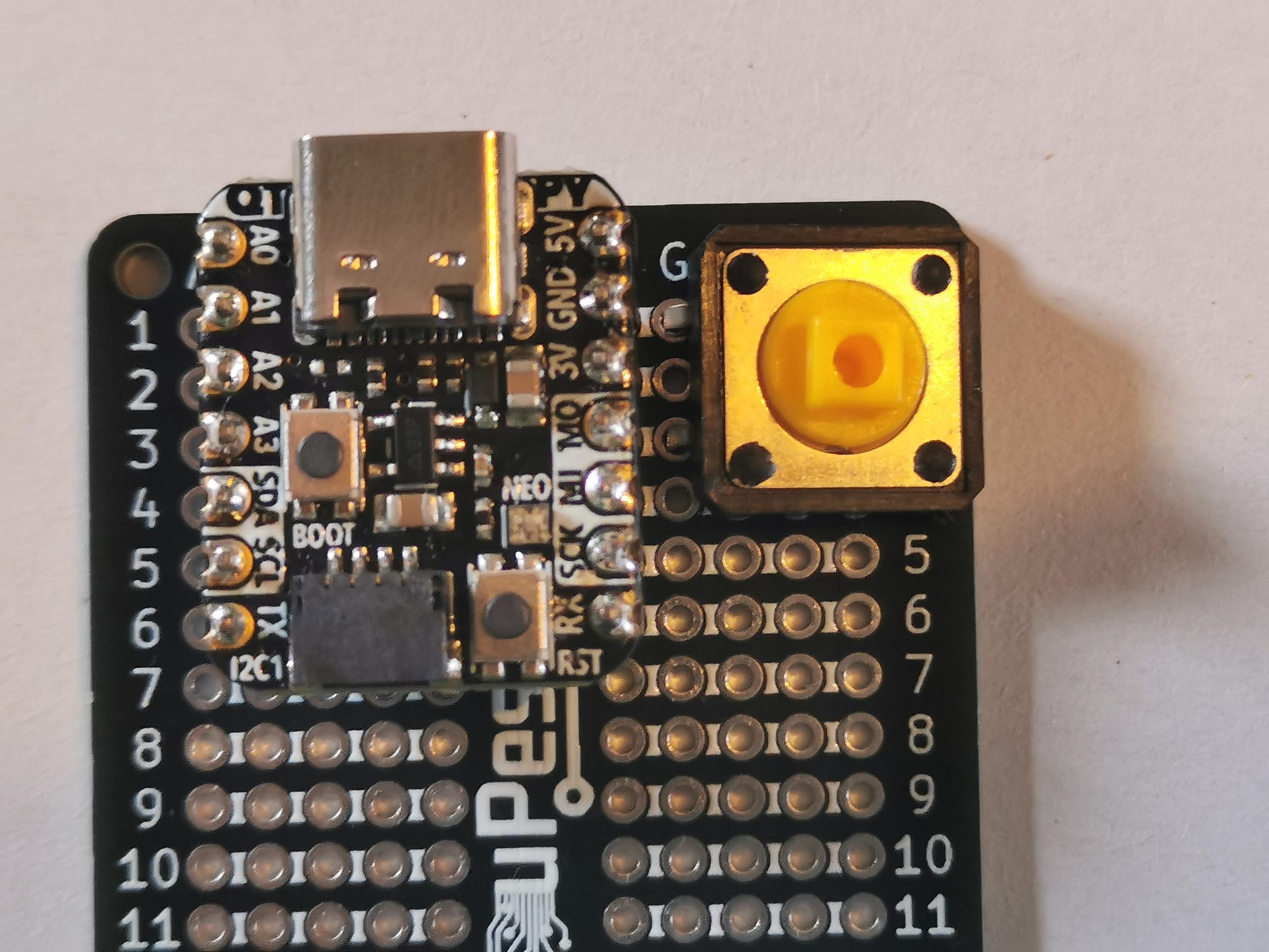

  • Solder the ADAFRUIT QTPY RP2040 on the protoboard : B1 to B6 and F1 to F6)
  • Solder the tactile switch on the protoboard G1 and G3
  • Solder the 3.5mm jack breakout (F11 and E11)
  • Connect A3 QTPY's pin to RING02 with the 3.5 cm wire, solder
  • Connect GND QTPY's to TIP with the 4cm wire, (J1- J11), solder
Cut of the excess lenght of the pins
