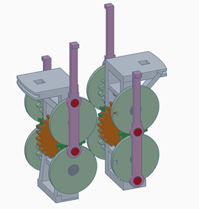

1-Leg mechanism
All 4 legs are powered by a single N20 motor that is connected very intricately with gears to rotate both clockwise and counter clockwise to help with a smooth rotation.

Step 5: Assembly - Leg Gear Mount
The leg assembly is a bit tricky with the center gear but if done properly its not that hard
The center gear needs 2 spacers in between the 24 teeth gear before inserting the middle beam. add lubricant on the holes for smoother rotations.
At the end of each side will insert the 12 teeth gear
When adding the 4 outer gears make sure the holes align on each side.. the holes should be opposite each other on left and right side of the mount.
When adding the leg hook.. make sure the hook is facing outward and insert the small pins too hold them.
You'll need to make 2 sets of the mount for the front and back legs. the leg hooks should be also opposite each other from the front and back legs. So that when the front right leg is raised.. the back right leg is on the ground and vice versa.
Add the nut at the bottom of the mount and screw it onto the base

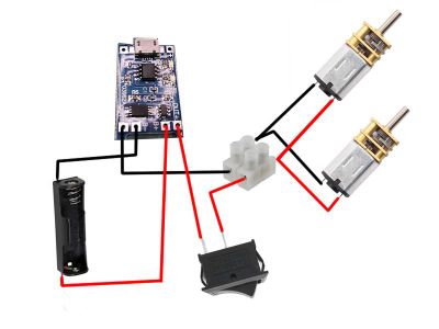

Step 7: Assembly - USB Powerbank and Motor Wiring
Just follow the wiring diagram and you should be golden.
Solder 2 wires to the rocker first and install it onto the base
Then solder all 4 wires from battery and connector block to the USB dc charger board following the diagram
Once done.. hotglue the USB board and connector block to the base
Make sure no wires are tangled into the gears
Install a lithium battery 18650 and test it out. you might want to test charge it as well.. A led light should light up if your charging.
Once everything checks out, take out the battery to be safe.
