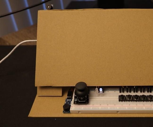

Step 2: Connect the Potentiometer
connect the potentiometer with the power, ground, and analog input on the Arduino.
The power supply should be the highest voltage output on your Arduino which is 5V.
Step 3: Connect Button
Connect button with power with the button, and ground it with a resistor.
Connect a digital input on Arduino to the button.
Step 4: Connect the LED
Connect the LED with a PWM output on the board and ground it with a resistor.
(My resistor's resistance is too low so I'm using two resistors here.)
Step 5: Add Code
If the code is running correctly, you should able to control the LED with a button and potentiometer.
The button should able to control On and Off, and the potentiometer should able to control the brightness.
