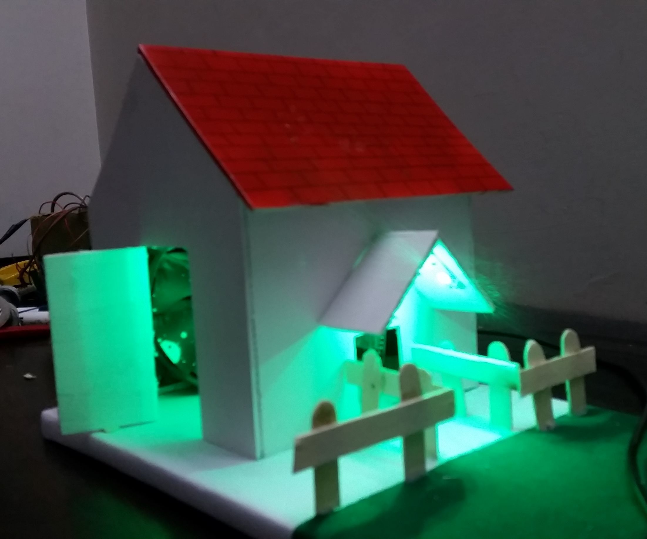

Introduction: ATM Machine Using Arduino (Finger-print+RFID Card)
Hello friends ,I come back with new idea of ATM machine using Arduino .It can be helpful in rural areas where cashless services are not possible.It is a little idea .I hope you enjoyed it.
Let get started............

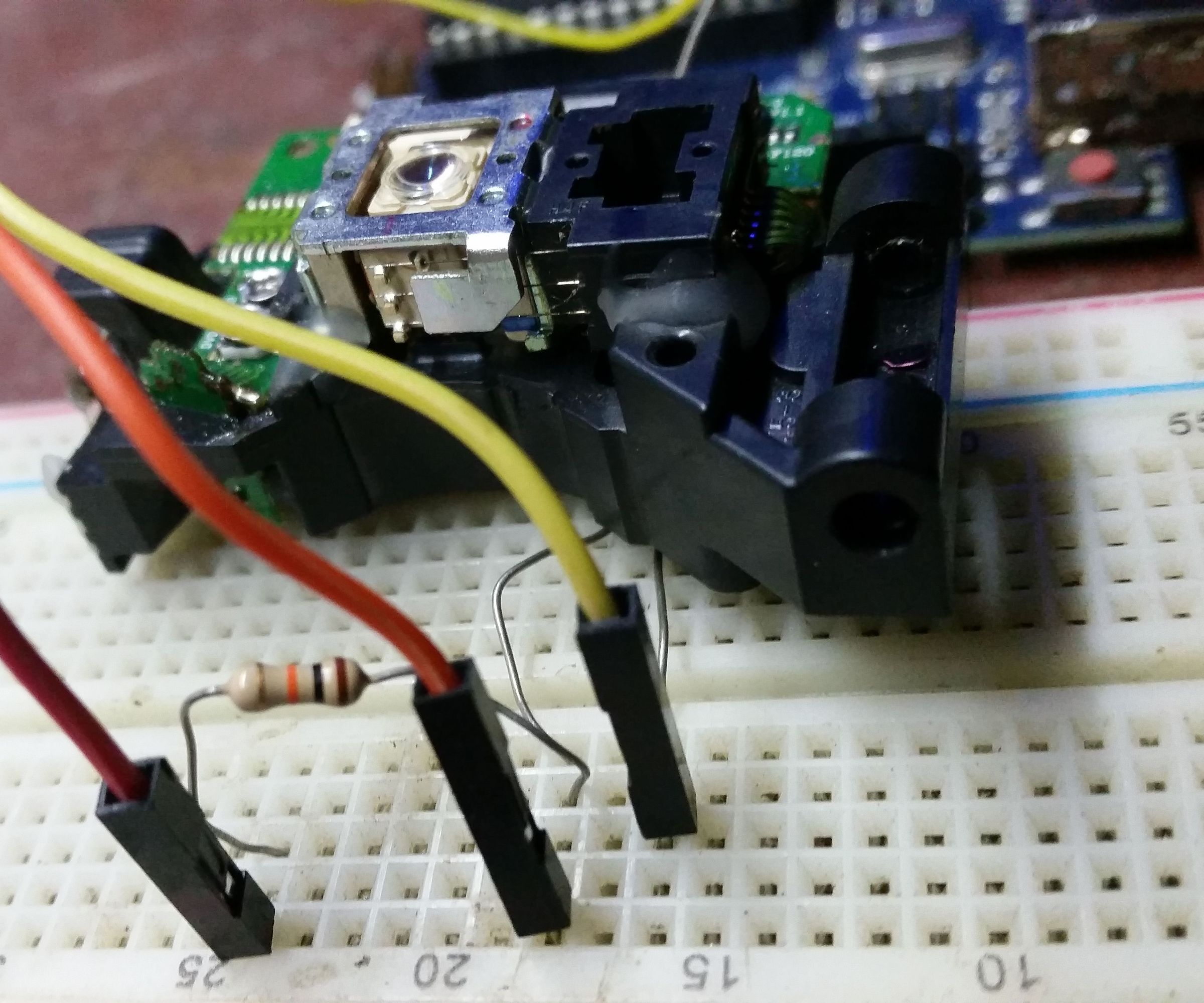

Finger-print scanner Module(GT511).

Step 4: Circuit Diagram
The circuit diagram shown in figure:
i add isis design for simulation
