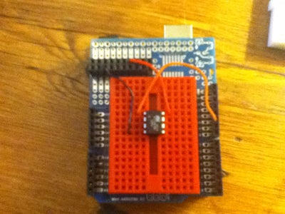

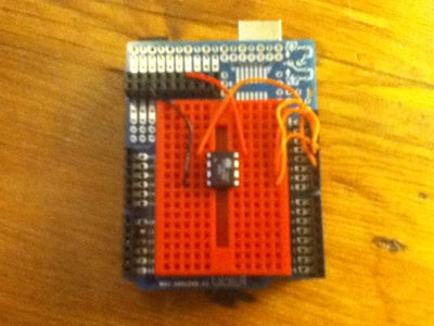

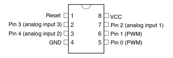

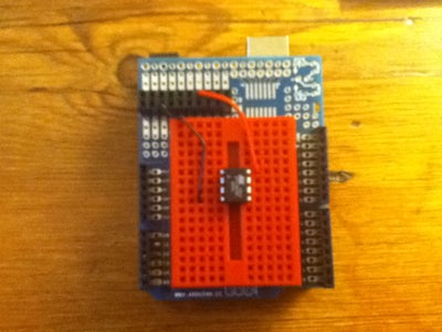

Step 2: Connecting the ATTiny to Arduino
The ATTiny pins are numbered in picture 1.
Start by connecting ATTiny pin 4 to Ground.
Connect ATTiny pin 8 to +5V.
Next, connect the following cables from the ATTiny to Arduino:
ATTiny pin 1 to Arduino pin 10,
ATTiny pin 5 to Arduino pin 11,
ATTiny pin 6 to Arduino pin 12,
ATTiny pin 7 to Arduino pin 13.
In some cases such as using the new Uno boards, ou will need to connect a 10 microfared capacitor from the Arduino reset pin to Ground. Make sure the capacitor ground (-) is connected to round as it is polarised. In my case everything works just fine without one, but there may be some issues that I'm not aware of. If anyone is aware of any then please post them in the comments.
You are now good to go, next is the programming!

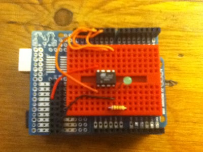

Step 3: Programming the ATTiny85 With a Test Program
** Using Arduino 1.0 IDE with this method doesn't work. Download version 22 or 23 of the IDE and try this method. **

Next, load the Blink example from the Examples -> Basics menu. Remember that the ATTiny does not have the same pins as an Arduino board, so refer to the image above. Every time you see pin 13 in the exampls, replace it with a pin of your choice. Simply connect an LED to this pin with an appropriate resistor and connect the ground lead of the LED to Ground.
Simply press "Upload to I/O Board" and the program will be uploaded and the LED should flash!
You may see errors telling you to define PAGEL and BS2 signals but you can ignore these, It works just fine.
At this stage you could remove the chip from the breadboard and power it with 2 AA batteries and it would work on its own.

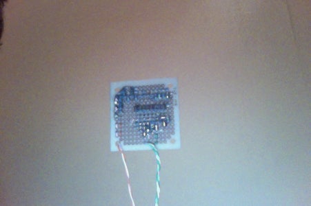

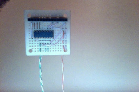

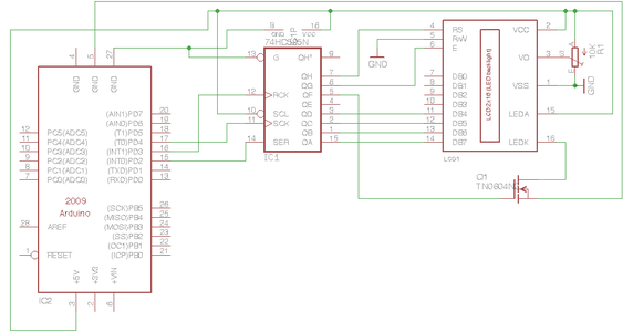

Step 4: Building the Shift Register LCD Controller
To build the shift register to LCD circuit, use the schematic found in Image 1 above.
This circuit was not developed by me, but I got it from this blog post.
You can build it on a breadboard, but I soldered it on some board.
You can see some pictures of my board above.

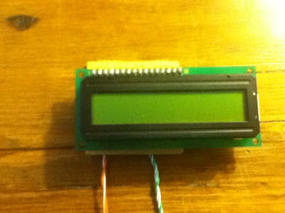

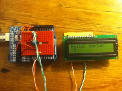

Step 5: Connecting the LCD Controller to the ATTiny
To connect the LCD controller to the ATTiny,
Connect Shift Register pin 11 to ATTiny I/O pin 2 (actual pin 7)
Connect Shift Register pin 12 to ATTiny I/O pin 1 (actual pin 6)
Connect Shift Register pin 14 to ATTiny I/O pin 0 (actual pin 5).
Make sure the LCD and shift registers are connected to +5V and Ground (in previous step)

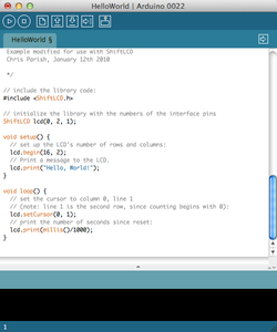

Step 6: Programming the ATTiny With the ShiftLCD Library Code
You will need to install the ShiftLCD Arduino library for the ATTiny. To find out how to get this setup, read here.
Once the library is installed, open the Arduino IDE and load the "HelloWorld" ShiftLCD example from the "Examples", "ShiftLCD" menu.
You will need to modify the pinout for the ATTiny and your shift register. In the part of the code that says the following:
ShiftLCD lcd(2, 4, 3);
Replace it with the following, or whatever pins you connected to the ATTiny:
ShiftLCD lcd(0, 2, 1);
Now all you need to do is upload the program to the ATTiny.

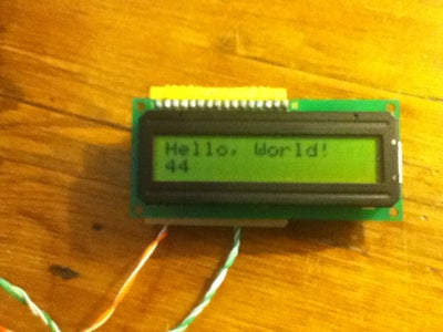

Step 7: Testing!
If everything went to plan, you should now see "Hello World" on your LCD and a counter on line 2 that increments every second.
The ShiftLCD is exactly the same as the built in LiquidCrystal library. All functions are exactly the same and everything works on the ATTiny. However, the speed that the LCD can be written at is slower. It will take about 250ms to fill an entire 2x16 LCD with characters.
However, it is pretty quick for only replacing a few digits with the setCursor function.
