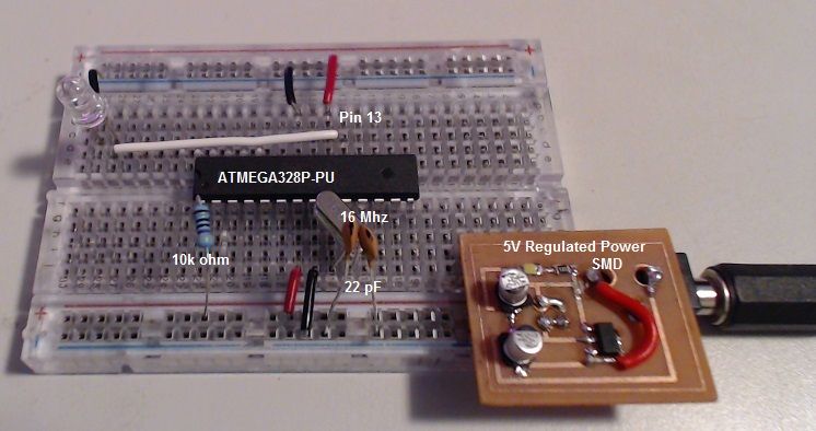

The above breadboard image is an annotated photo of the prototype that I put together ... this was the easiest bit.

Step 1: Breadboard Prototype
The three ATTiny84 chips are set into the breadboard so that there are 5 holes separating them and so that the Vcc and GND pins (1 and 14) are lined up with the rail holes.
I've jumpered the two RED and BLUE rails together across the board so that I can access the rail closest to the pin.
Pin 14 on the three ATTiny84 are connected to the BLUE rail, and Pin 1 is connected to the RED rail.
The
Pin 13 of the ATTiny84 is connected (with the yellow jumper) to the anode of the LED and the cathode of the LED is connected to the BLUE rail via a 220 ohm resistor.
The SCL of the ATTiny84 (pin 9) are brought together (green wire) and connected to the RED rail via a 4.7k ohm resistor.
The SDA of the ATTiny84 (pin 7) are also brought together (blue wire) and connected to the RED rail via a 4.7 k ohm resistor.
The Arduino is connected to the breadboard as follows:
5V is connected to the RED rail, GND is connected to the BLUE rail. Analog 5 (A5) of the Arduino is connected to the SCL jumpers and Analog 4 (A4) is connected to the SDA jumpers.
This gives us a nice I2C network with the ATTiny84 clock and the Data line communicating with the Arduino to it's compatible pins. The other important shared wires in I2C are the power and ground ...
If you follow the breadboard layout image, you'd be just fine. You can ignore the pin headers in the diagram, they are for a PCB implementation (which I'll show you later).
