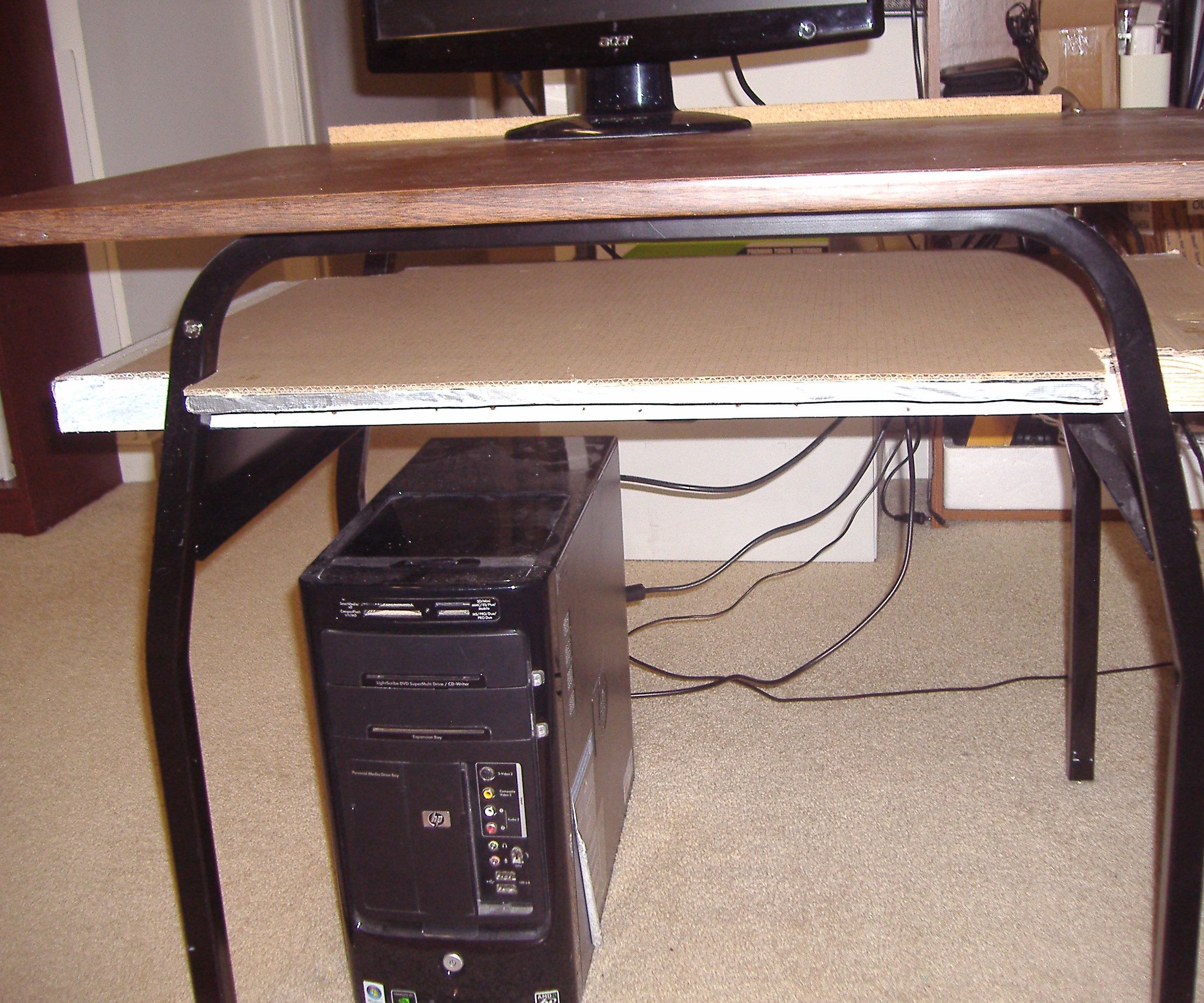

I like to do electronics as a hobby and have a nice workspace that I made from a discarded PC. It contains a soldering holder and soldering iron (upper right corner of the workspace picture). It happens that I don't have a handy way to turn it on and off, so I plug it into a power strip behind my workspace. I'm never really sure if it is on or not. I thought if I could just measure the temperature near the soldering iron and have some kind of alert, I would know if it is on or not. (Yes, yes, I could spend my time figuring out a failsafe switching system, but I don't have the ingenuity for that.)
So, I came up with this project. OK, I know. There are hundreds, if not thousands of electronic temperature measuring devices made with Arduino and with 555 Timers. The problem is that I could not find one to do my specific job. I just wanted something that would tell me that my soldering iron is on and hot. Something that warns me to turn it off, if I go somewhere else. Really, just something to tell me if it is on. This project is for a device that measures only one thing is the temperature above (or below, if you wish) a certain point. It's a "mono" temperature monitor. It only measures ONE thing.
