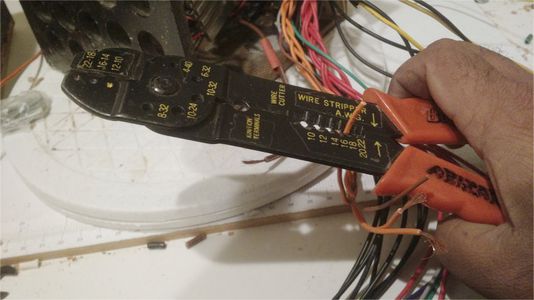

  7. The plugs at the end of the DC wires from the ATX board were cut off and the wires were bundled together by color.
  8. The 3-way binding posts were selected to match the wire colors so hopefully the wiring would be a bit easier.
  9. The orange wires were braided together, ends stripped and soldered to a ring terminal.
  10. The red wires were also bundled together and soldered to a separate ring terminal.
  11. One red and black wire pair was kept separate to power the volt-amp meters.
  12. One black wire was saved for one end of a power resistor in the output. In the previous PSU conversion, the power supply would shut down if there was no load across it therefore the resistor in the output.
  13. Another two black wires would connect to the DC on switch and to the DC on LED.
  14. I started attaching the single wires for the -12V (blue) and -5V (white) to their respective binding posts.
  15. Then attached the orange 3.3V bundle to the orange (yellow right now but ...) binding post.
  16. The red 5V bundle to the red binding post.
  17. The DC-on switch was connected to the green and black wires from the ATX board.
  18. The +ve terminal of the DC-on LED was connected through a 330 ohm resistor to the gray wire from the ATX board and the other end of the end was connected to a black wire.
  19. The remaining black wires were bundled together and soldered to a ring terminal and then attached to the black binding post.

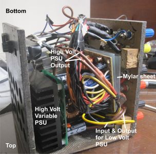

Tried different locations to place the two power modules in the 6 inch cube till finally found two suitable locations. One on the top panel for the low voltage module; and right next to the fan on the rear panel for the high voltage module. The DC in and the DC out wires were carefully threaded through the empty spaces to the power modules and then attached to the corresponding terminals. The shielded audio cable that I had used for the pots was then passed under the bottom of the ATX board and the pots were placed into their corresponding holes in the front panel and nuts were used to attach them to the front panel.
The volt-amp meter sense wires were attached as below (see the wiring diagram)
Thin yellow wire from the meter for the low voltage variable supply went to the low voltage red binding post. Another wire from this red binding post went to the + output of the low voltage supply. The negative output of the low voltage supply was soldered to the thick red wire of the volt-amp meter. The thick black wire from the volt-amp-meter was connected the black binding post of the low voltage supply.
The high-voltage module was wired similarly to its set of binding posts and volt-amp meter. Red binding post connected to yellow wire from volt-amp meter and to + output screw terminal of the high voltage module. Black binding post connected to the thick black wire from the volt-amp meter. Negative output from the high voltage module connected to the thick red wire of the volt-amp meter,
The modules were tested again.
The low voltage module was held in place with a screw. The high voltage panel was held in place with double sided tapes and hot glue. To be safe, a wooden support block was also added to hold the high voltage module in place.
The ATX board was then attached to the front panel with screws into wooden standoffs. A folded sheet of plastic was used between the board and the front panel to prevent any electrical mis-connections.
One more functional check.
The final set of images show how tightly packed all the components are. Electrical tape definitely required to keep the wires under control.
