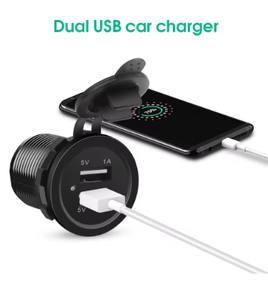

USB x2 ports 3A ( 1 + 2.1) rating

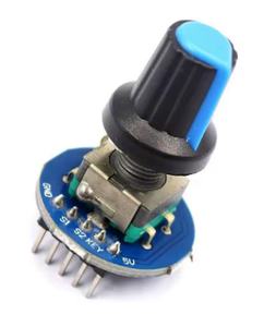

Rotary encoder with push switch

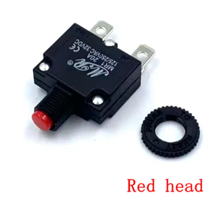

3 x 10 Amp circuit breakers
1 X 3 Amp circuit breaker
1 x 5 Amp circuit breakers

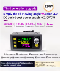

SK120 120W DC Buck Boost Converter

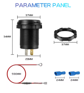

3.1A 12V Dual USB Car Charger port
