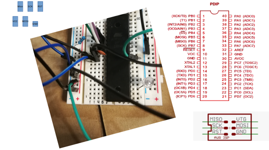

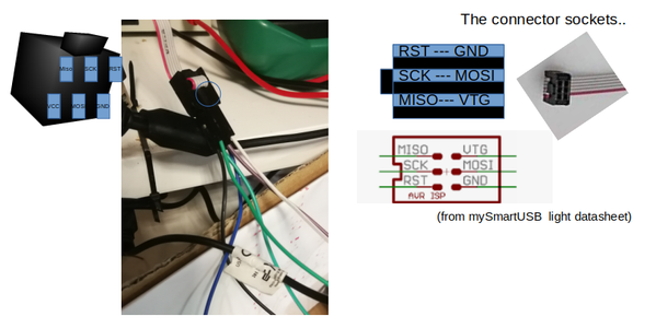

Step 4: Connect 5V and the Programmer to Atmega32
  • I connected the programmer (smart usb light) and 5v to the atmega32.
  • I don't use a capacitor and I don't use a resistor. Because I don't know why it should be useful
  • I will google it.
  • Important is that 5V from the programmer are connected to AVCC without it didn't work
I hope you connect it right.
:D
I also added a LED to see the voltage go on and off..
It doesnt work at all pins. But for example at PC1!
I dont know why they made this example - or I dont know why PC2 does'nt work... but ok...

In the attachment is also a pic of a program which works with it.. I did it on ttyUSB1 ... but the toolchain which is behind .. I mean the makefile behind the program is still the same i guess.. I mean you can see the called commands.
