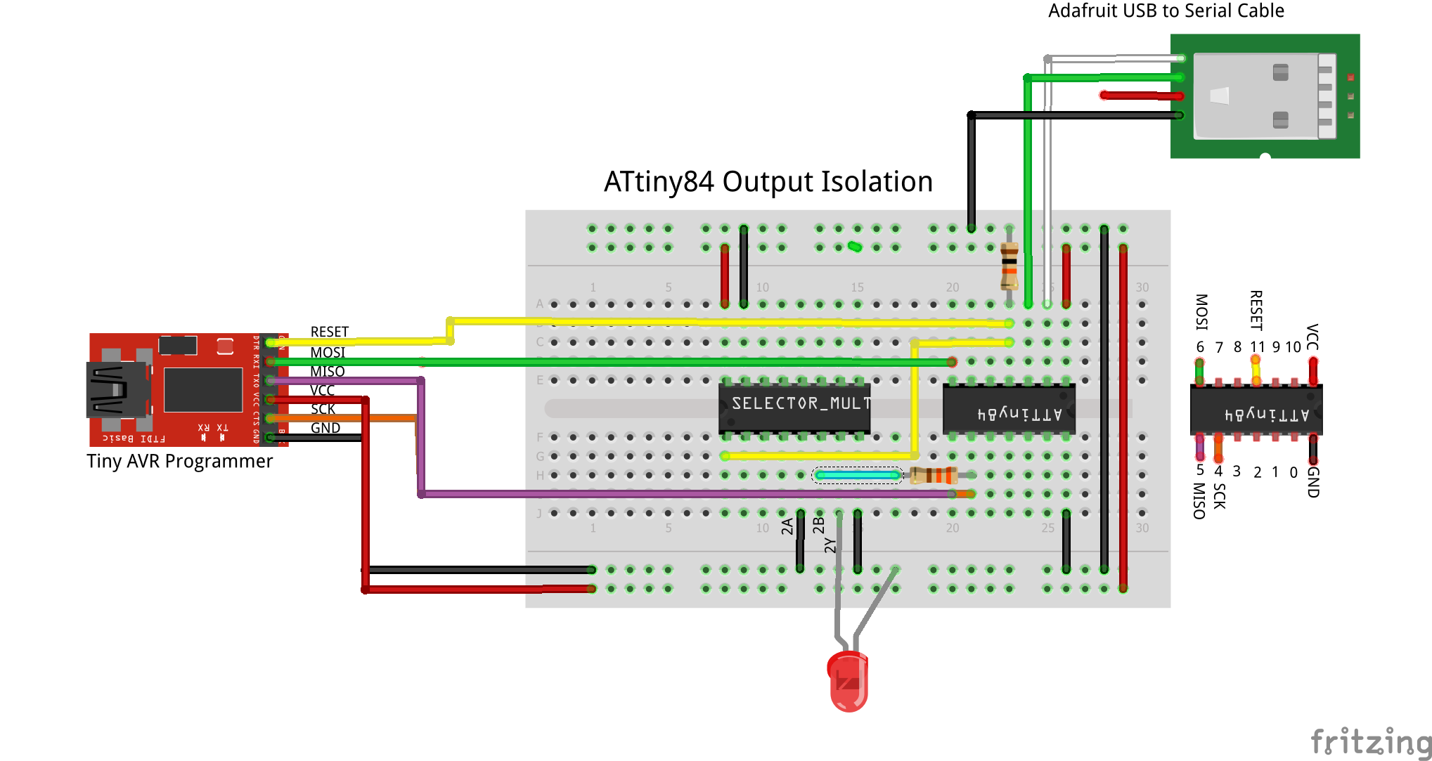

Step 3: ATtiny84 Case 1 - Isolate Application Output
This step describes setup for sharing of an application output pin with a download signal. The example used is the LED attached to pin 4 (SCK). Using the existing LED as the example allows emphasis on addition of the multiplexer to the part 1 hardware and software environment.
  • Hardware
    • Add the multiplexer to the breadboard in the relative location shown in the fritzing diagram above. The multiplexer is positioned towards the center to allow room for the SPST switch needed in Case 2.
    • Extend the RESET signal to the multiplexer by adding a lead wire (suggest yellow) from ATtiny84 pin 11 to multiplexer pin 1.
    • The remaining hardware setup is as given in Step 2
      • connect multiplexer pin 2A directly to ground
      • connect pin 2B to ATtiny84 pin 4
      • connect output 2Y to the LED anode
        • Expected Results:
          • during download 2Y is connected to ground (2A) so the LED remains off
          • After download 2Y is connected to ATtiny84 pin 4 - application LED control

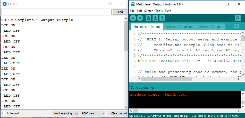

  • Software
    • The part 1 code is reused; available from the part 1 instructable rather than duplicated here
    • Load and compile the part 1 program in the Arduino IDE
    • Plug in the Tiny AVR programmer to a PC USB port
    • Plug in the Adafruit USB to Serial cable to a second USB port
      • A COM port is created and is automatically made available in the IDE port list
      • Launch the COM window
    • Download the compiled code to the ATtiny84
The application program results are the same as for part 1 since the only change was to move the LED to a "protected" location: The LED blinks at 2 second intervals; serial output is the same. The one difference that should occur is that the LED no longer flickers during download since, during that time, it is connected to ground through multiplexer pin 2A.

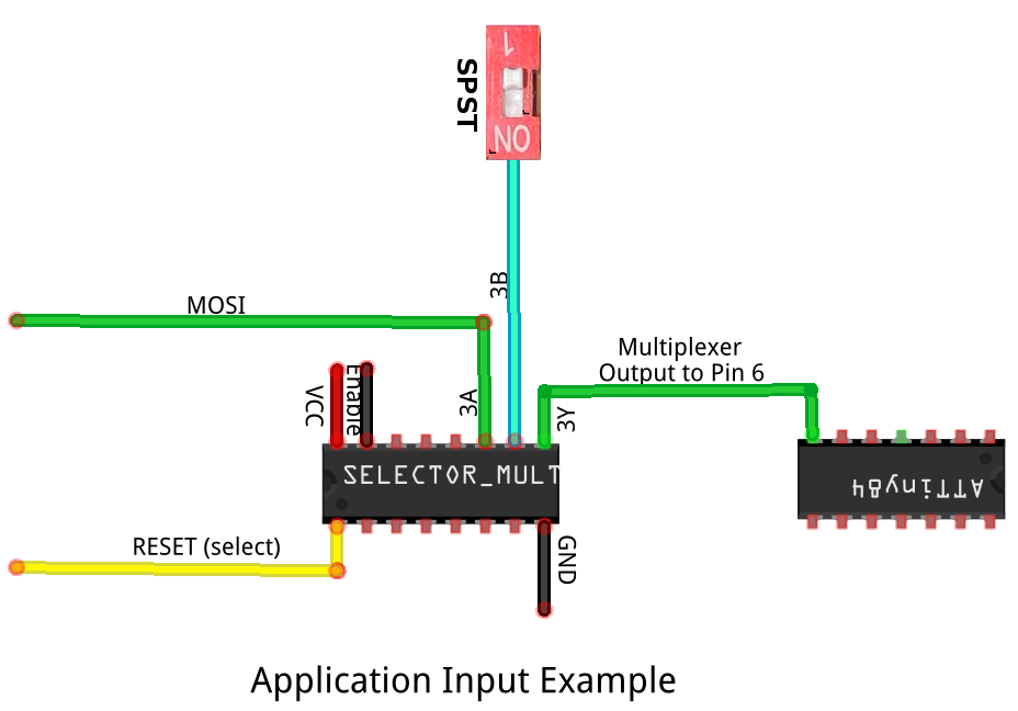

Step 4: ATtiny84 Case 2 - Isolate Application Input
This step builds on the setup for the previous output isolation case. Hardware changes consist of attaching a SPST switch to ATtiny84 pin 6 (MOSI) via the multiplexer. So the hardware changes are minimal but there are several software changes to allow the SPST switch to control the LED using a pin change interrupt. The updated code is included at the bottom of this section. The code should be copied into the Arduino IDE; suggest saving it under the name Multiplexer_Input. (I apologize for the length of this section but it is the heart of the instructable's purpose and think it reads better as a monolith rather than inserting artificial breaks.)

Configure the Hardware
The SPST switch is attached to ATtiny84 pin 6 (MOSI) as outlined in Step 2. The procedure is duplicated here for convenience.
  • connect switch input 3A to the Tiny AVR Programmer header MOSI lead
  • connect 3B to the SPST switch ON output pin
  • connect 3Y to ATtiny84 pin 6
    • RESULTS:
      • 3A, MOSI, will be gated through to ATtiny84 pin 6 during download
      • 3B, SPST output, will be gated to pin 6 after download

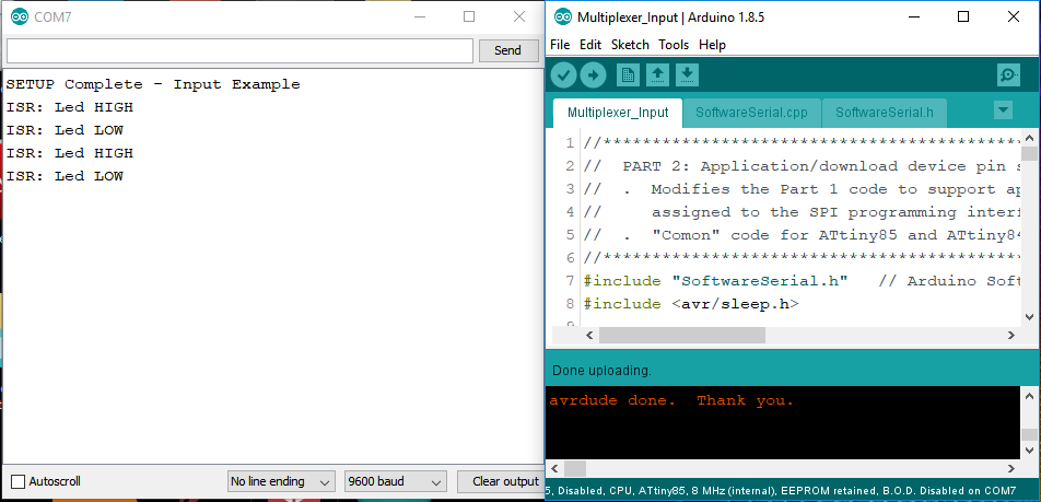

Run the program
Before running, put the SPST switch in the off position. Otherwise the LED will turn on when the switch is turned off and vice-versa . Follow the procedure for step 3 to load, compile, and download the application input program using the Arduino IDE. As before, the LED should not flicker during download so the only indication that the program is up and running will be the serial message at the end of the setup routine: SETUP Complete - Input Example
At this point the program is waiting for an input from the SPST switch. Placing the switch in the ON position will cause the LED to turn on; changing back to the off position turns the LED off. Output messages verify that the ISR was invoked (ISR: Led HIGH, ISR: Led LOW). Notice the order of the serial messages is GO TO SLEEP first waiting on a switch state change; when get a switch input the ISR is invoked, toggles the LED, and documents the change; then processing picks up following the sleep call since the interrupt wakes up the processor.

Use the same program as for ATtiny84 Step 4. The same general results are expected - the LED changes state when the SPST switch is turned on/off and serial output messages document the changes. The GO TO SLEEP messages are missing since sleep functionality is not invoked for the ATtiny85. Even though the same program is used, there are significant differences in implementation to account for the fact that the ATtiny85 has only one port register (Port 0):
  1. SoftwareSerial now allocates the port 0 pin change interrupt for serial communication (Recall that we were able to use port 1 for the ATtiny84.)
