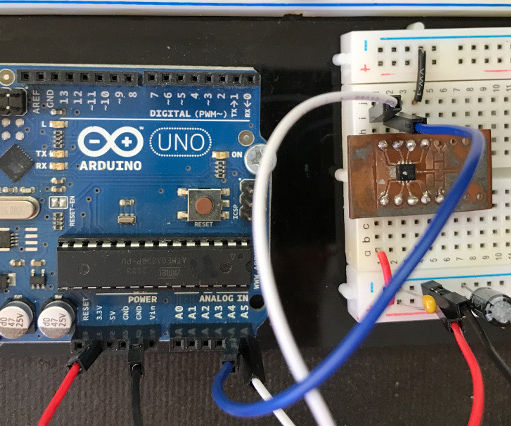

Step 1: Problems With Counting
When you use an ATtiny84 or ATtiny85, you are most likely using a breadboard or circuit of your own design. Unlike an Arduino Uno, that has the pins at the headers numbered to match the pin numbers in the Arduino IDE, you will have to wire your ‘tiny to the actual physical pins.
The physical pins and the pin numbers in the software are very different. For example, on an ATtiny84, physical pin 1 is for Vcc while, in the software, digital pin 1 is actually physical pin 12. You have to understand from context which pin (physical or software) is being talked about (hint, most references are for the software pin). It is best to refer to a diagram as you go through the explanation.
To add more confusion, the analog pins can have different numbers than the digital pins at the same physical location. This is happens with the ATtiny85. For example, the physical pin 7 is both the digital pin 2 and the analog pin 1. Digital pin 1 is the physical pin 6, and it has no analog input. (I only hope that the chip designers saved the company a lot of money for the confusion this can cause.)
This situation is due to the chip designers and not caused by the Arduino software. The pin numbers are based on how port B and the ADC is mapped. Pin 7 is PB2 (digital pin 2) and ADC1 (analog pin 1).

Step 6: Electrical Issues
Wiring is like you would expect. Power from the Arduino/USB device goes to power on the ‘tiny (pin 1 for ’84, and pin 8 for ’85). The same type of connection applies for ground (pin 14 for ’84, and pin 4 for ’85). The pin you assigned to Rx (pin 3 in sample code) goes to the Rx line on the Arduino, pin 0/Rx. Do the same to the pin you assigned to Tx (pin 4 in sample code) goes to the Tx line on the Arduino, pin 1/Tx.
I have read about adding resistors in series with the serial connection. I don’t think this is needed. FTDI does not list using resistors to hook up their FT232RL USB/serial chip. From the ‘tiny to the USB/serial device, it should all be TTL. You can add 200 – 2K ohm resistors if you want to be extra careful.
If someone knows a good reason for this, please post it.
I have also seen the addition of a capacitor across the reset and ground on the Uno board. I am not sure what this is supposed to do. It may keep the ATmega328P on the Uno board reset so that the serial lines are not being used by the Uno. I would think a jumper may work.
If you are using an Arduino Uno to bridge the serial communication with your computer, it needs to be loaded with a sketch that won’t interfere. If you get weird characters on your serial monitor, then that shows corruption of the signal. You need to isolate the serial line to only the ‘tiny. If you are using a Reactor Core programmer, then disconnect the serial jumpers. That will isolate the serial from the on board ATmega.
