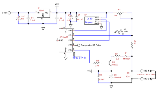

Step 1: Schematic
U1, C1 and C3 form the input to the voltage regulator that provides a stable 5V from a 9 - 15V input. C2 and C4 provide DC filtering for the +5V line and C7 and C8 are high frequency bypass capacitors. When an inductor under test is connected, R1 and R2 form a voltage divider. For initial calibration, R1 is adjusted to 1volt measured at PB1 which is connected to the inverting input of the internal comparator and this is just below the 1.1volt internal reference applied to the non-inverting input of the comparator. A 45us pulse from U2 PB4 is applied to the base of Q1 through R4. Q1 provides a current pulse of several hunderd milliamps from C6 through R3 and D1 to the resonant tank circuit C5 and the inductor under test. Diode D1 prevents the sinewave voltage accross the resonant tank circuit from feeding back to the source when the drive pulse signal is at 0volts. The sinewave generated from the resonant tank circuit is fed to PB1 through R2 and swings above and below 1volt.
Step 2: Breadboard
With an inductor connected apply power and adjust R1 to 1.0volts at PB1 input of the ATtiny85. Note: While the volt meter is connected the inductance and frequency values on the OLED display will be unstabe due to the noise introduced by the volt meter. Don't forget to disconnect it.

Ok, so now we know that we need to pulse the unknown Inductor connected in parallel with a known capacitor which will result in a resonant frequency that we can measure in order to calculate our inductance value.
Refer to the the block diagram shown above and the following pseudo code explanation to see how we go about implementing the inductance meter. Lets start with Timer0. The ATtiny85 is running at 16MHz internal clock and the prescaler is set to divide by 8. Timer0 is setup to free run in CTC mode and counts to the value of the OCRA register. In our case the value is set to 100. Therefore, the frequency of Timer0 = 16Mhz / 8 / 100 = 20kHz. An Interrupt Service Routine(ISR) is triggered when the counter reaches the OCRA value of 100. Since the period of 20kHz = 1 / 20,000 the ISR is triggered every 50us. There is a software counter called TIMR_50us_cntr and it gets incremented during each Timer0 ISR and the TCNT0 register is being incremented every 0.5us [1 / (16MHz / 8)]. Both the TIMR_50us_cntr and the TNCT0 counter register form the basis of our frequncy counter as will be shown later.
Next, lets talk about the comparator. A comparator consists of one positive(+) input terminal , one negative(-) input terminal and one output terminal. It does exactly what its name suggests as it compares two input voltages. If the +input is higher in voltage than the -input the output will be HIGH. Conversley, if the -input is higher in voltage than the +input the output will be LOW. One key feature of a comparator is it's very high gain meaning a very small difference between voltages at the +/- inputs (say a few milli-volts) will cause the output to swing HIGH or LOW. Use following link to learn more about comparators and how to use them.
Op amp comparator tutorial and clapper circuit - Afrotechmods
As shown in the block diagram the ATtiny85 internal comparator will have its +input connected to an internal 1.1 volt reference. The -input is connected to port PB1. The resonant circuit output sinewave voltage is fed to PB1 and is biased around 1 volt. This means that the resonant sinewave will swing above and below adding or subtracting from the 1 volt bias point. When the AC sinewave is at 0volts, 1 volt is applied to the -input and since the +input is at 1.1 volts the output of the comparator will be HIGH. The Comparator is configured to execute an ISR on the falling edge of the comparator's output. As soon as the resonant sinewave goes positive greater than 1.1 volts, the - input is now greater than the +1.1 volts at the +input so the output of the comparator will go LOW. This will trigger the comparator ISR and at this instant the trigger_cnt = 0 and will be incremented to 1 on the next ISR. In addition both the TIMR_50us_cntr and the TNCT0 counter are set to zero as this is the beginning of our sinewave period to be measured. In addition, PB3 is a monitor output which is now set HIGH. As the sinewave continues and falls below 1.1volts half way through its cycle, the comparator output will go HIGH. When the sinewave completes one full cycle it again goes positive greater than 1.1 volts so the output of the comparator will go LOW. This will trigger the comparator ISR again and at this instant the trigger_cnt = 1 and both the TIMR_50us_cntr and the TNCT0 counter values will be stored in variables counter_1 and counter_2 respectively and the PB3 monitor output is set LOW. Now that we have our counter_1 and counter_2 values lets see how to go about calculating the frequency of our resonant sinewave period.

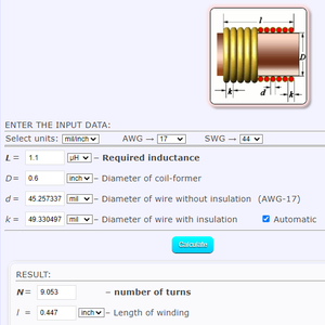

First you will need to create an accurate inductor close to 1.0uH. This can be easily accomplished by winding an air core inductor of just a few turns using the Coil32 calculator.
One-layer inductance coil calculator - Coil32
In the Coil32 example image above, I set the units to mil/inch usedAWG#17 wire (It's stiff and I had some laying around) If you have wire and are not sure of the guage you can measure the diameter with a calipers and then uncheck the Automatic tic box in the Coil32 calculator and manually put in the wire diameter size. Keeping L as close to 1.0uH as possible play around with the coil former diameter and your wire size in order to get an even number of turns. In my example 9Turns on a 0.6" diameter gives an inductance of 1.1uH. The coil length is not that critical just get it close.
In terms of accuracy, the higher the inductance value the the more accurate the reading. Since the variable count_us is an integer value the resonant sinewave period measurement has a resolution of +/-1us. Doing the math which I woun't go into here, the following measurement tolerances apply:

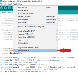

Step 8: Programming the ATtiny85
For this project the ATtiny85 needs to run at an internal clock speed of 16MHz. Since the default factory setting is 1MHz before loading the program you will need to set the Arduino to Internal 16MHz and "Burn Bootloader" when complete go ahead and upload the code normally.
For those of you who are not familiar with how to program an ATtiny you can acomplish it with either an Arduino Uno or an Arduino Nano. There is an Instructable on the topic which I havn't tried but looks to be good. The one I used was the "How to Program an ATtiny with Arduino Nano- YouTube" by Tanner Tech.
How to Program an ATtiny with Arduino Nano - YouTube
How to Program an Attiny85 From an Arduino Uno : 7 Steps
