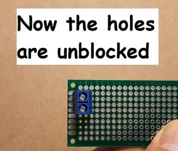

I have included a Fritzing diagram of the wiring. When planning your board, layout the components on the perfboard to get a sense of where everything should go. Then remove them and start soldering, starting with the pieces with the lowest profile, like the resistor. That way components are less likely to fall out while you are soldering larger and larger components.
On the right side of my device are the connections for the supply voltage, which for me will usually be the rechargeable 9V battery. Whatever voltage source I use, it has to be at least 6.5 volts for the AMS 1117- 5.0V voltage regulator. There are options for connecting the voltage supply with the screw terminal or male & female jumper wires. I bent the wires of the screw terminal to save space on the perfboard. If you do this, you have to force the pins of the screw terminal into the perfboard on an angle, but it gives saves a little space on the board. Below to the connectors, there is an on/off pushbutton switch, and an LED indicator with its 1 kOhm current-limiting resistor. The value of the resistor must be at least 220 Ohms or so to protect the Led, but since this LED is being used as an on/off indicator, and not for illumination, up to several thousand Ohms can be used to dim the LED.
The AMS 1117-5.0V voltage regulator is necessary because the device needs a stable supply voltage for accuracy. When using this voltage regulator, it needs a capacitor on the input pin and one on the output. The datasheet for the AMS 1117 recommends 22uF tantalum capacitors but I used 22uF electrolytic capacitors. Both capacitors have the cathode (don’t mix up anode and cathode) connected to the voltage regulator’s ground pin. The AMS 1117 is meant to be a surface mount device rather than a through hole component (all the other components in the project are through hole). However, it is easy enough to solder the voltage regulator to a standard perfboard lining up the three pins to three holes, then apply enough solder on the underside to flow through the holes and electrically connect the pins of the AMS 1117 to the capacitors and wiring. The AMS 1117 work quite well for what I use them for and I like that they are low drop out voltage regulators, and have thermal protection, etc. By the way, if you look on the Arduino, they use these voltage regulators too.
For the OLED display, I cut a row of female header pins down to a 4-pin piece to use as a socket. That way I can disconnect the OLED if I need it for another project, or I drop the device and crack the display by accident :)
Be aware, that not all OLED displays have the pins in the same order, so please check yours before soldering the wires. Mine is (from left to right) SDA, SCL, VCC then finally GND. The SDA pin connects to physical pin 5 of the ATtiny85, and SCL to pin 7.
Under the OLED I have a slide switch and a jumper connector which connects two 90-degree male pins. If you do not have the 90-degree pins, you can use regular male header pins but it will have to put them on a different part of the board so you can connect an external voltage source to it later. The pin on the left is connected to the AMS1117, and the pin on the right is connected to the VCC (physical pin 8) of the ATtiny85. So, removing the jumper connector, you can supply a regulated 3.3 volts to the ATtiny85. Sliding the switch connects pin 6 of the ATtiny85 to ground, giving it a LOW signal. In the programming, when this pin (which is digital pin 1 in the Arduino IDE software) reads a LOW, the ATtiny85 is programmed to calculate the current using a formula for this lower voltage rather than 5 volts. This switch, therefore, allows for a quick shift from 5volts to 3.3 volts, and vice versa without having to re-program the microcontroller each time.
The right side of the board is the testing side. There is the large white 1uF capacitor, the ATtiny85, a black pushbutton, and various connection options. The capacitor is what is measured for our calculations. The pushbutton is a reset, and when activated, connects the reset pin (physical pin 1) of the ATtiny85 to the zero volts ground. This is how you re-start the program and therefore re-start the measurement. There are two red male header pins and a red jumper wire all connected, plus two black male header pins and a brown jumper wire. These are the positive (red) and negative (black/brown) connections for the circuit you want to test. The red connectors are also connected to one end of the capacitor and pin 2 of the ATtiny85. It is this pin 2 that charges up the capacitor, then changes to an input and measures the voltage on the capacitor.
I put a small 100 nF capacitor near the VCC pin of the ATtiny85 which connects to the VCC pin and to ground. I found the device worked without it, but since it was in the original design, I included it. It is meant to help smooth out any small changes to the voltage supply to the ATtiny85.
Lastly, there are two male header pins between the ATtiny85 and the large white capacitor. One of these is connected to pin 1 of the ATtiny85, which is the reset pin, and the other male header is connected to pin3. The reset header pin will function just like the reset button. In other words, if you connect to this, and give it a LOW signal of zero volts, the ATtiny85 will reset and start the program again. This allows for an external device, like an Arduino, to trigger another measurement without someone having to press the button.
The other header pin, connected to pin 3, is used as a transmit pin. This transmits the raw nanocurrent data as serial data. Together with the reset pin, these two pins should allow the added functionality of an external data logger to record current measurements over time. The data logger can trigger a reset of the device with a LOW signal to start a new measurement, and then record the serial data from pin 3. It would have to be at least a couple of minutes between measurements as the nanocurrent meter can take over a minute and a half at the lower end of its measurement range as it waits for the 1uF capacitor to discharge.
