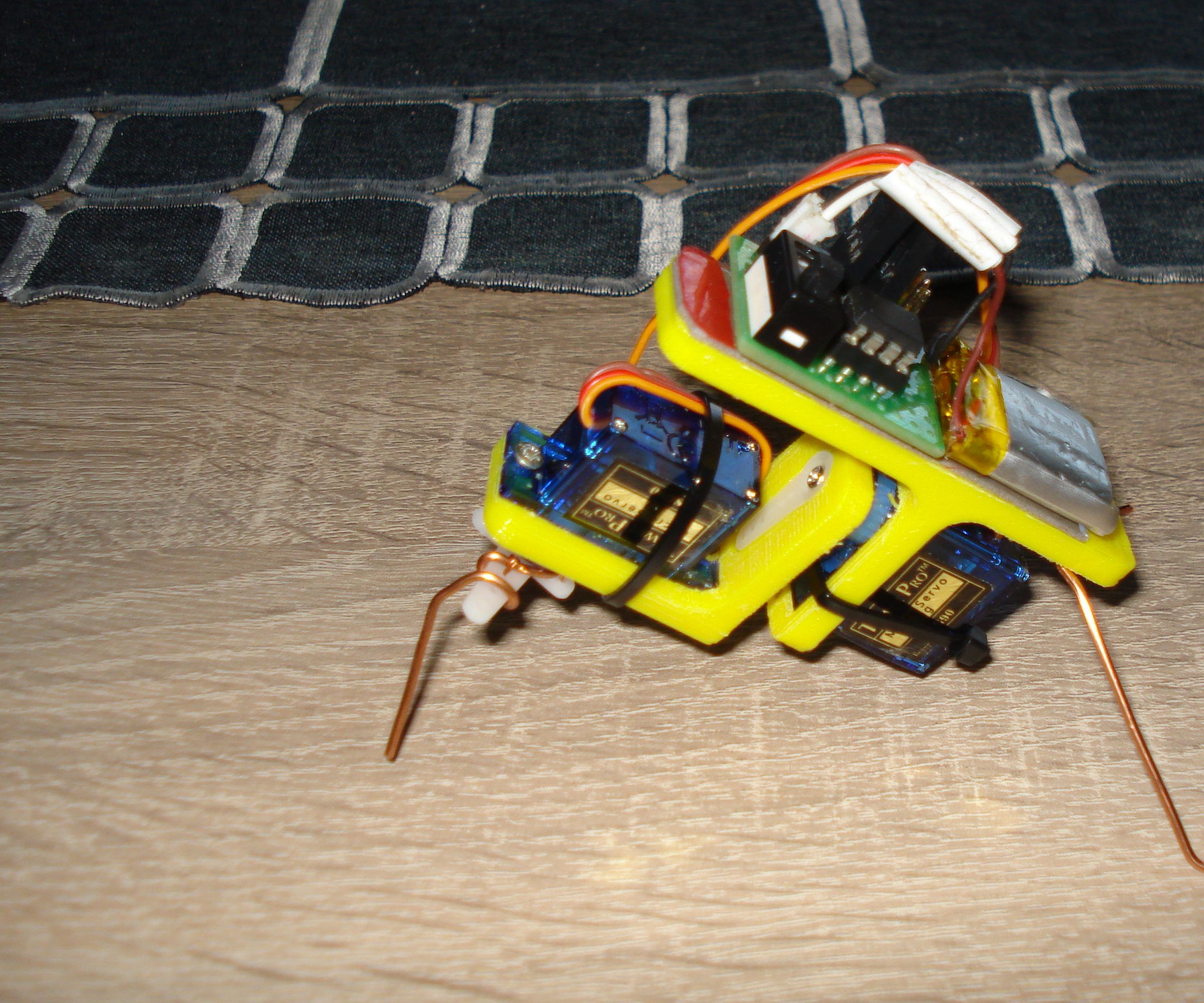

First I made two prints like the picture
You look from above through the board, if you understand me
The smallest PCB is for Robotic Insect, I do not think there needs explanation
The larger PCB is for programmed via an Arduino Uno, the ATtiny85 The structure I think is easy to understand
The LED that is re-signed, is red and indicates that something is wrong if this fire
For programming I do the following
1 I load in the Arduino Uno the "ArduinoISP" program, which is already in the Arduino Uno see foto1
2 Unplug the USB cable from the Arduino Uno
3 Place the PCB with the 3 LEDs on top of the Arduino Uno, see that there's is an ATtiny85 in the right direction in the PCB
4 Then connect the USB cable back to the Arduino Uno
5 Set my settings to program the ATtiny85 see foto2
6 Take the program "ATtiny85_Robot_Horse.ino"and load it ........
7 Removed the USB cable from the Arduino Uno
8 Take the ATtiny85 from board and place it in the small PCB Robot Insect
9 Turn on the switch of the Robot Insect and then if all is well the Insect start walking
Between ( ) I am not responsible for any misunderstandings or mistake
Sorry if things go wrong

Step 4: Assembly
Step 5: Modifications
1 First and foremost, run better and run faster
2 Left turn, right turn and walk back
3 Programming the IR sensor as obstacle avoider or follower

This is my first test with the robot insects
You can see that the IR sensor is not connected yet, because I still have not found a decent program The walk I find myself a little stiff, maybe with other legs or to change what times in the program would have been better than now ???????
These settings are like on my video
