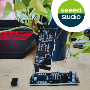

I am a big fan of these microcontrollers, but i was fed up with the wiring i have to do every single time when i had to program them, so initially, I built this programmer on a perfboard,but I later upgraded it to a professional PCB design with improved functionality. This shield eliminates the need for a tangle of wires and ensures reliable programming every time. Whether you’re working on mini projects or low-power applications, this tool will make your development process much easier.

Step 4: Design and Features
One interesting design quirk: I initially made an error where the components were placed upside down when plugged into the Arduino Uno. Surprisingly, this turned out to be a good thing—it prevents accidental damage to the Arduino GPIO pins. However, there is a minor fitting issue when programming two ATtiny chips at the same time. Despite this, the shield functions without any major problems.
Step 5: Key Features of the ATtiny Programmer Shield:
- Dual Programming – Program two ATtiny chips simultaneously, saving time when flashing multiple chips.
- SMD Support – Space included for programming surface-mount ATtiny versions
- Onboard LED – Connected to GPIO4 for quick testing without external components.
- Breakout Pins – Useful for prototyping and debugging.
- Compact Plug-and-Play Design – No need for jumper wires—just mount and program.
