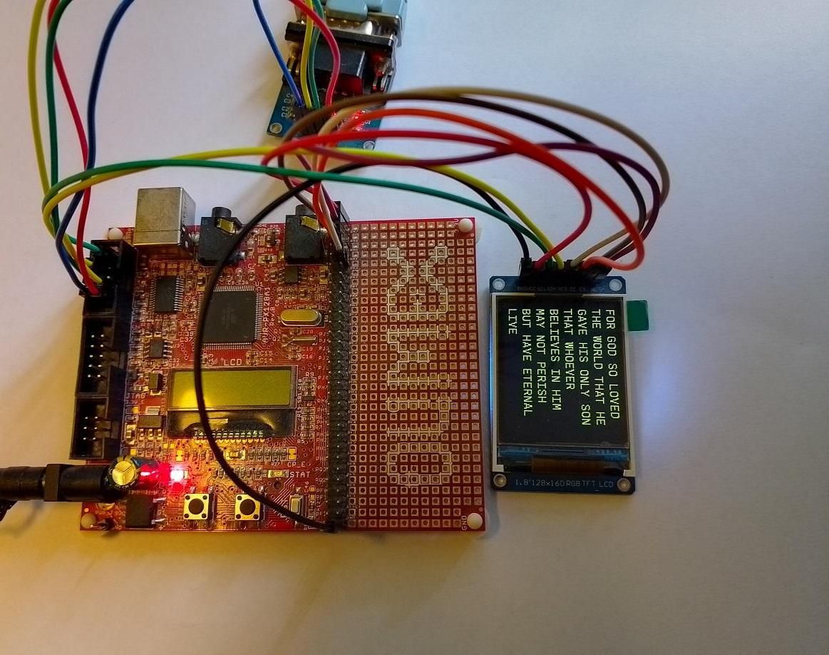

The main goal of the project is to show how to draw text,shapes and images on TFT display ST7789 using Web Serial API and Acorn micro-kernel operating system.
Web OLED browser editor app was develop to run online (no need to install any programm localy on desktop) and communicate pixel changes over web serial api directly to an AVR processor running acorn micro kernel. The processor sends changes over SPI protocol to OLED display and pixel changes are displayed instantly on screen.
No microcontroller internal memory buffering is used , internal SRAM is too small to allow 320x240x2 color per pixel=153 600 bytes, as a result serial to UART stream is directly send to TFT display using the produce consumer pattern.

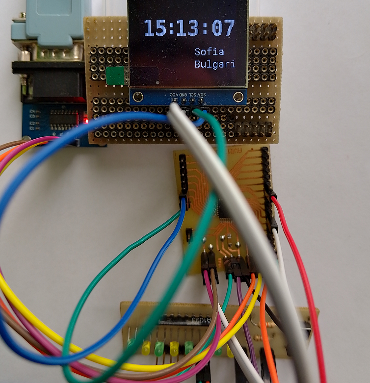

ATXMEGA128A1 microprocessor controls 3 input-output channels - UART to PC, SPI to ST7789 and native protocol to GDSC-0801WP display
There are 3 tasks to control each channel
  1. tft_lcd_task - controls SPI protocol and consumes byte stream from UART task
  2. usart_D_task - controls UART communication and produces a byte stream to be consumed by #1 task
  3. lcd_task - controls GDSC-0801WP communication protocol and renders animated text on lcd screen
