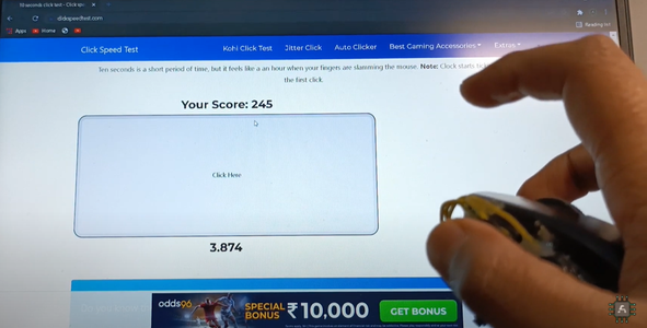

Many, many, many Minecraft gamers striving to click the fastest because fast clicking is directly proportional to the wins in PvP, so I made this simple project which uses a raspberry pi pico as it's brain and Adafruit Circuitpython's usb_hid library to accomplish the task.
This project will allow you to click with a lightning speed of 68 Clicks Per Second and can be used for games that require fast clicking. (I made this just for fun and please don't use this to cheat in game).
This uses a raspberry pi pico, two tactile buttons which when pressed, commands the raspberry pi pico to send signal to the computer to click after a delay of 0.01 s.

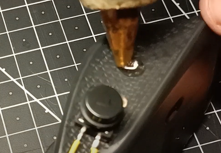

A mouse to stick the buttons on
Step 1: Solder Wires to the Tactile Buttons
Step 2: Solder Wires to Raspberry Pi Pico
Connect the left click button to GPIO18, right click button to GPIO19.
Connect another end of the switches to 3.3v (common).

First import all the necessary libraries, then create an object "mouse", then define the pins for both the buttons, after which there is a while loop in which while any button will be pressed, the board will command the computer to click for that button after a delay of 0.01s.

Step 4: Stick the Buttons to Your Mouse
Now when the buttons are placed on the side of the mouse, the will act as additional side buttons.
