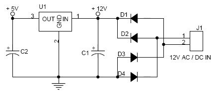

For power supply to circuit we use bridge rectifier in which we use transformer, 4 diode and regulator IC’s LM7805

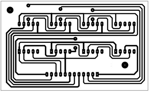

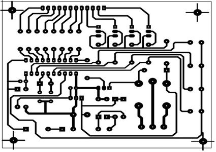

A circuit diagram of the clock timer,P1.0-P1.7 drives 7-segment common anode LED display with sink current.
P3.0-P3.3 also drives a base pin of 4-PNP transistor, BC557 with sink current.
As shown in the figure, the 2nd 2-digit LED that connected to P3.2 and P3.3 is rotated 180 degrees to the 1st 2-digit allowing the pt. segment to be used for 1 second blinking.
P3.0-P3.3 also connects four momentary switches while the other legs are tied to input port P3.4.
During display and key switch scanning, a logic '0' is shifted from P3.0 to P3.3,
If there was a key pressed,
P3.4 then became low.

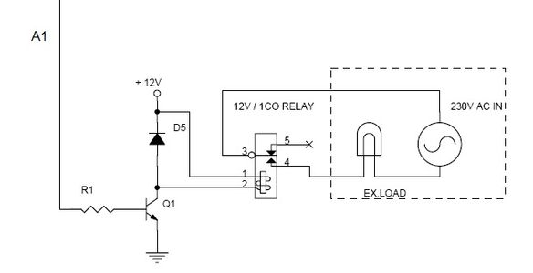

P3.7 is a 1-bit sink current driving;
A BC547 to drive a small electromechanical 12V.
