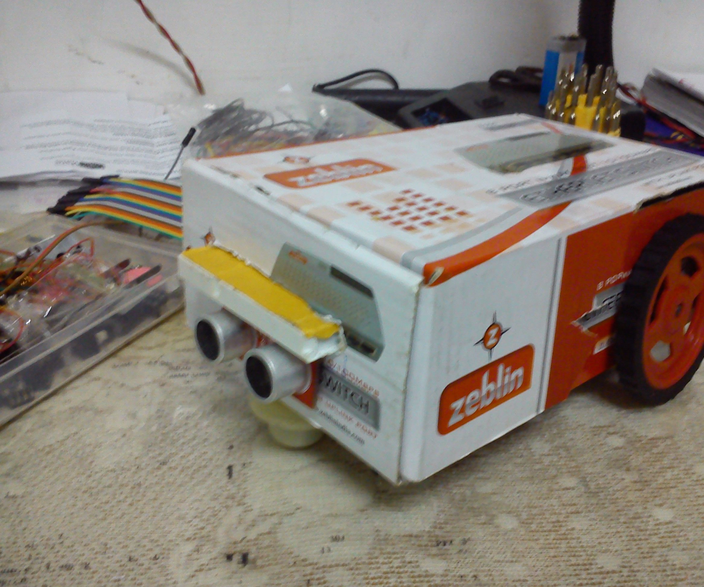

In this project I have used simple geared DC motors instead of servos because servos are costly, hence I have used L293D motor driver to control the DC motors, which is cheaper than buying servos.
Autonomy in ELECTRONICS is just a beginning of a new era where we can put our remotes aside and let the machine to do certain work by itself.
Step 1: PARTS REQUIRED:-
1. 2 DC MOTORS
2. L293D MOTOR DRIVER
3. 2 SMALL BREADBOARDS
4. ARDUINO UNO
5. JUMPER WIRES
6. PING ULTRASONIC SENSOR
7. 2 WHEELS
8. A FLAT BASE TO SETTLE EVERYTHING ON IT
9. 2 9VOLT BATTERIES AND A VOTLAGE REGULATOR IC

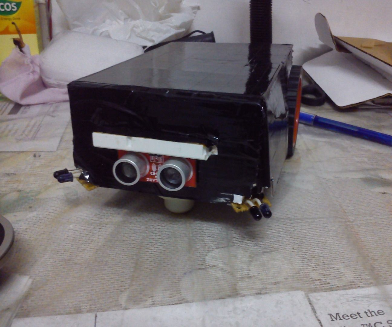

Step 3: SENSOR:-
Ultrasonic sensor provides an easy method of distance measurement. This sensor is perfect for any number of applications that require you to perform measurements between moving or stationary objects.
Interfacing to a micro controller is a snap. A single I/O pin is used to trigger an ultrasonic burst (well above human hearing) and then "listen" for the echo return pulse. The sensor measures the time required for the echo return, and returns this value to the micro controller as a variable-width pulse via the same I/O pin.
Step 4: CIRCUIT:-
USE YOUR OWN IMAGINATION TO DESIGN THE CIRCUIT. HERE ARE SOME BASIC POINTS FOR THE FRESHERS:
1. CREATE A POSITIVE AND NEGETIVE SUPPLY POINT ON BREAD BOARD FOR ALL VCC AND GND PINS.
2. USE BREAD BOARD INSTEAD OF PCB. BREADBOARDS ARE BEST FOR PROTOTYPING.
