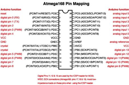

The pinout cross reference for the ATmega168 (same pinout at the ATmega328) is essential to knowing how to reference the ATmega328 pins inside the Arduino IDE.
https://www.arduino.cc/en/Hacking/PinMapping168
https://www.arduino.cc/reference/en/
Step 3: Programming and Testing
ATmega328 pinout reference for the code.
SPI pins used for the Micro SD Card Reader:
Arduino Atmega Atmega SPI
ref port physical
13 PB5 19 SCK (clock)
12 PB4 18 MISO
11 PB3 17 MOSI
10 PB2 16 SS/CS (master)
TMRpcm audio output:
ref port physical
9 PB1 15
PIR interrupt pin:
Arduino Atmega Atmega Atmega
ref port pcint physical
4 PD4 PCINT20 6
Motor pin (high/on while audio is playing):
3 PD3 PCINT19 5
LED indicators:
ref port physical
0 PD0 2 led0
1 PD1 3 led1
2 PD2 4 led2
16 MHz Ceramic Resonator:
Atmega Atmega
port physical
PB6 9
PB7 10
Random noise ADC:
ref port physical
A0 PC0 23

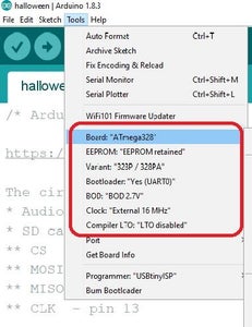

I'm running the Arduino IDE on Windows 10. I also have cygwin install, giving linux tools for moving around the filesystem. 'find' and 'diff' are two of the most handy for a project like this. Always save an original copy of any third party library file that you modify. It beats having to reinstall the entire library if you loose your way. A diff of the new vs the original will show you if you did anything that you didn't intend to.
The ATmega328 board configuration used in the Arduino IDE is shown in the screen shot above. To upload a program through the SparkFun AVR Programmer to an ATmega328 through the SPI interface, you have to use the 'Upload Using Programmer' selection in the Sketch pulldown (screen shot also shown above). Just clicking the upload arrow from the screen doesn't work for the ATmega328.
I configured the chip to use a 16MHz external resonator. The 8MHz internal was too slow for good sound. I gave a short try to a 20MHz external resonator, but got nothing out. Didn't try to figure out why.
Besides standard (preinstalled) Arduino libraries, TMRpcm needed to be installed. It's already in the library list included with the Arduino install. Pull down from Sketch -> Include Libraries -> Manage Libraries and then search for it and install from there.

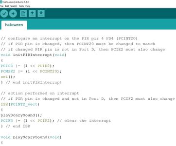

One other specialized technique is using random noise from one of the ADC pins to set the seed for the random number generator. If your sequence of 'random' audio always starts from the same file, you didn't get this right.The rest of the details involved getting PIR pin interrupt and 'deep' sleep working. This is this is the part of the coding that I found most interesting and challenging. The ATmega328 has three dedicated pin interrupts, one for each of the 'port' banks` (PB, PC and PD on the ATmega328). Using Mr. Elliot's book and the datasheet I was able to sort out what pin identifiers I needed to use to configure an interrupt for the pin that I wanted to attach the PIR to. Just to note, the PIR is default LOW (good). So a HIGH on the pin triggers the interrupt. One other note, stand alone testing with the PIR showed that it remained HIGH initially for about eight seconds when power is first applied. A ten second delay was added to startup to keep the interrupt from triggering until after the PIR had stabilized.
It took several iterations of development to get the microprocessor to go into SLEEP_MODE_PWR_DOWN while waiting for an interrupt. My original code simply polled over the PIR pin in a loop with a small delay between each check, but I wanted to do better. I tried a couple of different add on sleep libraries, but neither of them worked well for me. I finally found that using just the simple built-in avr/sleep library it only took a few lines of code to accomplish what I needed.
Three led indicators are used, they are turned off after the first PIR interrupt is triggered to save power. led0: basic start/power on. led1: indicates once initialization delay is over (and interrupt is set to fire). led2: Micro SD card reader initialization has failed, the program exits.

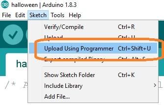

During programming I was careful to unplug the SD card reader while the code was being uploaded through the SparkFun AVR programmer SPI interface. And likewise when testing the application I plugged the Micro SD card reader back in and disconnected the programmer from the USB port on the PC. The dual SPI port usage will step on the other process otherwise. The particular Mirco SD card reader used is very forgiving. I'd be embarrassed to say how many times I plugged it in backwards. In those cases led2 let me know right away that I had goofed.

// configure an interrupt on the PIR pir 4 PD4 (PCINT20)
// if PIR pin is changed, then PCINT20 must be changed to match
// if changed PIR pin is not in Port D, then PCIE2 must also change
void initPIRInterrupt(void)
PCICR |= (1 << PCIE2);
PCMSK2 |= (1 << PCINT20);
sei();
} // end initPIRInterrupt
// action performed on interrupt
// if PIR pin is changed and not in Port D, then PCIF2 must also change
ISR(PCINT2_vect)
if (digitalRead(pirPin)==HIGH && intPlaying==0)
intPlaying=1;
playScarySound();
} // end if
PCIFR |= (1 << PCIF2); // clear the interrupt
} // end ISR

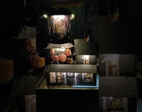

Step 10: Demo
Attached is a video showing the stepper motor motion with the lights on (no sound).
And a video with the lights off, with motion and sound. The video without lights was pretty hard to capture.
Each audio sequence is triggered by the PIR (motion) sensor attached to the Atmega328.
The skull has a nice glow after an audio sequence.
My wife says it is too scary though.
Thanks for checking it out.
